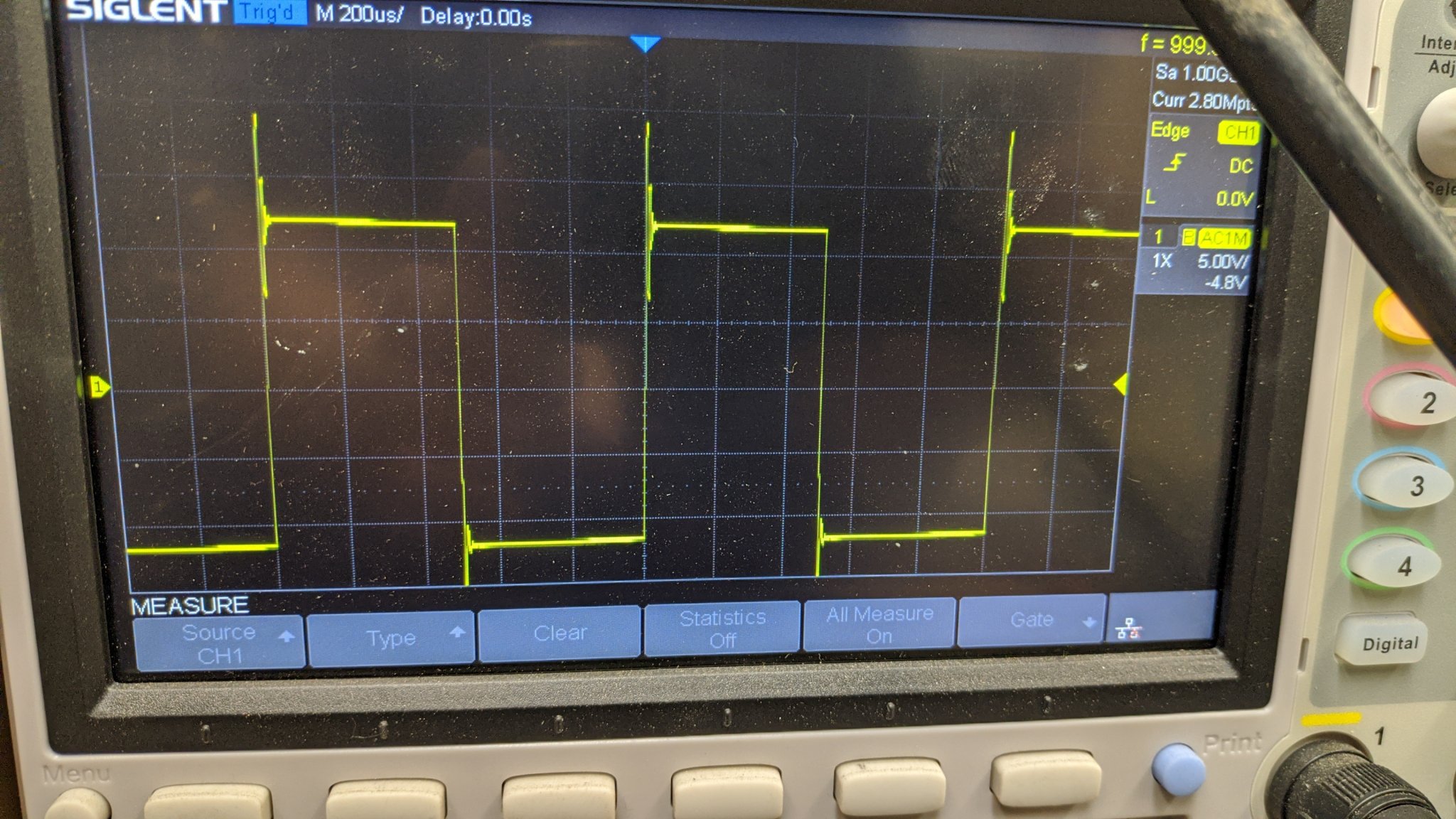

Well, some progress has been made, and I'm happy to say that the Aleph J is up and running. I had to increase the heatsinking on the msr860 diodes a bit, they were getting a bit toasty for my liking with the original heatsinks, but with the larger plates they are staying at a reasonable temperature. All voltages measure just fine which is just great. The amp is built on Peter Daniels boards, matched 240s, J109 fet, 24v rails (loaded) with 66kuF per rail (ie 132kuF in total).
I have one question - when I put a square wave through the amp, I get some ringing - in this amp C5 is currently unpopulated, and I think I remember reading that C5 has an influence on the ringing behaviour. Can anyone give direction on this - no matter how I searched I couldn't find where I picked that up. Also 5pF is truly tiny. Would a couple of twists of wire do the job? I don't think I can even measure that low down.

Anyway, it drastically improves the ringing. I also found a 22pF in the parts stash but it was too much - the front end of the wave was rounded off. I'll order up some of the recommended silver mica whenever I am ordering anything from the supply houses again. Maybe I'll order 5 and 7.5pF and see which is best.

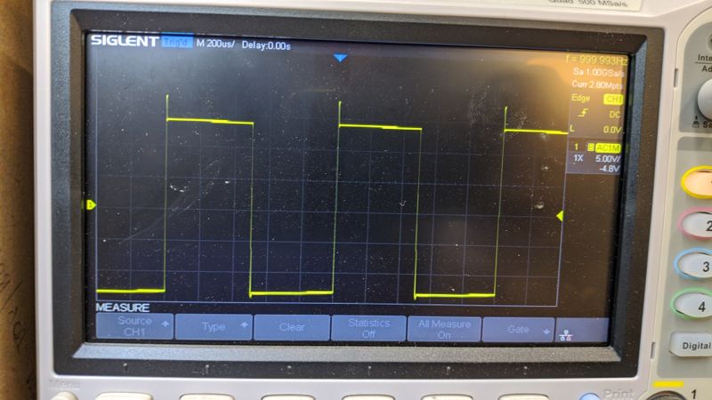

As per the post above I put in a crappy 5pF ceramic disc cap - the only thing I had that low down. It tamed a lot of the ringing as per the scope shot above. In my next order I added some 5pF and 7pF silver mica. I tried both this evening and 7pF seems to be the sweet spot - the tiny bit of ringing in the scope shot above is gone, but with minimal rolling off at the corner of the square wave.
However, the real surprise here is the change in sound quality. It really has made a much larger difference than I could have imagined. Whether its the 7pF and a cleaner square wave, or using silver mica instead of bottom of the pile ceramic disc (the really low end orange disc ones) I won't ever know.
In short, its worth picking up a couple of values of these caps and looking for the best square wave shape if you have a scope and generator.
You could try 2 polystyrene 10pF caps in series. Or, do what Nelson suggested: make a 20cm long twisted pair and then keep trimming until you get a nice looking oscilloscope square wave. This should provide the best sound, but the twisted pair capacitor will need to be heat shrinked, to prevent loss of capacitance....
I'd place silvered mica and disk ceramic caps in the same basket sound quality-wise. Polystyrenes sound much better, but they don't come in 5pF flavour anymore...
Ok I might keep an eye out for some low value polystyrenes. I did go looking recently in some of the scrap boards I have knocking around, but the polystyrenes were all much higher values in the 50pf range and there were only a few anyway.
So as I said, I don't know if the improvement is due to silver mica or getting the right value for a really clean square wave but it's one of those two things I think.

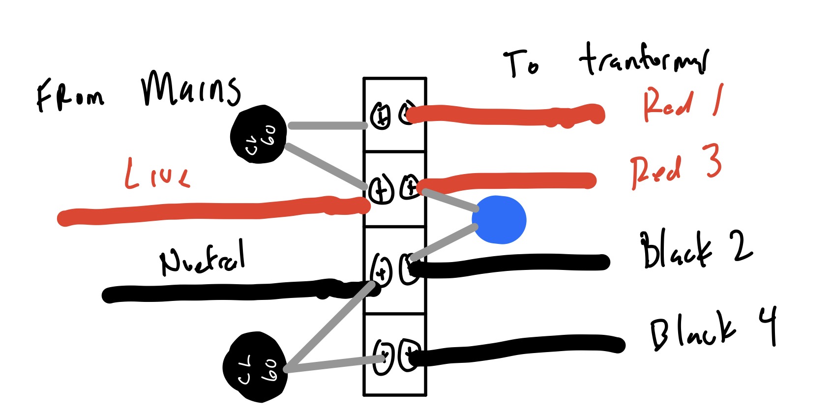

Do any of you guys have an illustration (or actual picture) of the wiring diagram from the IEC inlet towards the terminal block where the primaries are wired to (the one with the inrush limiters and safety capacitors) for 240V?
Yes there's is a detailed schematic provided in the Aleph J build, but unfortunately, a newbie like me can't really read or understand the schematics well enough to make sure that I understand it correctly.
Sample illustration below (also posted in one of the pages here), but this is 120V. What I need is for 240V wiring.

Please post exact manufacturer and part number for your power transformer. A picture is also useful. A link to the specifications of the transformer would be most useful.
Jim was kindly to already assist me on this regard. Hopefully, once I get to finish my project, I will post pictures here for our community that uses 240V mains. Thanks!
