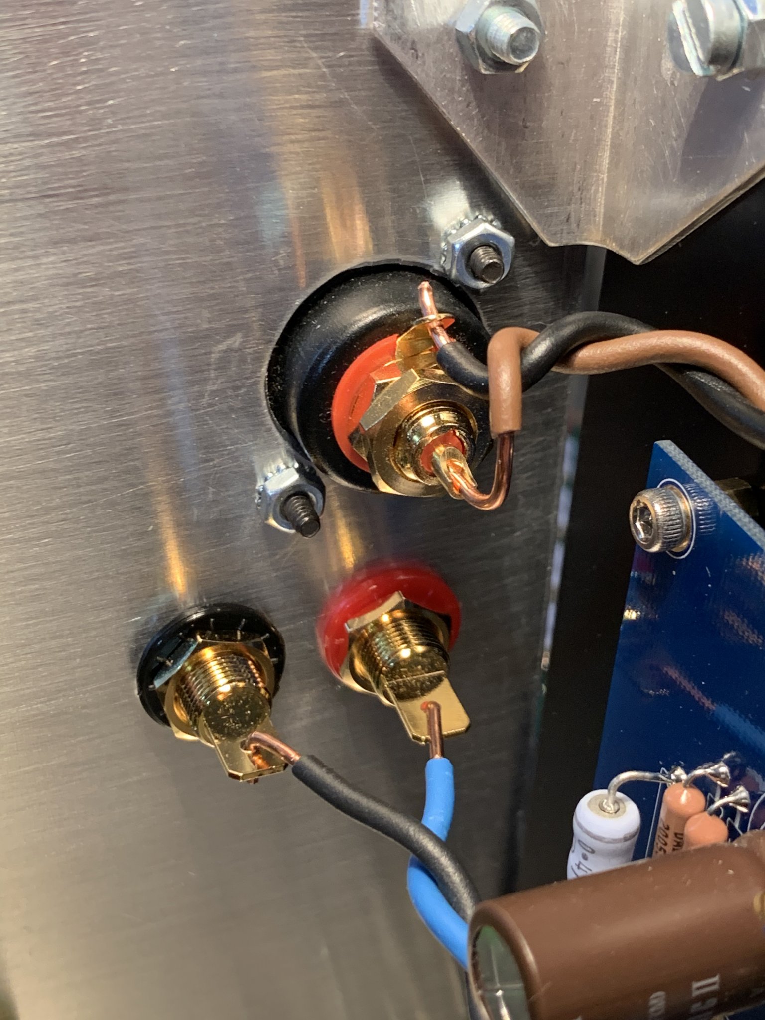

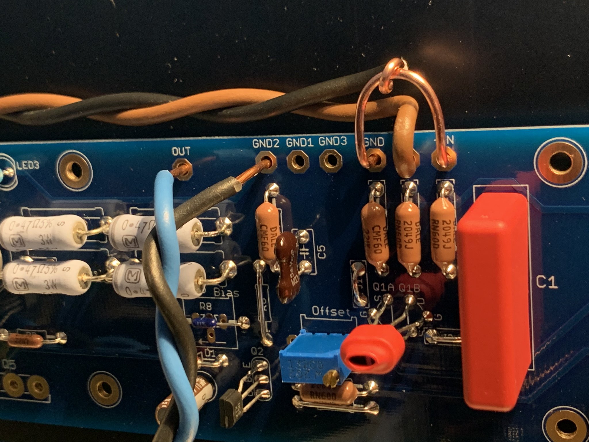

Will the input wires really be able to handle all of the expected low level input power???
fat solid core there ....... I mean - anywhere ....... I have no complaint if you're sure what you're doing , for everything
though, you know who's Cojones you'll start chewing, if something goes wrong , and you need to remove pcb from heatsink
:rofl:
(been there, done that)
:rofl:
🙂 Yea, you are right about that aspect of tight and as short as possible solid core wiring. Well, i am reasonably sure i have got it right. But of course not yet absolutely suresure 🤫
So, i am thinking - i will desolder at the terminals, to get the boards out of the amps, if i got something really wrong. Or if there will be some modding down the road 🙂
