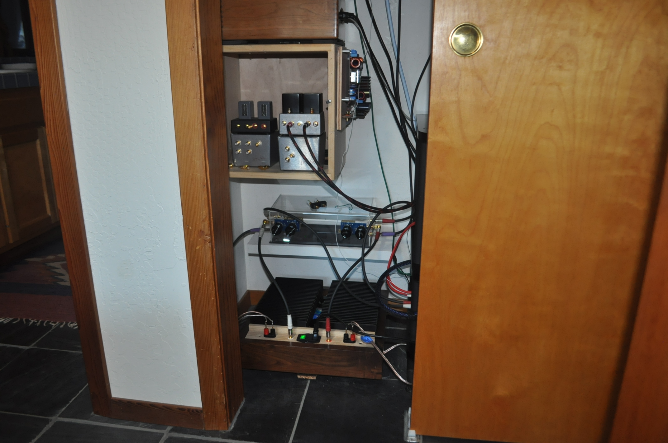

A common rule of thumb (or finger) is keep the heat sink temperature at 55C or lower for longevity of the output Mosfets. The Papa Pass method of temperature determination is that you can touch the heat sink for about 2 seconds at 55C.
Your heat sink placement does not provide maximum cooling efficiency. Vertical placement of the heat sinks with the fins aligned vertically, and with free space below, above, and around the heat sink is the best. An enclosed space, if you keep the closet door closed, is also not good.
If the heat sinks get too hot, a small fan blowing air across the heat sinks would make a big difference.
The less desirable fix is to lower the bias.
The temperatures are not too bad then.
You have a vent slot between the heat sinks but do you have holes or vents in the bottom of your case? Having air flow through the inside of the case would aid in lowering heat sink temperatures, as the Mosfets and heat sinks as well as the power transformer also radiate heat inward. Also raising the case a few inches above the floor would allow better air flow into the case.

If your mosfet temperatures are reasonable then you should leave as is.

But, but, but, you don't have an overheating problem.
After all that trouble to get the amplifier working, don't risk messing it up by removing output devices in order to change the thermal interfaces.
Yes. Don't worry about the thermal interfaces if you're running at 45°C and the amp is working properly now.
