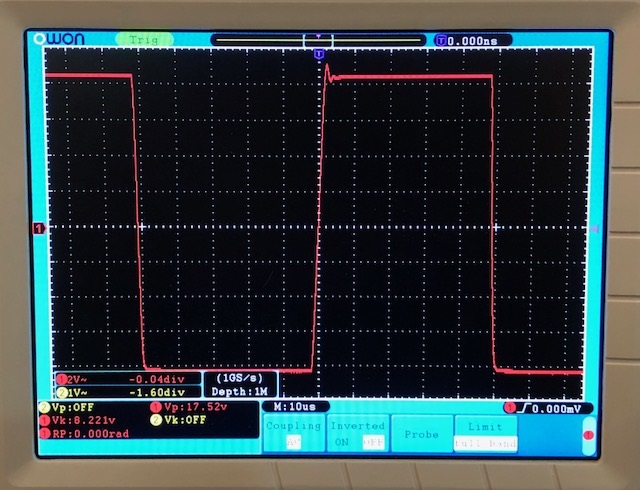

10kHz Square Wave
This is for the BB amp: here is a 17.5vpp 10kHz square wave into an 8ohm load. I am not sure if the rise time is limited by my cheap function generator or the amp. There is a tiny overshoot, with what looks like a ~1MHz ring that decays very quickly. I took it up to 40vpp and did not see anything worse. Shape stayed the same. Below 5vpp there is no overshoot.
X,
This is magnificent, I have really seen a better amp at 10k on square wave!
The resonance could be removed with a small 22pF from collector to emitter of the active CCS transistor, T5. It seems we are tilting at windmills, there really is no evident problem with this amplifier.

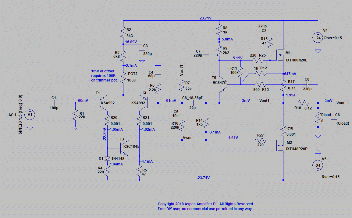

Yes, but use the schematic of the 4R version with following change:
- source resistor 0.33 instead of 0.27 for reduced bias.
- add also a snubber 220p+47r across the CCS transistor, this should also be in the 4R version (Thx X for testing this)
Don't use the schematic of the 8R when using the bigger Ixys transistors,
because you'll get higher distortion and the CCS will be out of balance with the output transistor.
This 8R Ixys schematic gives the same FFT as the normal 8R Irf version.
Here's the modified schematic.

Just for clarity: normal Alpha (Pmos hybrid) uses a 7.5A Pch Mosfet. Now when making a decent version that can also drive 8 ohm Kef speakers, Alpha4r, one needs a minimum 40A Pch Mosfet. For 6 ohm minimum load 7.5A is sufficient, why is at least 40A needed for Alpha4r, what is the formula for this ?

Basically I select for thermal capacity and cost. If the 4R Alpha runs 2A quiescent, the dissipation on EACH device is 48W, the 8R version running around 36W. The BB running at 3A dissipates 108W in each device and this prompted me to specify 480W IXYS devices with 1KW devices even more suggested, but these are expensive.
I like to use devices with at least 280W dissipation rating on the Alpha 8R and 4R. These are FQA40N25 and FQA36P15 from Fairchild. They are economical and TO3P DEVICES and I can recommend them.
For the BB I specify a 480W devices minimum.
In early posts I have mentioned other parameters; Vds, Ciss, Id, gfs but any hexfet will work well within obvious limitations. There may be subtle differences in Sonics from diverse mosfets but I dare not go there..... generally I have always found the sound quality comes from the topology, the components (particularly the caps), and the operating points.

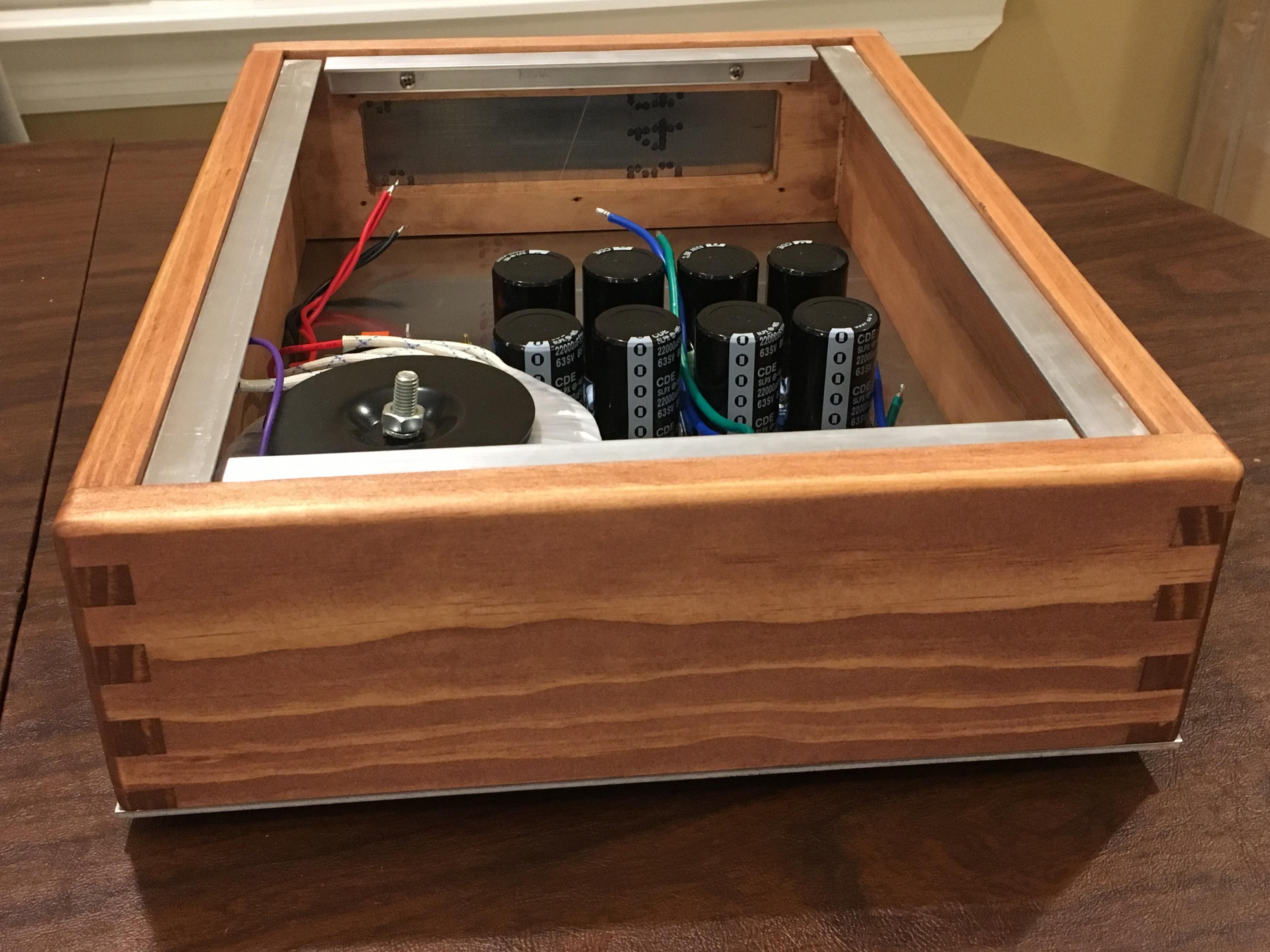

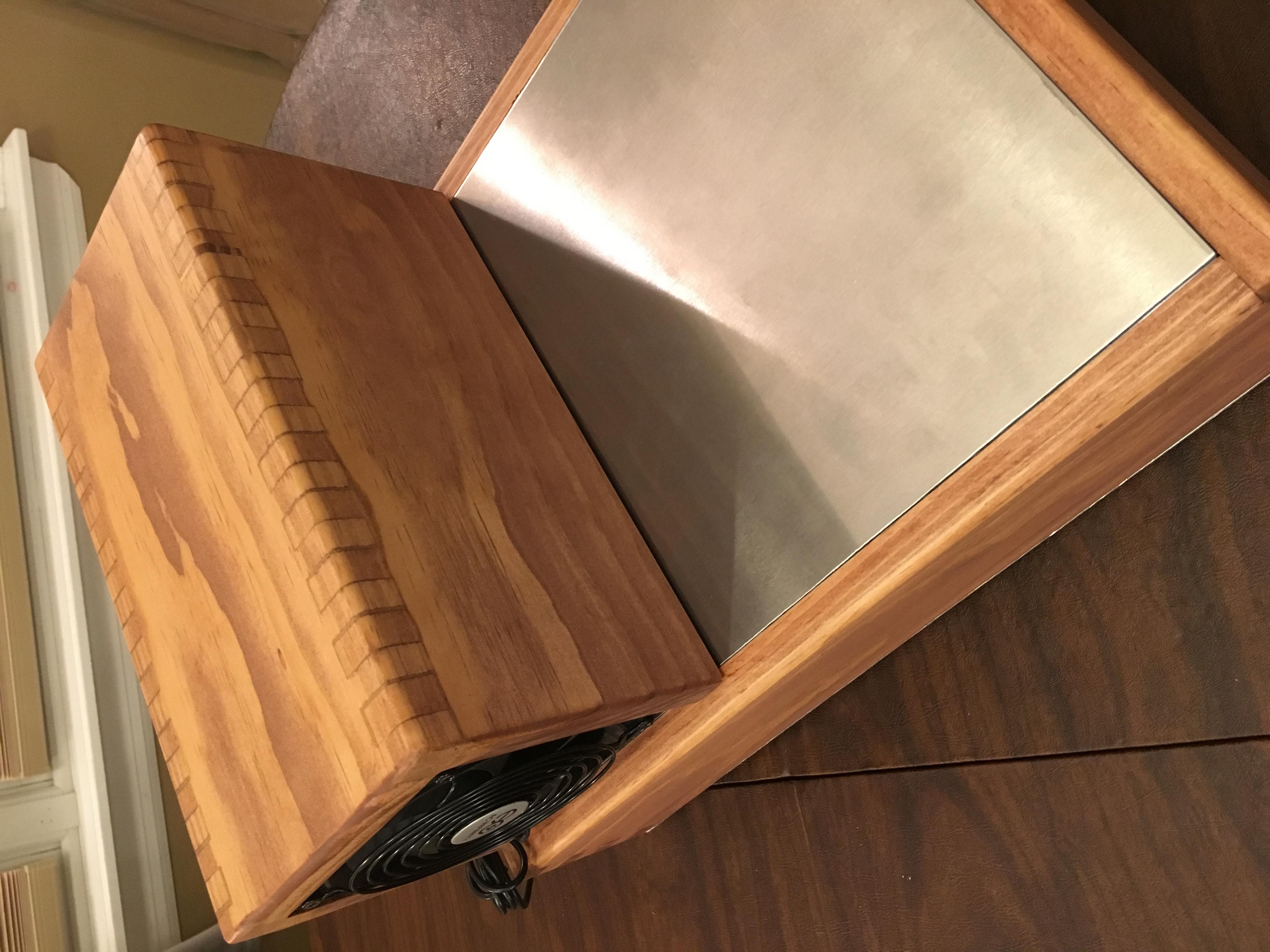

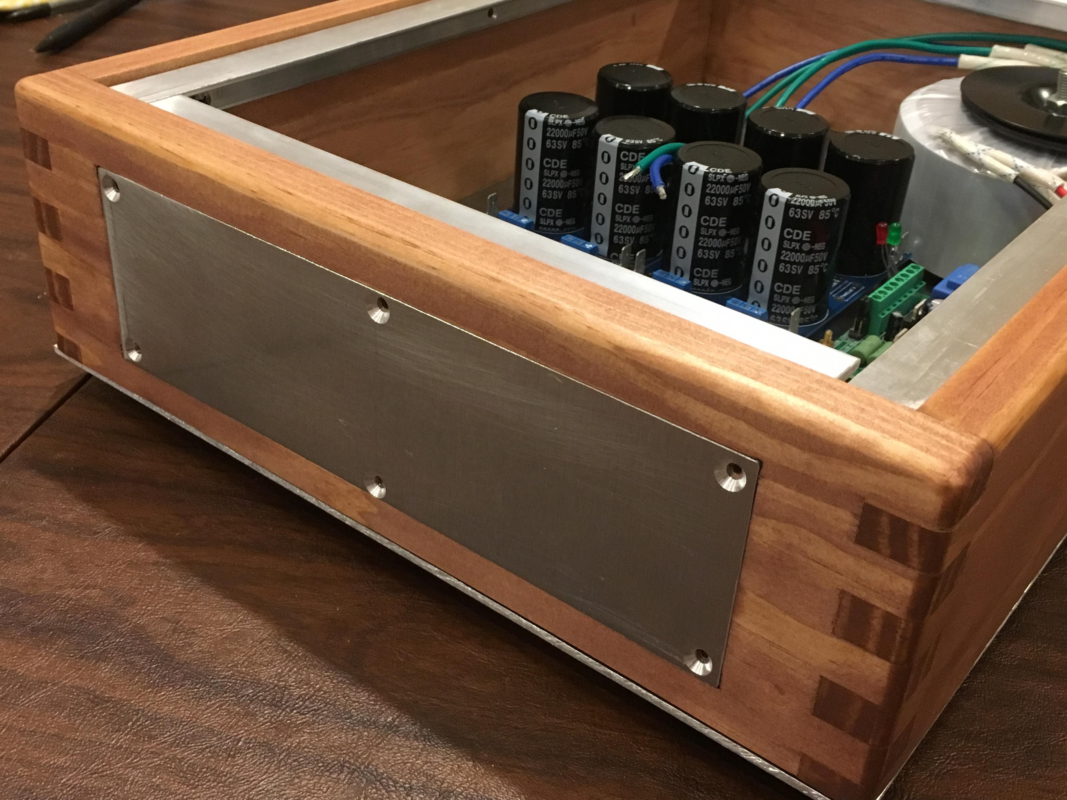

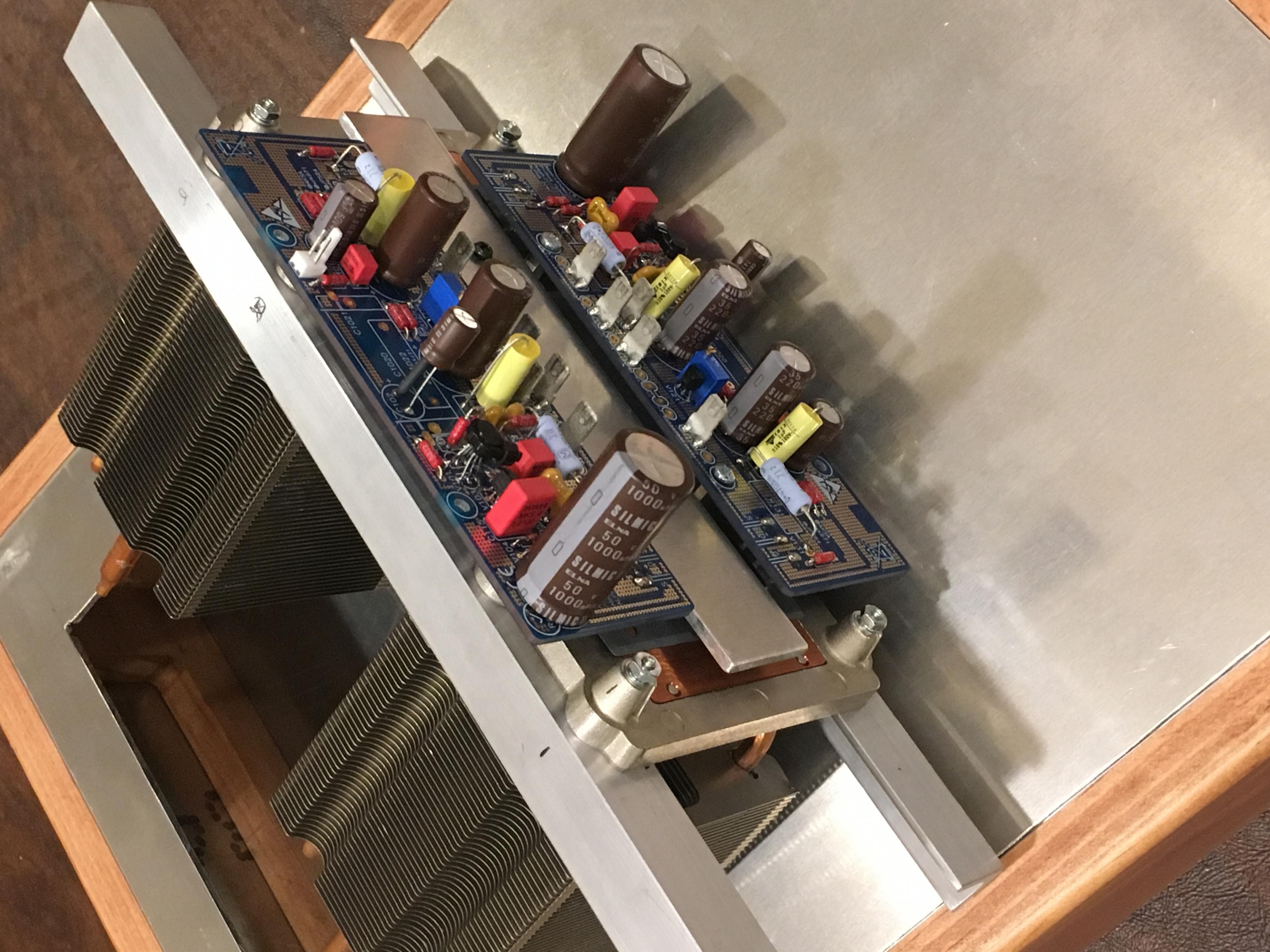

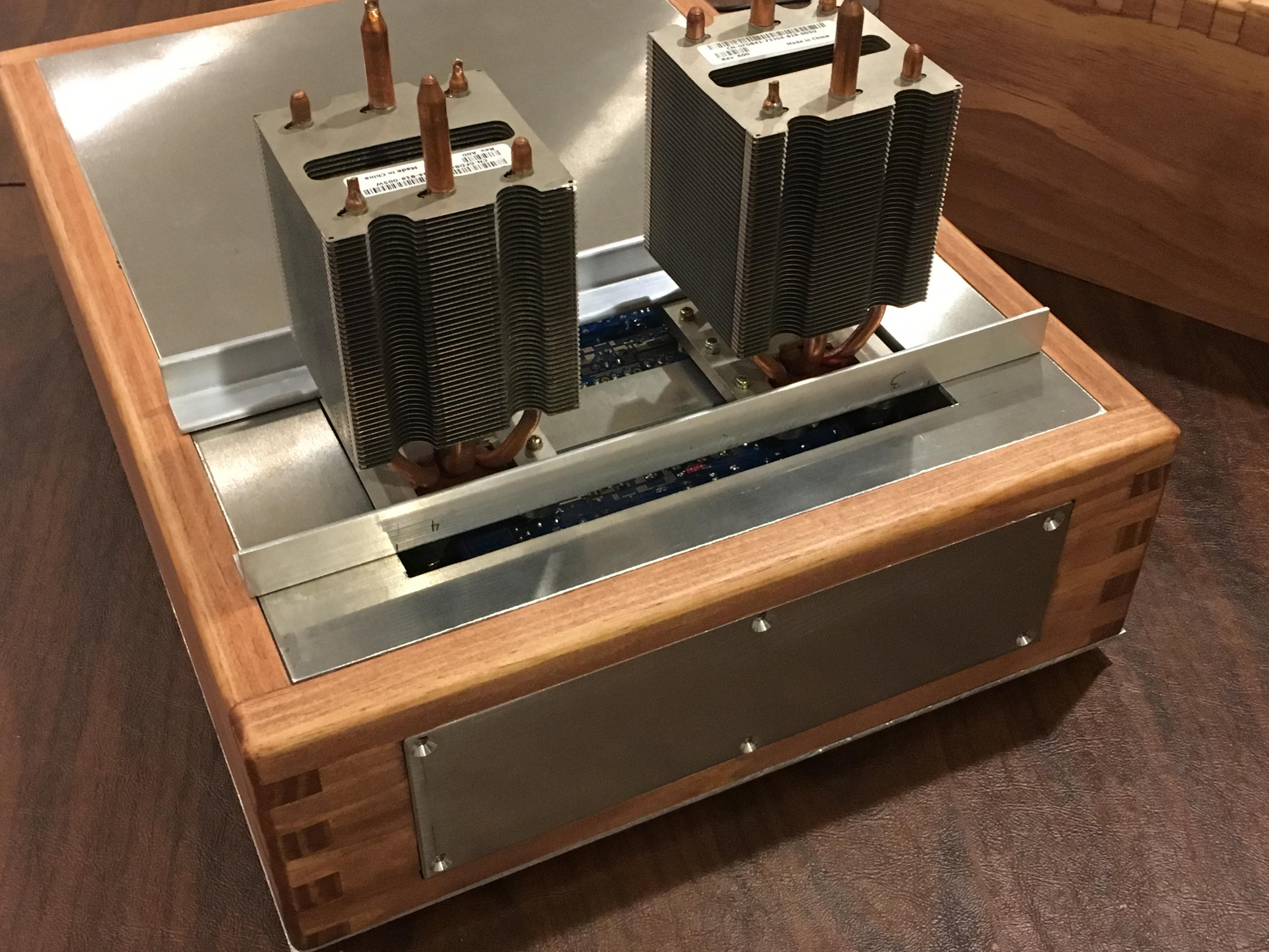

It has been a slow go since I’ve had a successful working stereo ALPHA20 on the work bench. The enclosure has taken longer than expected but, I’m in the final stretch now. The rear panel needs to be completed and then wire it up!
Here are some progress pics:
Very nice Vunce - has the feel of a tube amp chassis. It's almost a shame to cover the radiators with a wood tunnel shroud. If you left them exposed each with its own fan it would be more reminiscent of a tube amp with two transformers on top. But the wood tunnel is an original concept. Nice joinery!
