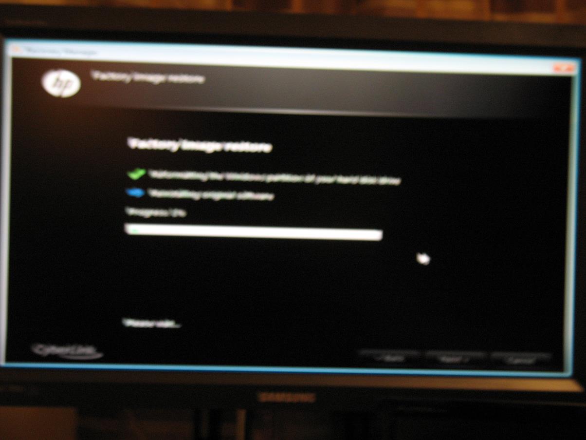

My computer crashed, I needed to reinstall all my software and Windows 7
I lost a lot of my work a couple software also, I did not make previously back up CD and now I do not find the original software.
Especially I miss my Sprint I have a dozen file saved I am no longer able to open those.
I downloaded the demo version but does not open any of my old files.
Maybe I saved it wrong those files or who knows.
I only used it to store and open up some Sprint files, I could not use the whole program.
To buy it again without knowing it will open my previously saved files would be a waste of $$.😱
I had a bad weekend at least my computer back and running again.🙂
