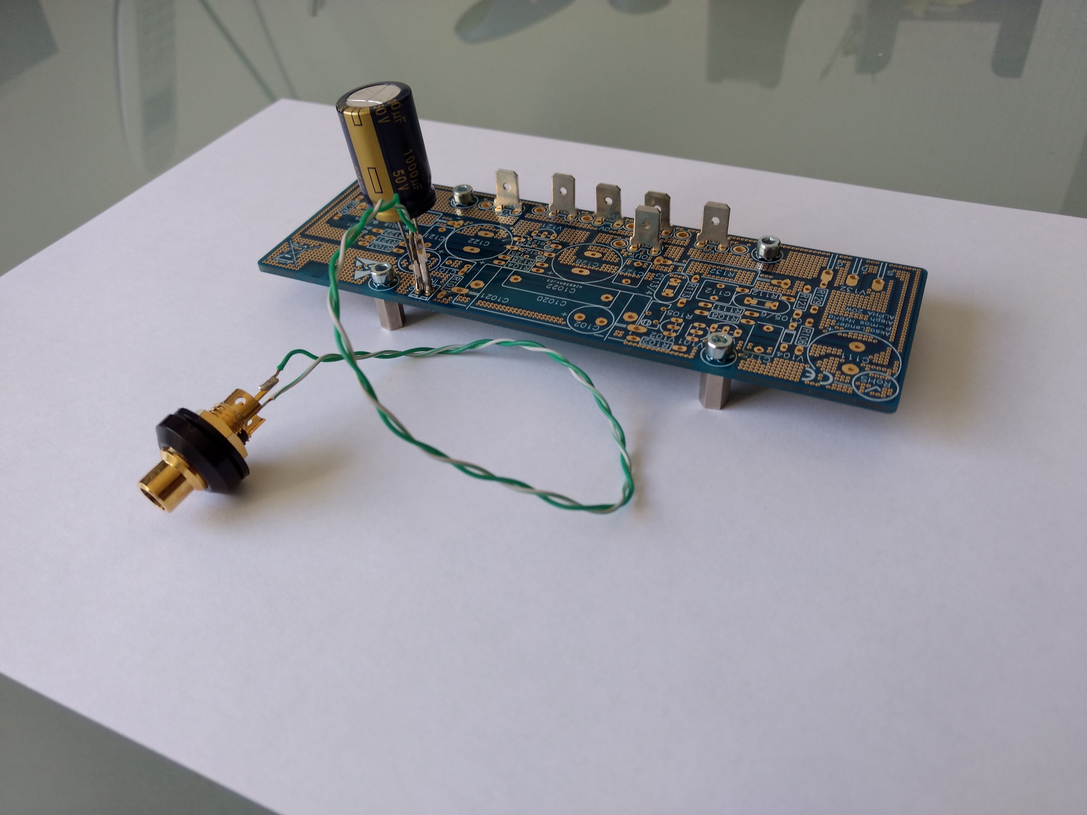

Question was about c103 as in picture, not c111.

My mistake - C103 needs to be 1000uF and at least 35v and the large value is for the anti thump feature.

Wasted some shipping costs here, yesterday I ordered the wrong value, no big deal.
Then again the question, but with more context ;-)
1). Alpha 20 JPS64 schematic, The C103 cap, Due to the limited size on the Alpha 20 board, a 1000uF capacitor will not fit, the max diameter for the C103 cap is 10 mm and the RM is 5 mm, this gives me a max of 470 uF 50 V (10 times the original of 47 uF (C103 is named C2 in the original AKSA schematic).
Now to the question, is the 1000 uF important or will any bigger cap as 47 uF do?

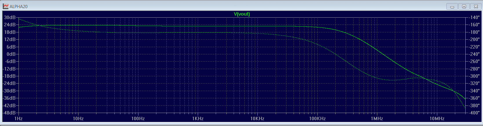

Hugh or Danny_66 can confirm, but from what I recall of Hugh’s sims - almost zero. It’s flat up to nearly 1MHz.
20kHz is given for Alpha and BB, 5.3 degreesOne question:
How much is the phase shift/deviation at 20 kHz? And a 100 kHz?
Thank you very much to both.
I read that one of Hugh's goals in his amplifiers was to minimize such shift.

FR and Phase relationship of ALPHA20
Here it is, pretty good too! 7 degrees at 20KHz, and 33 degrees at 100KHz. Much of this is due to the input LP filter; I have set it a 330R//1nF at the input.
The LF depends on the size of the input cap. I have set this to 10uF but down to 1.5uF is acceptable if you want really good caps (large!)
