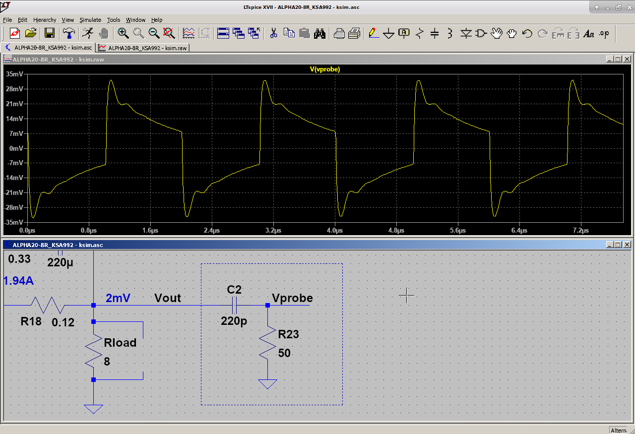

I accept your sharp suggestion and Spice indicate it scotches the 5MHz oscillation at the gate, but in reality it's not needed.
I may experiment with >20S mosfets, but his is not a CFP. T5 is driving a source follower.

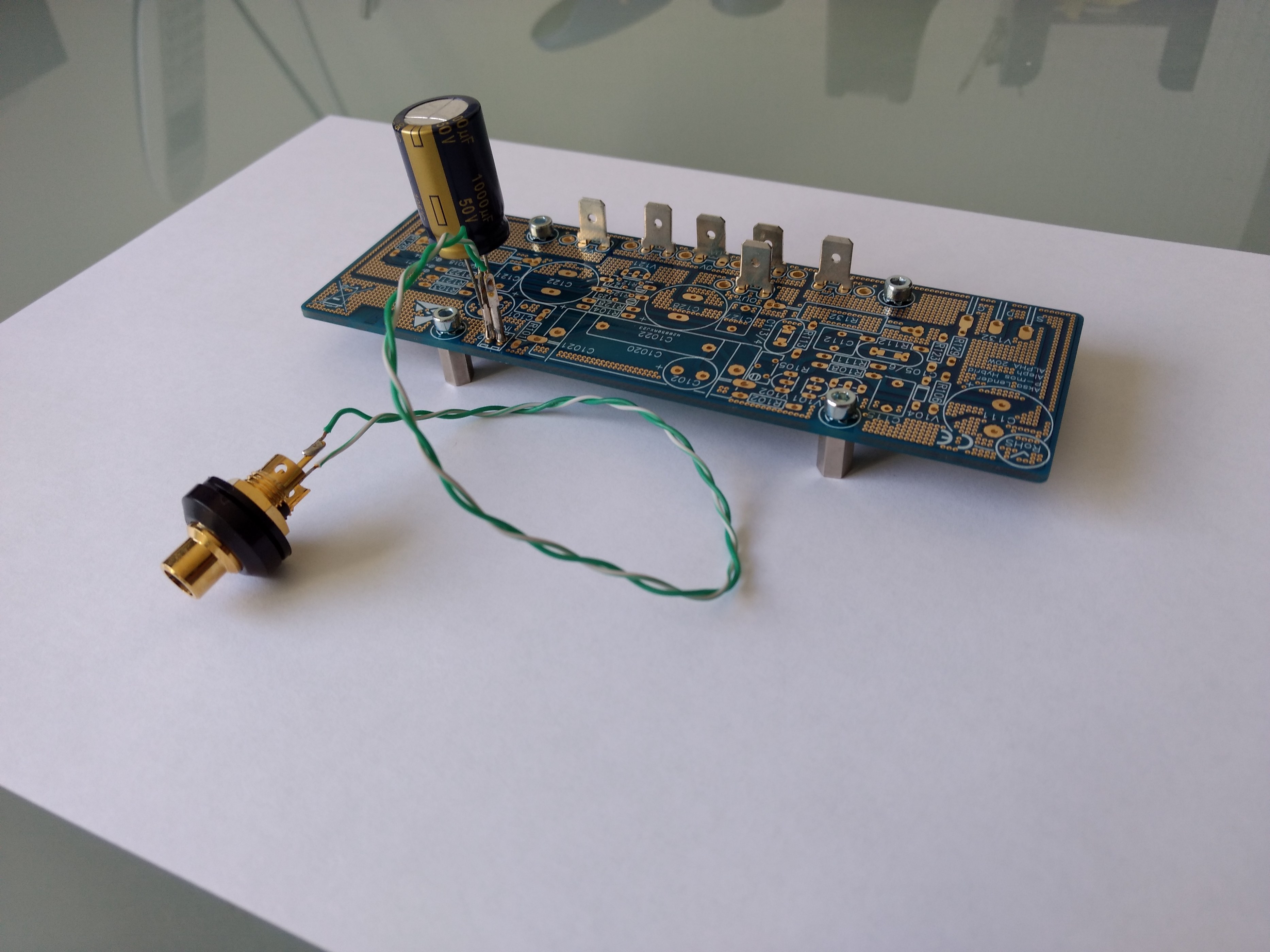

1). C103 cap, Due to the limited size on the Alpha 20 board, a 1000uF capacitor will not fit, the max diameter for the C103 cap is 10 mm and the RM is 5 mm, this gives me a max of 470 uF 50 V (10 times the original of 47 uF (C103 is named C2 in the original AKSA schematic).
Now to the question, is the 1000 uF important or will any bigger cap as 47 uF do?
2). About the "Elna Audio SILMIC II" capacitors, better to select "Panasonic" or "Nichicon" when "Elna SILMIC II" are not available? (at least Conrad does not have these in there program)

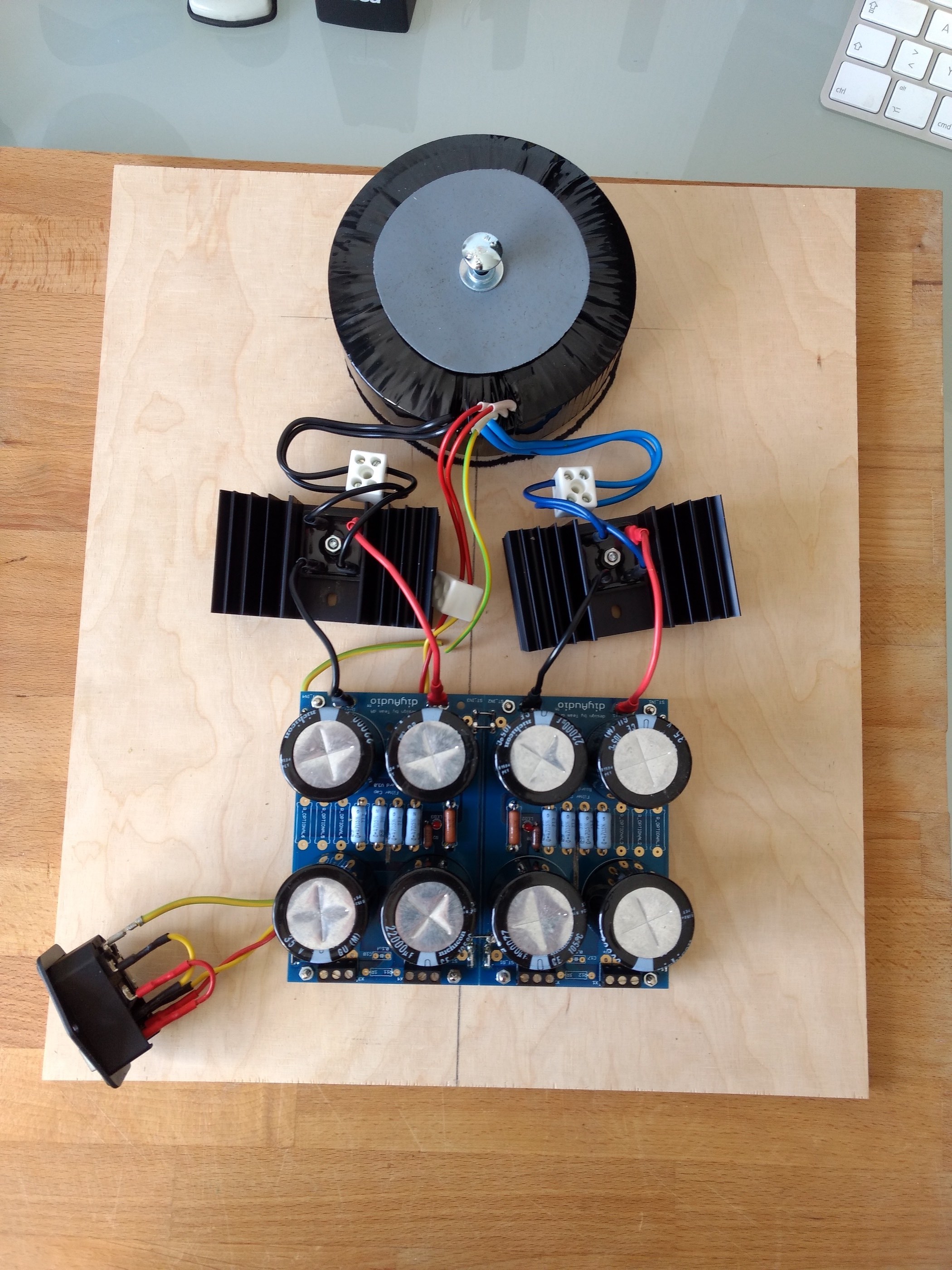

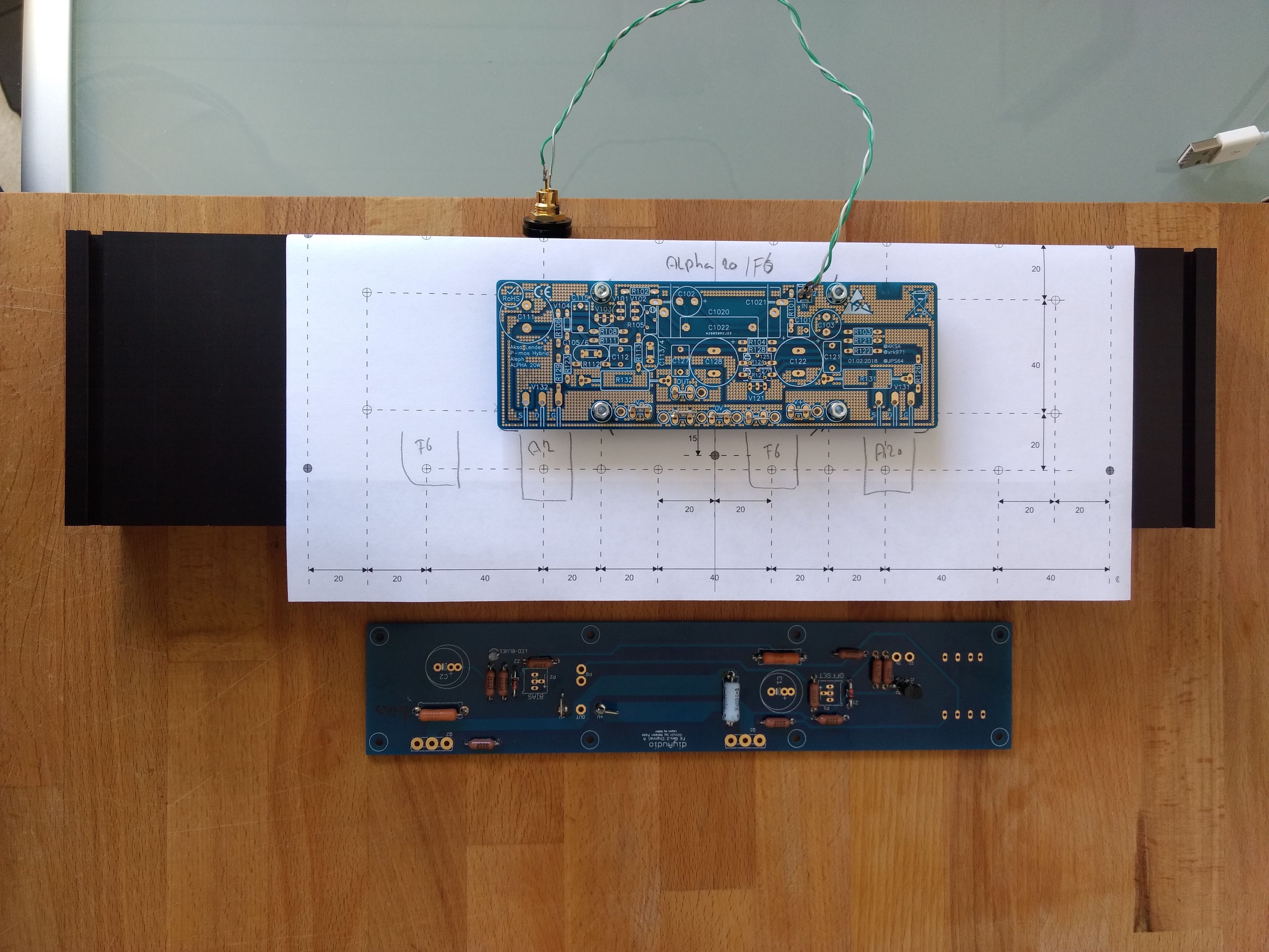

- A partially build diyAudio UNIVERSAL PSU V3 originally for a diyAudio Firstwatt F6 system (with a 2x18 Volt Torodiy 300 VA Transformer)
- Two Fisher SK 93 100 SA heatsinks ( 400 x 40 x 100 mm )
Some pictures, from left to right:
- The nice JP64 board with some mechanical parts and a 50 Volt 1000 uF Capacitor for C103.
- The "Aksa Lender P-mos Hybrid Aleph (ALPHA) Amplifier" board, on a diyAudio UMS printout, positioned in such a way that I can change to F6 board (to compare) on the Fisher SK 93 100 SA heatsink.
- The partial build F6 PSU

You are moving fast. 100uF 16v is all you need and not 1000uF 50v. That was my fault for over spec. I would use 220uF 25v if you have it. It doesn’t see anything higher than rails / 10 or 2.5v. There are nice Fairchild alternatives to IRFP. Some are mentioned in post 1. It doesn’t hurt to use big IXYS and leave option to run high bias for 4R version. Your F6 PSU is fine. Go forward then and don’t let the curiosity kill the cat watching the mouse! Panasonic FC/FM/FR are fine. Nichicon KA etc fine.

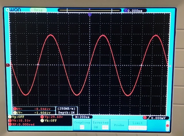

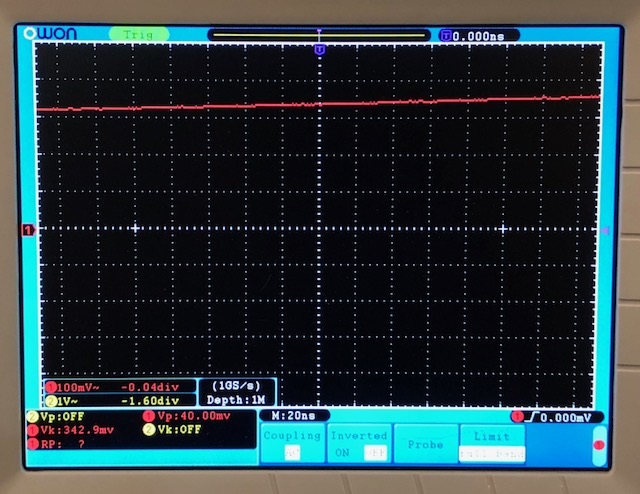

ALPHA Oscillation at 5MHz?
I hooked up a 8ohm 25w dummy load to the ALPHA 20, gave it 1kHz excitation to produce about 30vpp or about 14wrms. A good drive and equivalent to about as loud as it will be played at any reasonable speaker level.
Here is the O-scope shot for 1kHz 29.6vpp into 8ohms, looks clean:

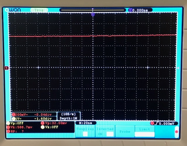

I then zoomed in to 20ns/div where 5MHz oscillation should show up, moved around from all time bases up and down on my OWON SSO 8192-V scope (100MHz 1Gsample/sec) and did not see any oscillation. Here is screenshot at 20ns/div, pretty much representative of the other timebases circa 20ns/div:
So I don't see any sign of oscillation on ALPHA 20 at a pretty hard drive. For the record, this is using 1206 SMT 22pF 5000v NP0 cap for C105 in schematic for production board.

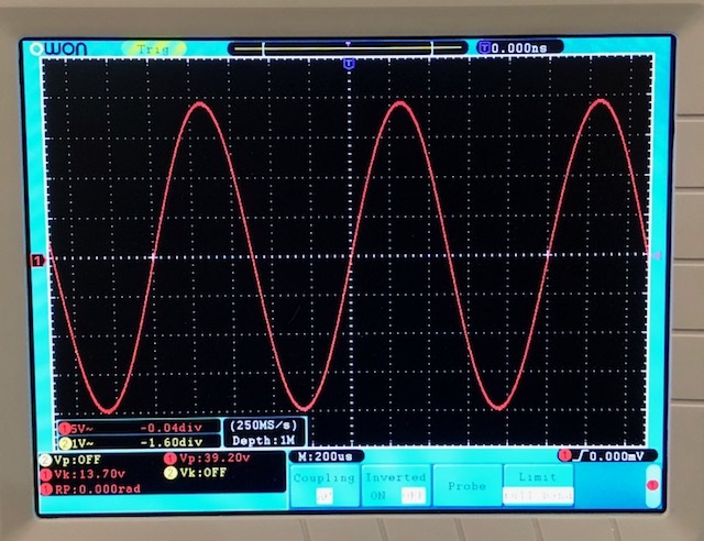

Edit, just took same data for BB, now at 39.2vpp into 8ohms or about 24wrms:
Here is the same drive but zoomed in on 20ns/div time base - and going up or down in timebase did not reveal any oscillation near 5MHz, and for the record, a 33pF 500v silver mica radial cap is used here for the compensation, with the recommended 220pF and 47R snubbers right at the D & G of the MOSFETs:
Also, btw, with zero input excitation, zooming into 5mV/div vertical and all timebases, revealed no oscillation at zero input.

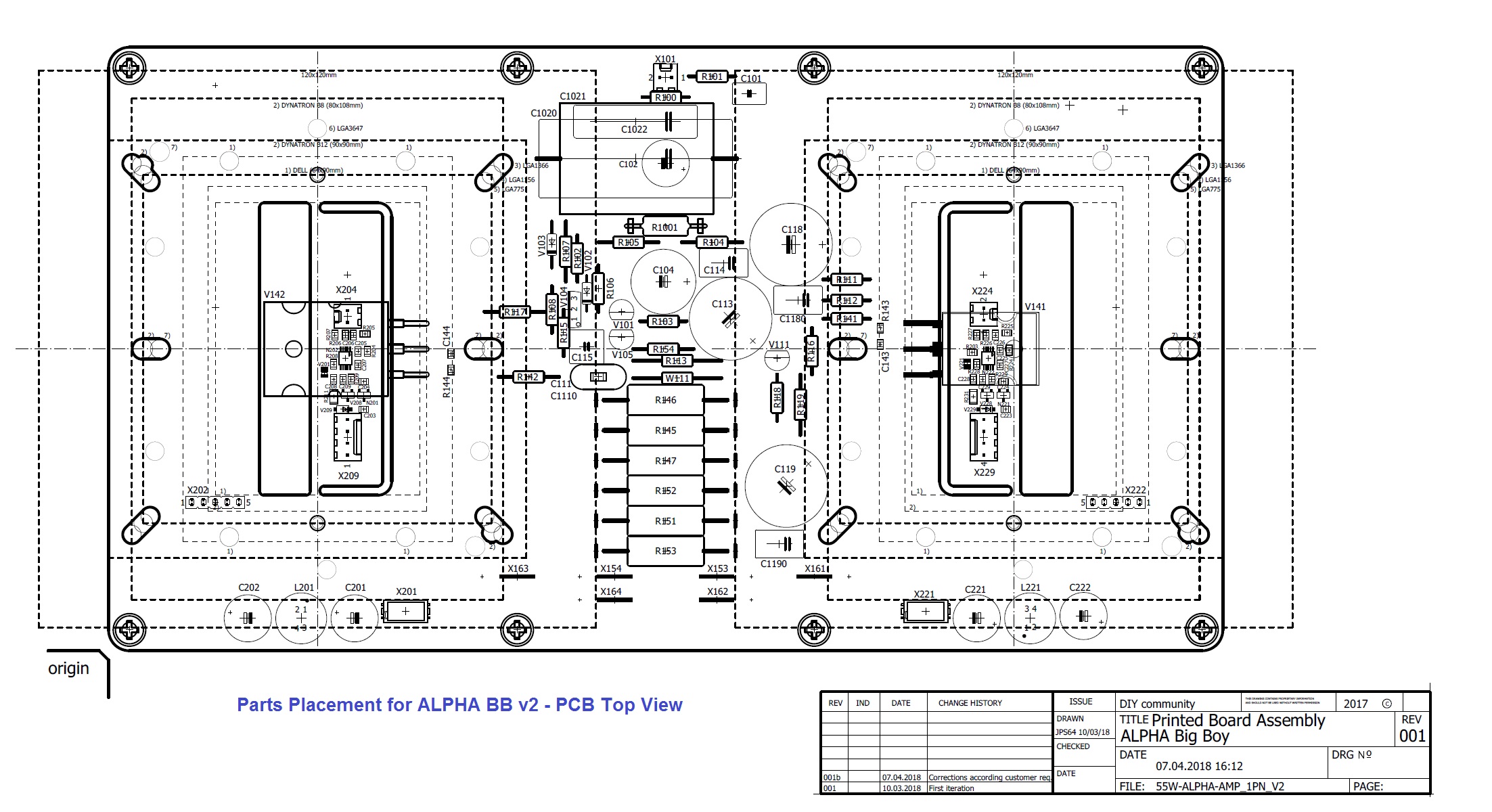

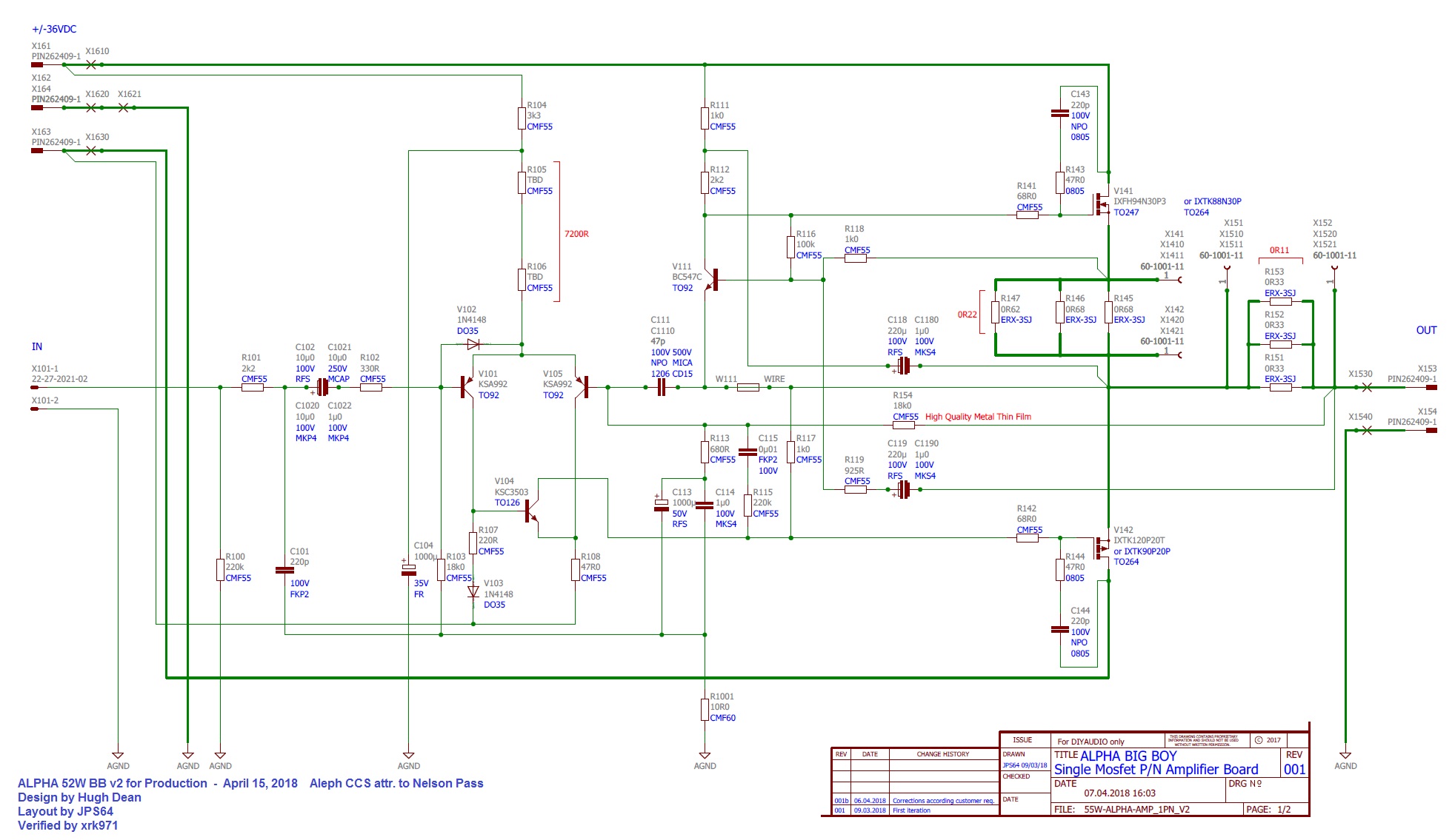

ALPHA 52W BB v2 Production Schematic & BOM
Here is the latest schematic for the BB amp that will go to production for the GB. I tried to update the BOM with as much info as I could recall based on my verification build and new info from recent posts - please let me know if there are errors on the BOM or if you have a question. The BOM is a .XLS file that has been zipped in order to be uploaded.
Schematic:
Parts placement on topside of PCB (board is 240mm x 130mm):
Schematic:

As I said, the resonance (NOT an oscillation) is nearly undetectable. A sine wave test is the weakest possible test for finding it. A sine wave has no 5MHz content, and even if this wasn't a class A amp, the switching transients wouldn't contain much either.
You need a square wave generator with 10nS or so risetime, and you might be able to see it if you zoom in on the root of the square wave, but probably not.
Use a 220p/50ohm HP filter like in the image.
