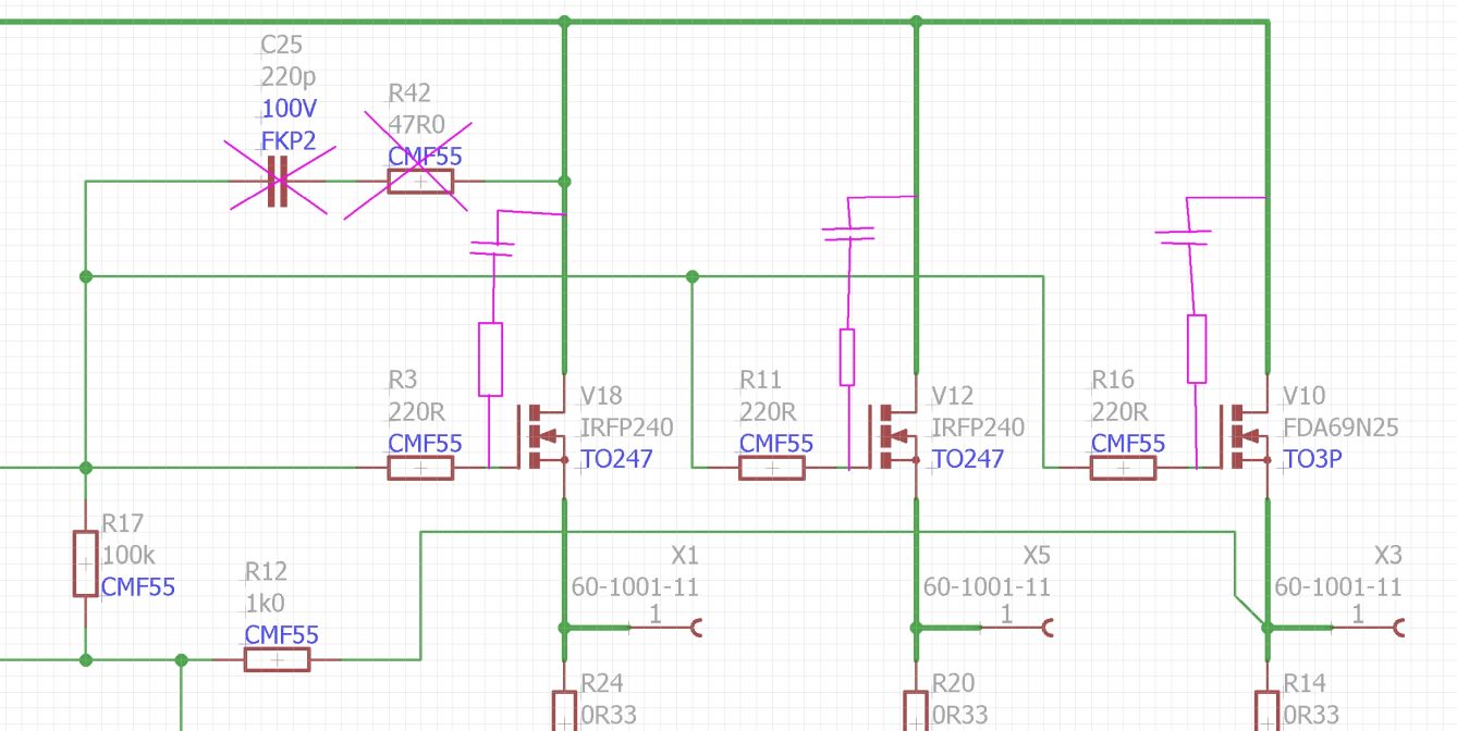

Hugh,
for each Mosfet?
JP

Hi JPS,
Sorry, slow reply, sleeping!
220p/47R in necessary on ALL mosfets; the snubber is used on each mosfet, and sure pass from gate to drain, direct, inside the gate stopper.
XRK is correct, they are in the signal change and his COG Murata is a good suggestion.

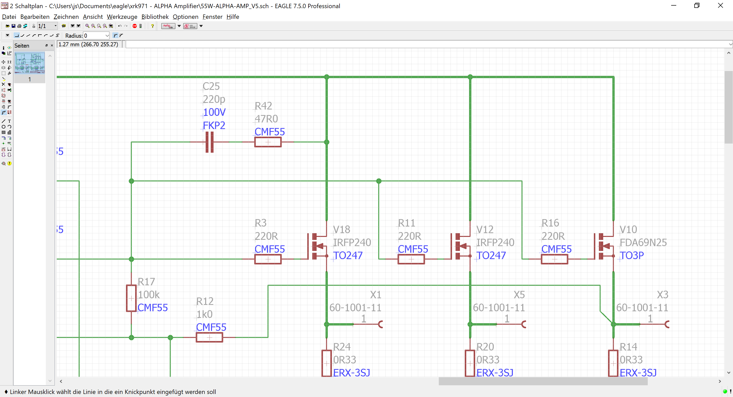

JPS64,
Re your question in post #761.
Connect the snubber network to each mosfet as shown.
Keep the two resistors close to the mosfet gate (to minimize the track inductance), and ensure the capacitor has a high enough voltage rating (100v or better would be good). A NP0 ceramic is ideal in this use.

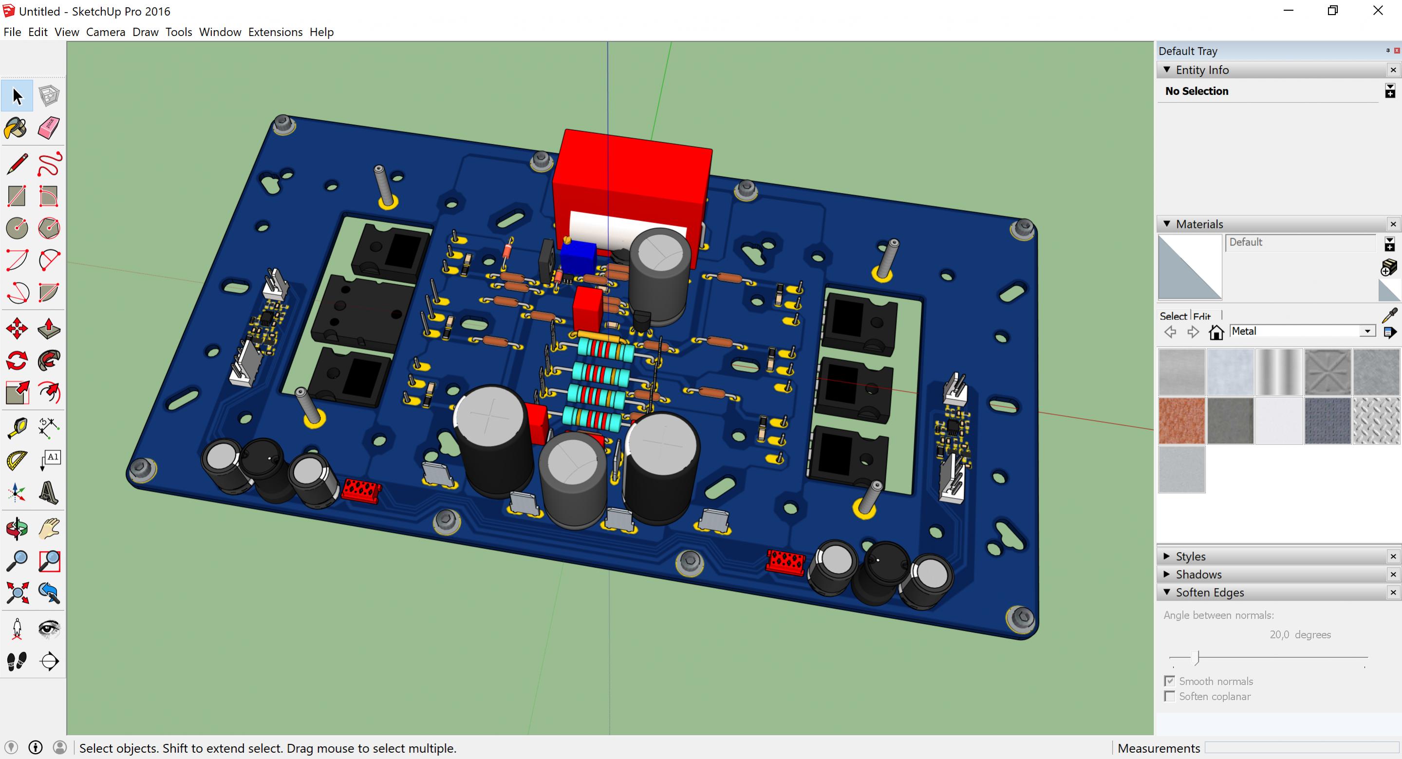

666203d1520174357-aksa-lender-mos-hybrid-aleph-alpha-amplifier-bb-jpg
Wow, that looks fantastic JP! Quite the masterpiece and a unique looking amp. I worry about having a PWM fan drive on board. Is there sufficient de-coupling to ensure that the kHz PWM pulses don’t get into the audio path? I am wondering if they should be off-board?
Thanks so much for all your efforts on a totally professional looking board. Hope the flu is all but over now for you.
