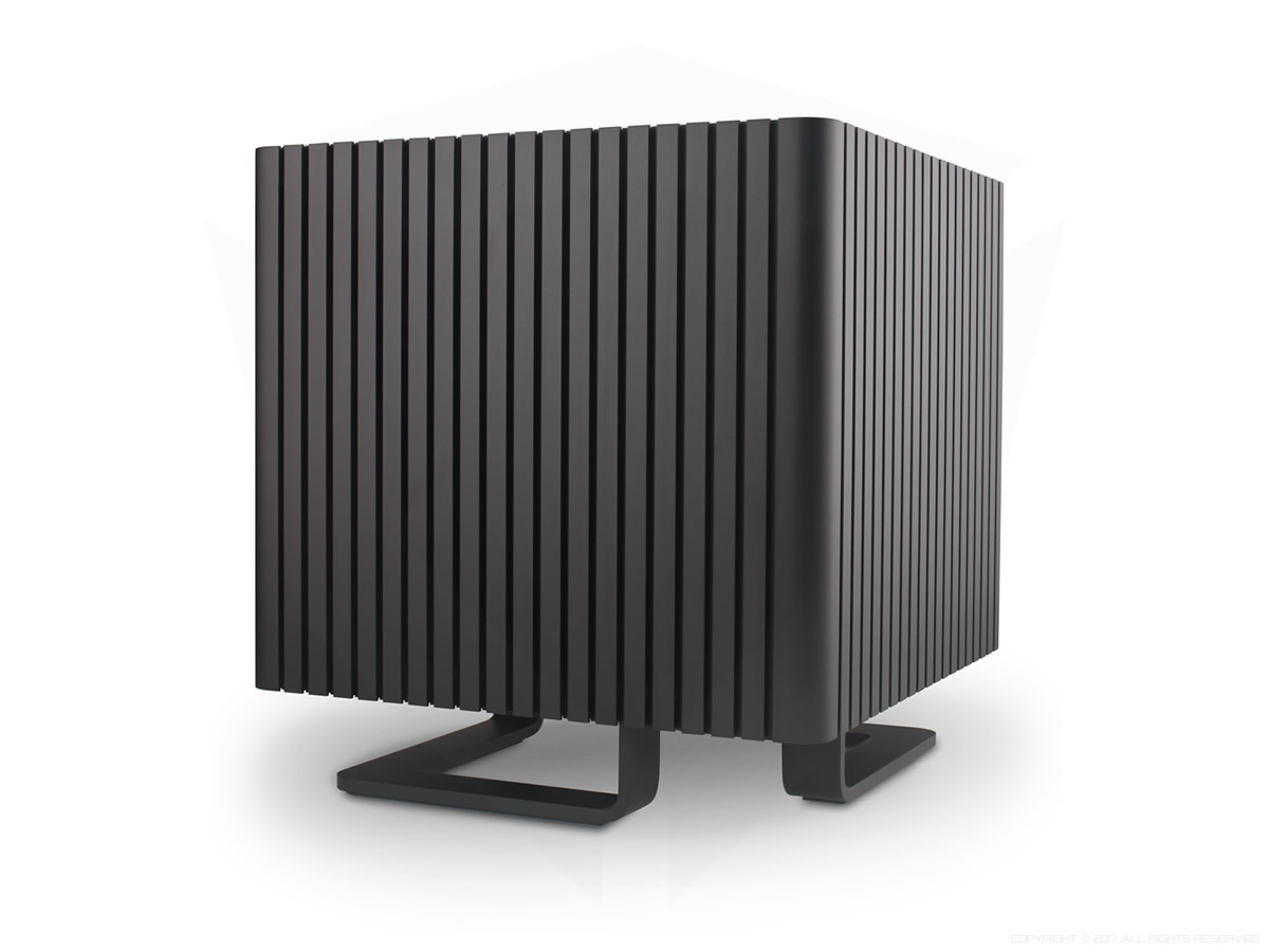

A head-up for those using processor cooler and planning the final set-up: some modern Mini- or Cube PC cases can be misused as eye-catching minimalistic amp enclosures, see brands like Jonsbo, Lian Li or Fractal Design. They are mostly well designed for good inner accessibility and airflow, some with really silent 120mm or even 140mm fans. Some as Kolink Satellite+ on UK Amazon go for under GBP35 and are real bang for the buck, some as Streacom DB4 are even for 300 bucks terrific aesthetics, if you go for such kind of things...;-)
