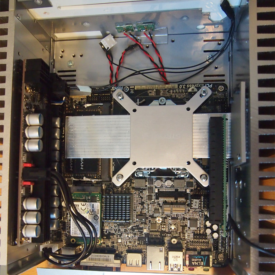

There might be a COTS solution but I am afraid it won't be cheap as using CPU coolers.
There is a AMEC THERMASOL ultra flat heatpipe available at Farnell, Amazon or eB that can be used for heat transfer if the case should act as radiator. Not extra cheap but DIY viable.
:eek::eek:
I would spend that fund on more heatsink and hard wire all the mosfets like the DIY Aleph X or Aleph 4. One main board with two daughter board solution etc. :)
Daughter board like the attachment.
I have 15" tall (long) heatsink the best option for me.
I wait until someone builds the BB. I want to replace the Aleph X with the BB. Aleh X just too much (at the hydro bill) with the 7A bias per channel.:eek:
