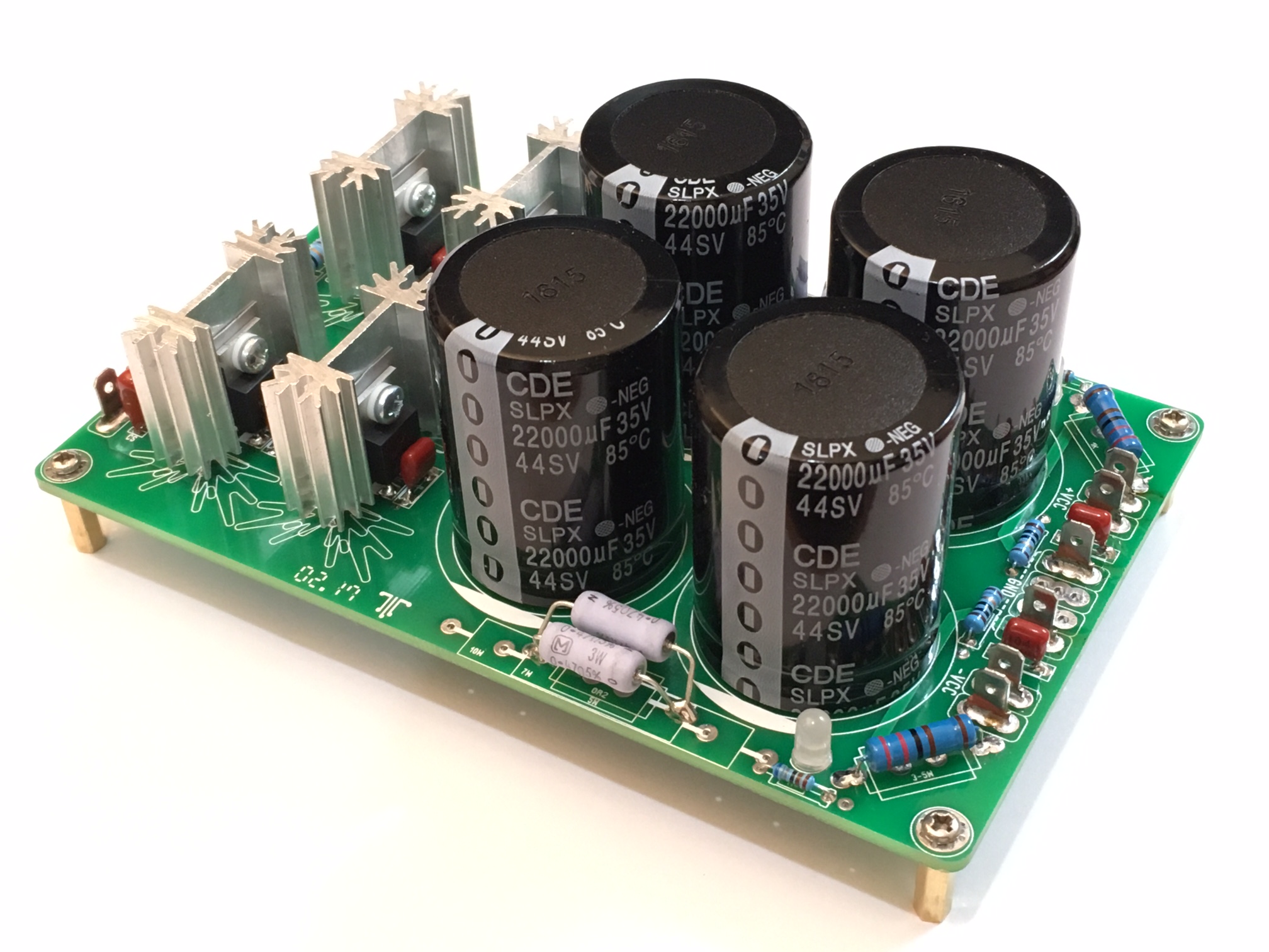

So I have a three of Project16/Prasi CRC boards fitted with four 22mF 35v caps and eight MUR880 diodes with the full complement of snubbers. Since Alpha has such good PSRR, maybe all I need to do is to get a pair of 400VA 25v trafos and I am all set for PSUs for the B.B.?
http://www.diyaudio.com/forums/grou...er-supply-class-amplifier-28.html#post5050668
This is what I have (3 of these actually):
I knew they would come in handy. I now don’t regret putting 35v rated caps on them

I cannot remember reading that in the thread: what is the minimal supply voltage for ALPHA? I understand less voltage means less output power but is there a limit where the amp will not work or SQ deteriorate?Awesome news. This sounds like good advice for future builds. Use 0.47R and 0,22R on R131, R132, respectively.
