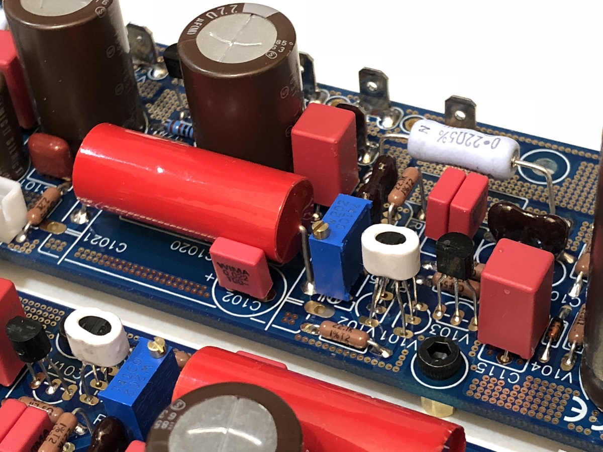

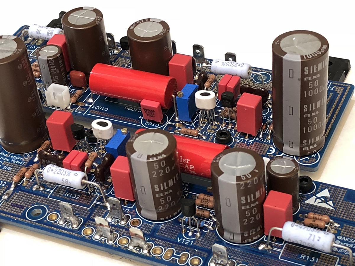

Alpha 20 Premium Build

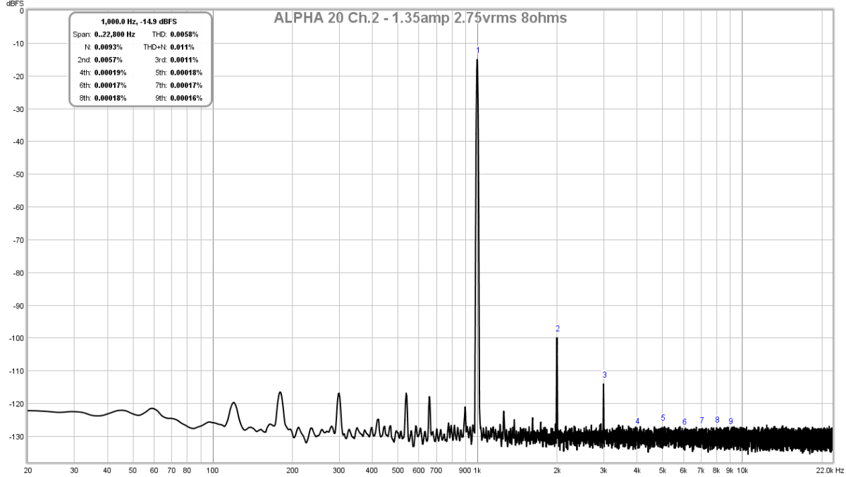

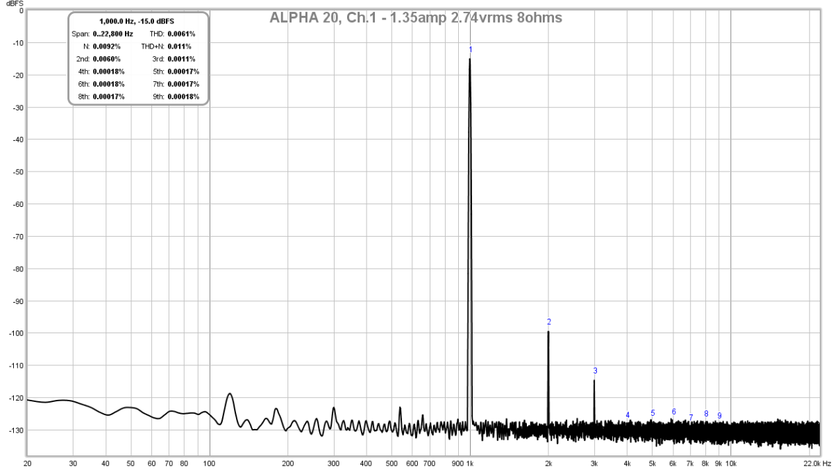

Here is the latest ALPHA 20 build using all Vishay Dale 0.5W 1% metal thin film resistors except for the 3W R131/132 which are Panasonic ERX series), and single R125 which is a Yageo 1% 1/4W metal thin film. It is the best measuring Alpha amp so far. The amp was measured sitting next to other equipment on equipment stand, so some mains EMI was picked up onto the measurement rig by radiation. THD is now about 0.006% on average and harmonic profile shows H2 is 6 times H3 and not much else. A very nice result. Listening to it now. This amp has perfect DC offset tracking with 0mV to 1mV at cold startup all the way to fully warm operation. Channel balance is also perfect with same 2.74/2.75vrms out for same DAC setting input.
attachment.php
attachment.php
FFT Ch 1:
attachment.php
FFT Ch 2:
attachment.php
