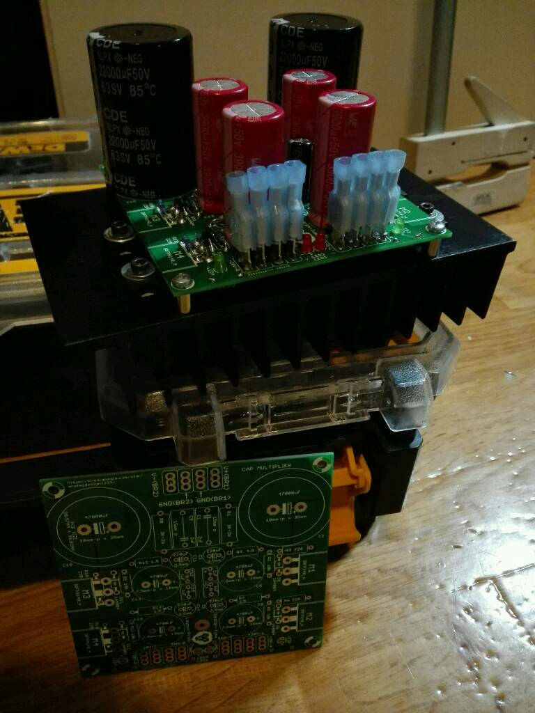

That's about the right size heatsink, Juntuin. We are talking about 35w or so, not insignificant. Same as an ACA amp (1 channel). Looks really nice though.
I thought so, and size fits nicely with pcb also in my opinion 🙂 was surprised that found them in Finland! Usually you can't find anything you need.
