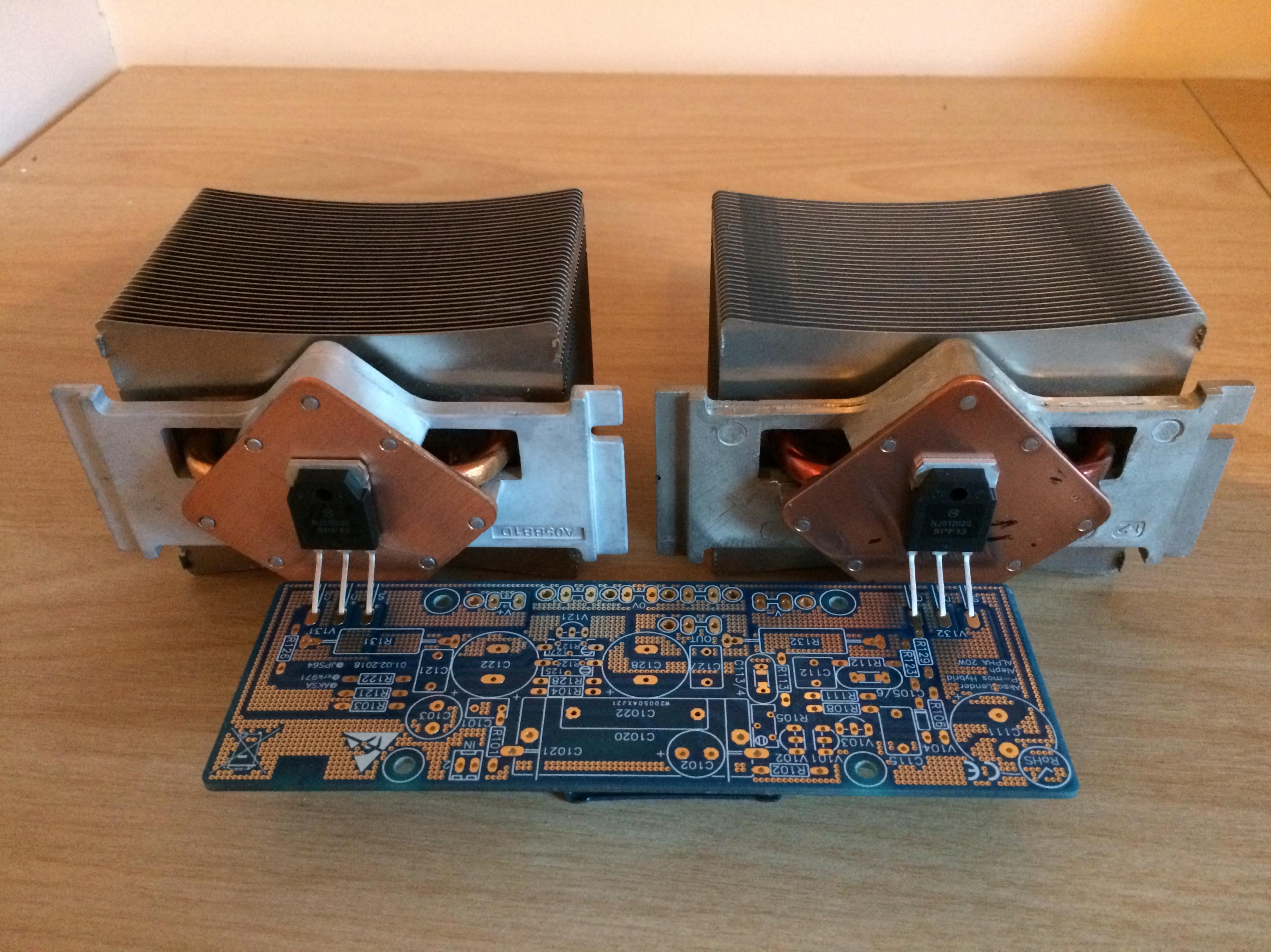

Hei Vunce or X, could you measure dimensions (about) from Alpha20 with Dell heatpipes attached? I think I'm going tight with space.

Those Dell's were selected by me because of huge copper pad - they are tall at 16cm from boss to tip of heatpipe that sticks out.
Might try Supermicro (2U rack) CPU coolers which are same wattage class but much lower profile. I don't know how big pad is bit would guess it can hold two TO-247's side by side easily, the as Xeon LGA 1366 is quite a large (45mm x 42mm) chunk of silicon.
Hi Juntuin,
These are the dimensions of my stereo ALPHA20 module:
Height 8.25”
Width 4.125”
Length 11.5” (8.25” cooler to cooler)
Remember, the height includes the upside mounted ALPHA boards plus the cpu cooler. I hope this helps 🙂
You can mount them side ways (with PCB vertical) and have top mounted fans blowing up. Then case only needs to be over 4in high. 4U is 7in high so should be fine even with fan?

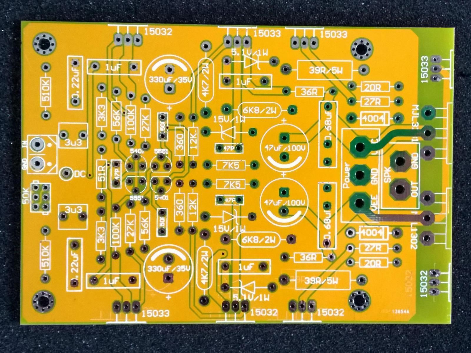

Thank you. Boards arrived today and I must say they are brilliant.
Thanks XRK, Hugh and JPS for all your hard work and making projects like this possible.

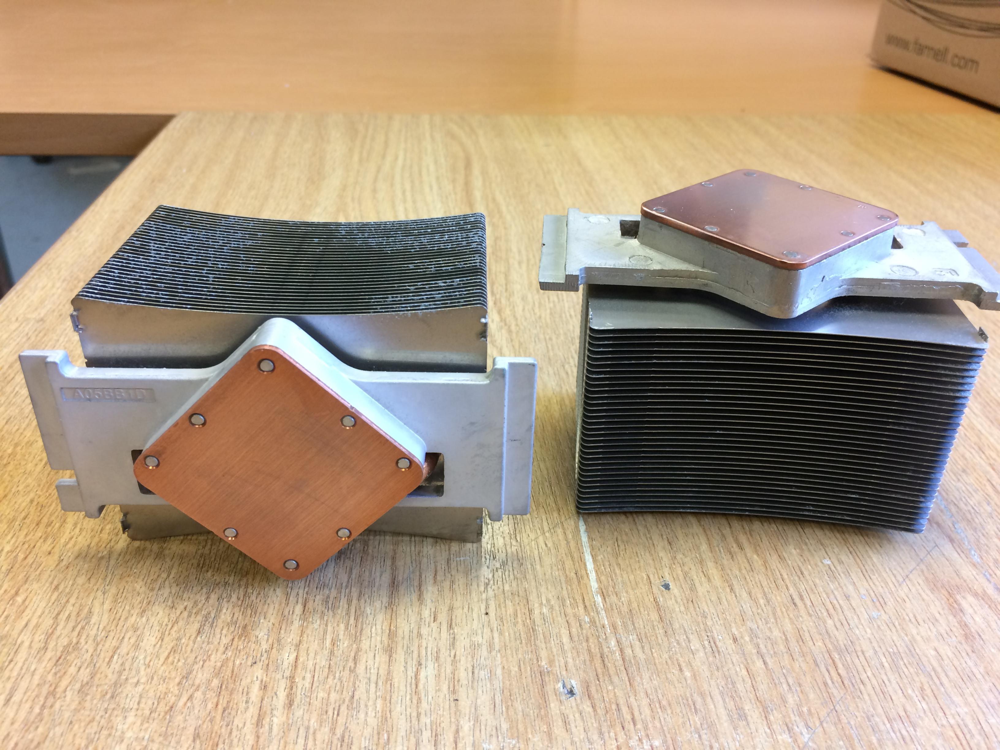

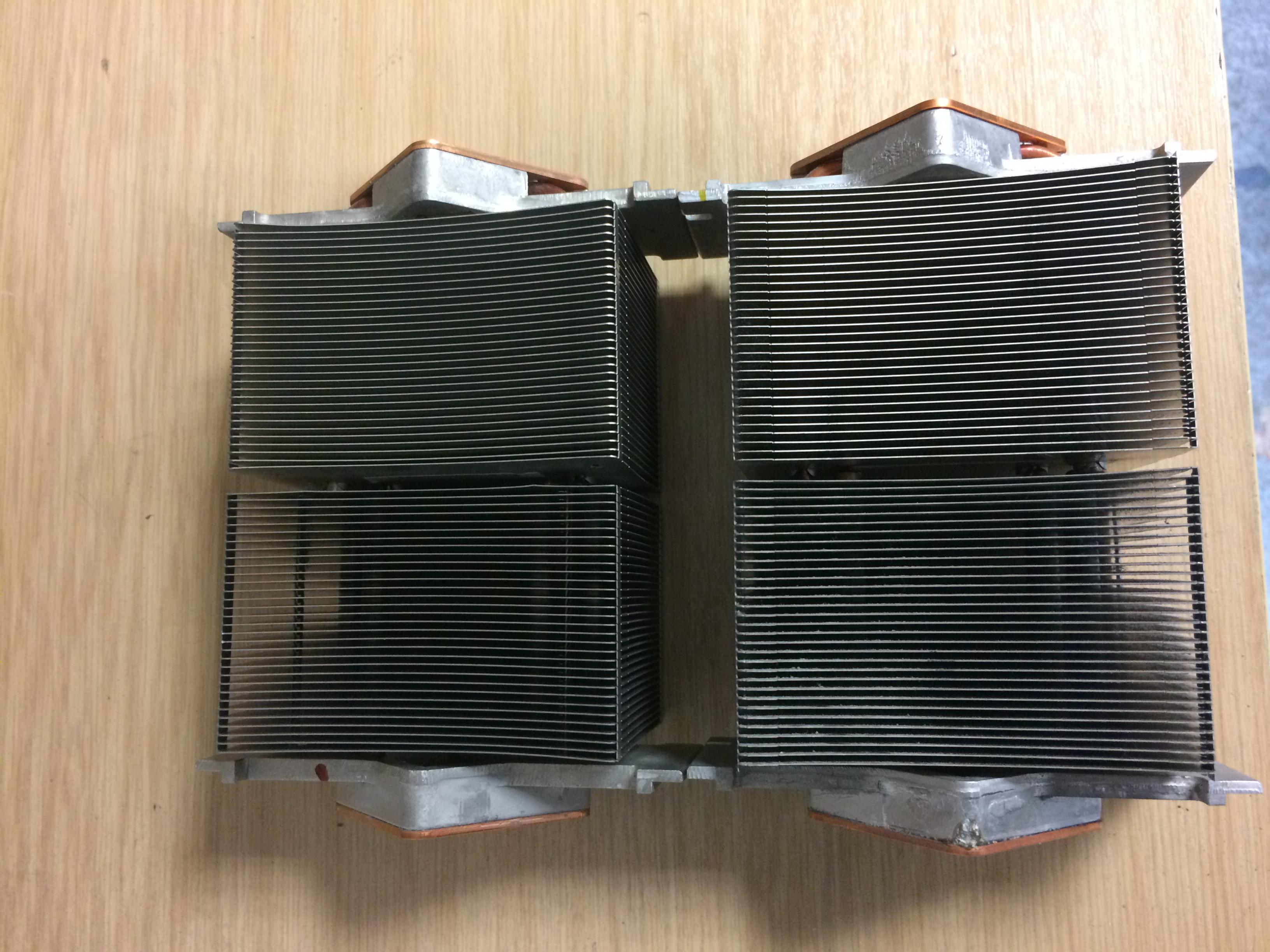

I was going to use passive heat sinks, but I have come across some used processor sinks ( 4 off ) and am considering using these instead. I believe I can mount the sinks on their sides and mount the output devices straight to the copper bases, using an insulator, mounting hole will miss the heat pipes. Two fans will be mounted below blowing up. The heat sinks measure 2.5"H x 3.5"W x 2.5"D.
One picture shows how I intend to mount the PCB, I will of course construct some kind of cradle to hold the boards securely and also support the fans.
The second channel will be a mirror version. The other picture shows how I am hoping to place all four sinks.
Any comments, observations would be appreciated

That looks perfect, Alibear!
With 4 of those sinks nestled together, I think maybe a 120mm fan could work? Larger fans would be quieter than four smaller fans.

I like how different users are being innovative and resourceful, even though these are UMS compatible boards, the only ones so far going that route is me (and 6L6 later). But if you want a "tap-and-drill-free" operation, the UMS sinks are the way to go. The 4U Dissipante case with 300mm UMS sinks was $150. Not cheap but useful for many amps to be swapped in and out. Although after a 5 hr listening session that went through late into the wee hours of early morning, I have to say that I love this amp, so not sure if this 4U case will be available for other Class A amps in the future... 🙂
Still kind of dumbfounded how a "20W" amp is able to drive my 82dB speakers to vvery satisfying levels of loudness and perfect clarity. I always used to think I needed at least a 50w minimum amp to do these speakers justice.

Do you know what the model number is for those heatsinks alibear?
Those look great, very well made it would seem.
awesome find!

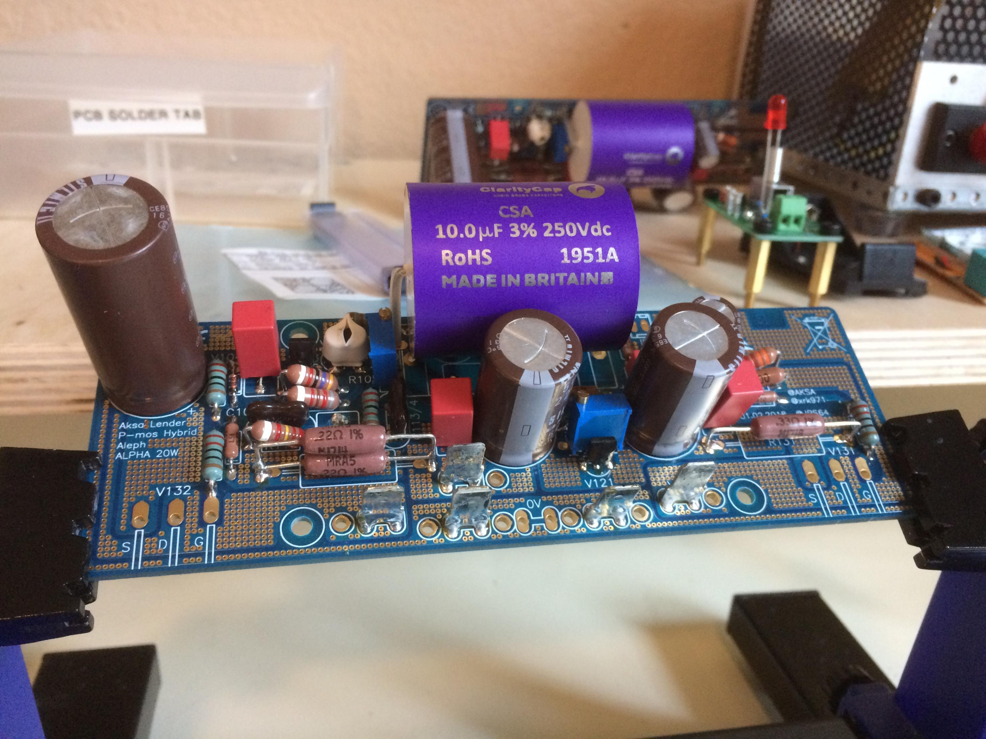

Finally got a bit of time to add the last few components to the boards, and drill/tap the heatsinks.
I need to measure my mosfets, then assemble and test in the proto chassis.
The 10uF/250v Clarity Caps CSA's fit better than I thought they would, they are enormous, obviously.
Received my PCBs today. Everybody loves them here in France 😉
Thanks again X, Aksa and JPS for your enthusiasm.

You're nearly there, nice work. That cap is big and colorful! Nice fit.
pcgab, I believe they were pulled from Dell computers. I got them from an IT guy, he had four. They have got numbers on them,--- JCI CN-OR6852.
I gave the sizes in the previous post. They have 30 fins. Hope this helps.

Perfect, thank you!
I found some on eBay pretty easily.
