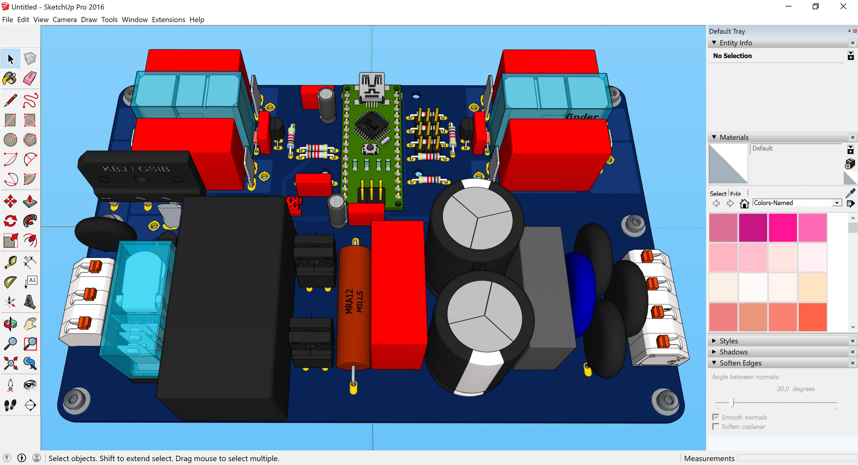

The microcontroller board using Arduino Nano and excepted the 2512 resistor only THT.
I´ll send X the schematics for controlling.
Upgrading BB board today before mockup ordering.

Get well JPS, sorry about the flu - it’s pretty bad this year. The design looks great.
One comment, I use female spade connectors with plastic sheath and they need more clearance - can you move them away from the nearby caps a bit?

PCB's came today, many thanks for the design team 🙂 they really are super nice quality.
First PCB almost stuffed now, seems that I'm missing one resistor and many caps. I used Vunce's BOM and he clearly told before that it's incomplete, just couldn't remember that anymore 😀 most important parts are there though and missing ones I can buy locally.
For R131 I used one .33ohm 5w and R132 one .12ohm 3w like Vunce, I assume they are just fine...?
Yes. But actually, if you use double 0.33R in parallel for R132, when you apply AC excitation, the optimal Aleph CCS tuning (via trimpots) strives to make AC voltages between R131 and R132 equal (since we want 2x the AC current in R132 vs R131). But 0.12R is fine if you have it.

Hi Juntuin,
I never released a BOM?
I referenced the schematic to make up my parts list. The values I picked for R131 & R132 are on it.
