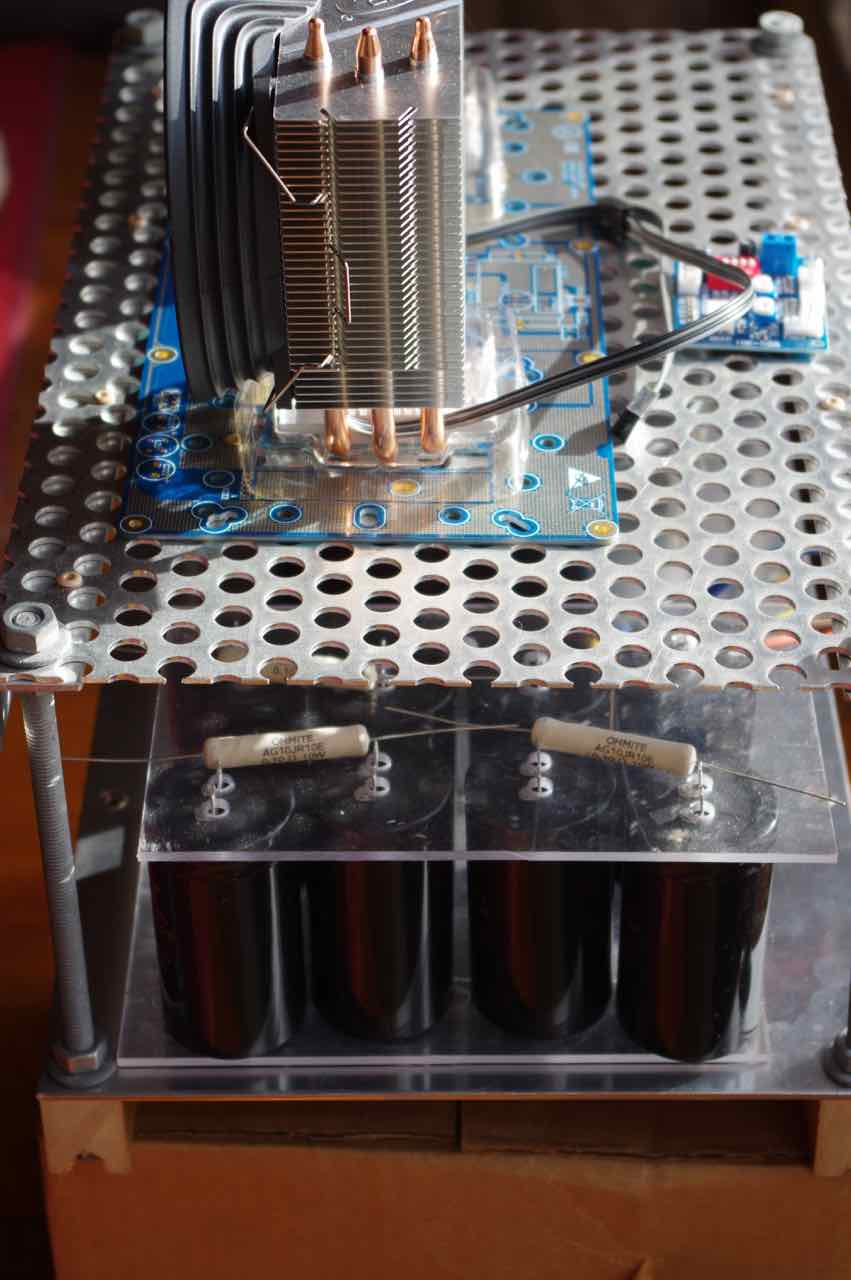

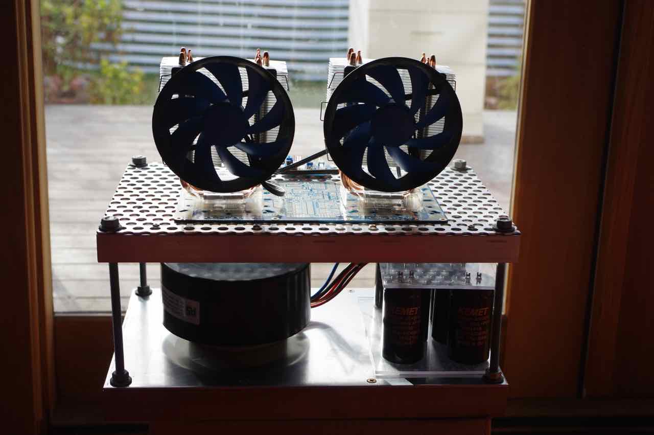

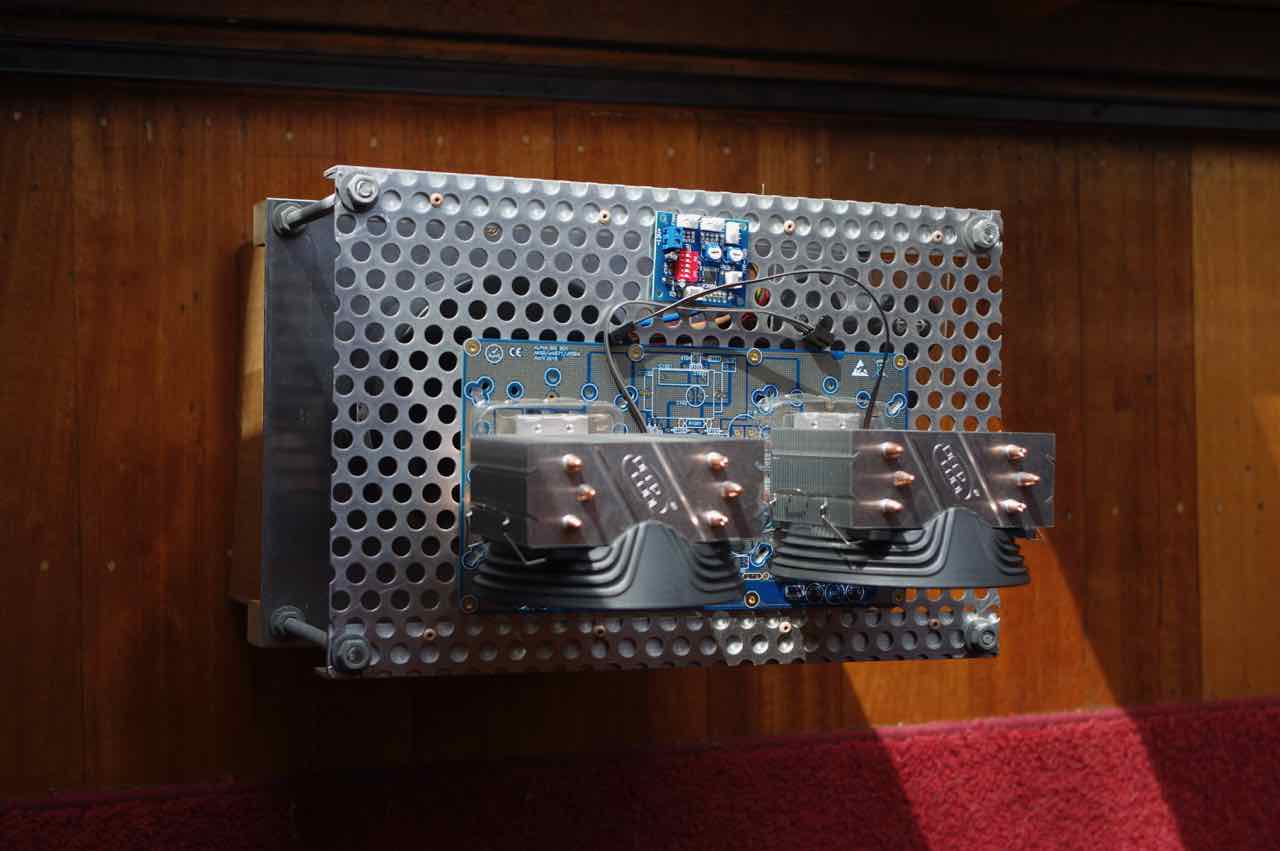

Weldings for first frame are just about done. Everything seems to fit inside, so now it's time to cut some aluminium plates inside. It really takes a lot of work to be done, but when alu sheets are cut, actual building can begin 🙂 summer vacation starts at second week of july, then I have more time to do this.
Juntuin,
Your case looks really awesome! I’ve started to plan a case of my own for the BB, but this amplifier is proving to be a challenge to fit all the necessary add-ons for a noise free and reliable class A monster. Your “multi level” idea is key for this amplifier not to take up a huge amount of shelf space.
Vunce
Vunce
Hi Vunce, and thanks. B. B. is a little bit of a challenge to get in case! Maybe X have a point, modified PC case could be way to go. I'm dying to see what kinda enclosures you guys end up with, since no one other has not shown their plans for B. B.? 🙂

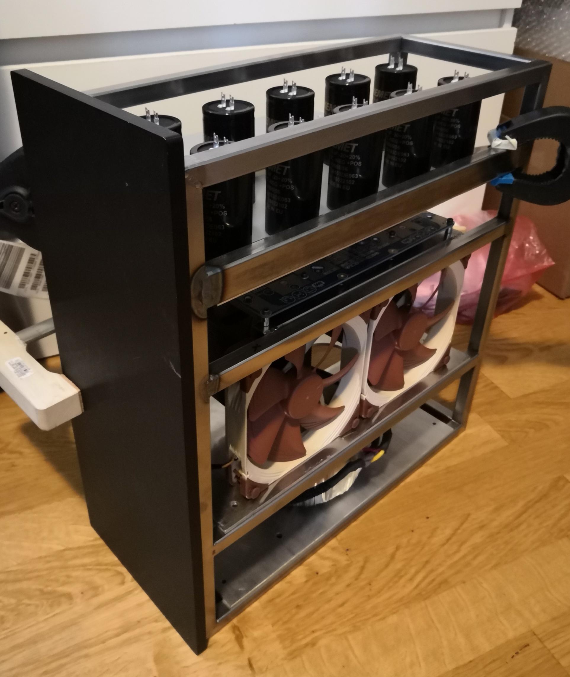

Here is where I'm at with my BB build at the layout stage.
Nowhere as Elegant as your build.
Steve.
I like it, industrial look! Like your idea about acrylic plate on top of caps. Dare to share details about psu, I see 10w resistors there so CRC or more R's or L' s? 🙂

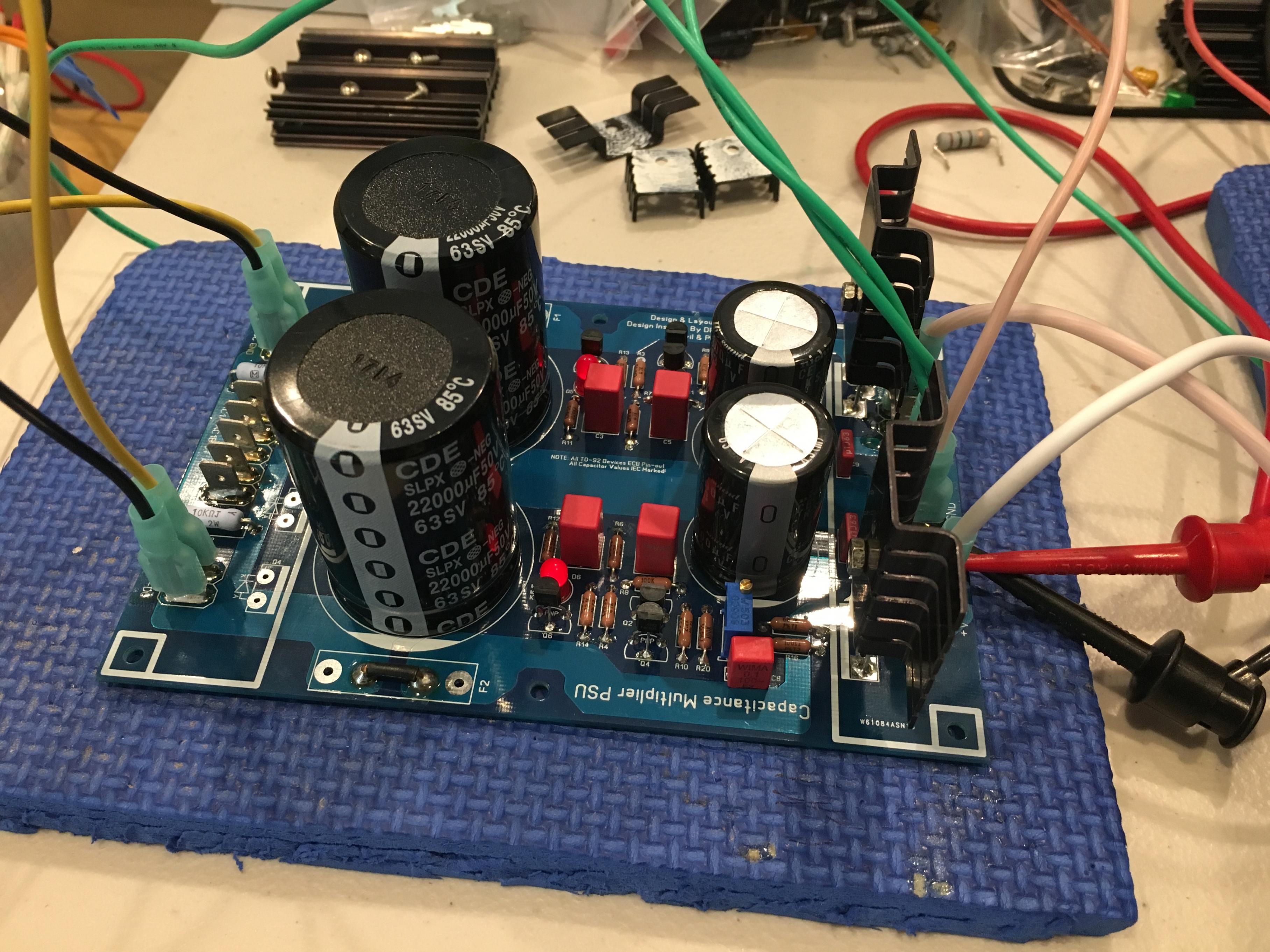

....and another psu to try with the Alpha BB.
I decided to try another capMx, this one is: Simplified MrEvil / PMI Capacitance Multiplier by Jason Kuetemann. I had very good results using the Allo CM board with my Big MoFo amplifier so, when I found out the Allo was a positive rail only copy of this circuit I decided to try the full version for my BB.
So far the results are much better than the first capMx I tried. I have it adjusted to drop only 1.5vdc and the heat generated from the MosFets is very manageable. The Wakefield 272 heatsinks are reading 55°C. Im using off-board bridge rectifiers instead of T0-220 on-board rectifiers which is a nice option this board incorporated.
Nice Vunce. Did you have boards made or did you get them way back when? I have the gerbers from the Simplified Dr. Evil thread and was thinking about having some boards made if there isn't a source already. Maybe others would be interested as well???
Thanks JW,
I had a small batch made up. I wish I knew about these earlier for my ALPHA20.
There is no doubt using these is very cost effective and a space saver compared to a CRCLC type psu. I just need more listening time to be convinced 🙂
