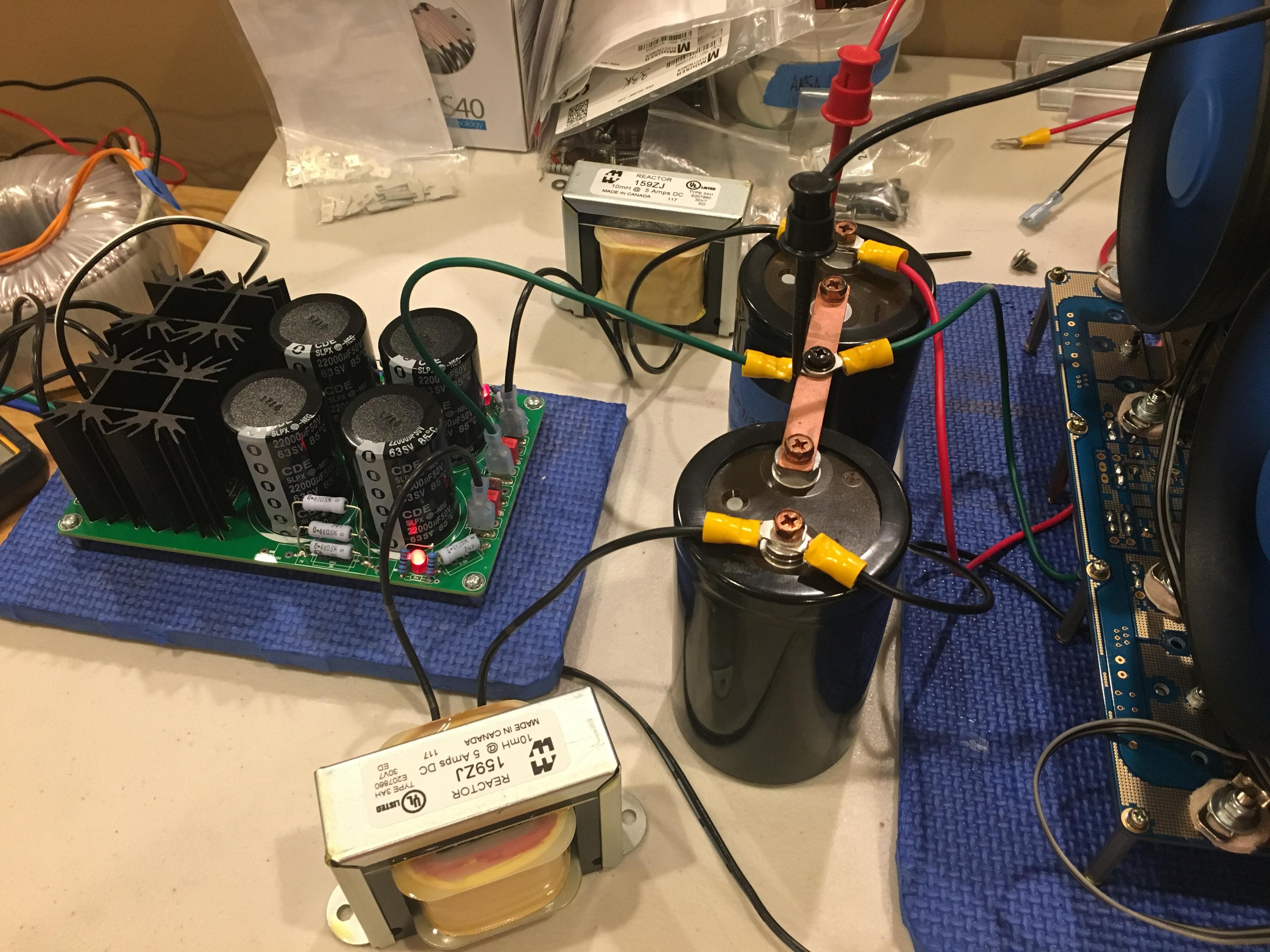

I’ve been playing around with a few different psu configurations for the Alpha BB and this CRCLC combo seems to be very good.
The trafo is 600va, 2x32vac,
R=3 paralleled .68r resistors,
L=Hammond 159ZJ,
C=22,000uF
38vdc loaded with Alpha BB
It’s extremely quiet, no noise at all from the speaker 🙂

Nice psu 🙂 I know benefits of adding L, but never tried it. Those 3 paralled resistors are 3watters? Does they get even warm?
Yes they do!! Too hot, I will eventually replace them with a single .22R big watt resistor 😀
I’m currently using a fan to keep them cool.

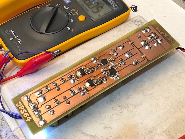

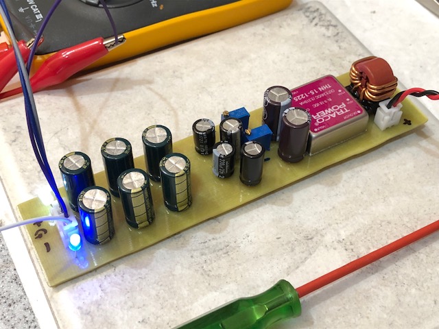

Thanks! I got to build all-SMT amps all day - that was fun actually. Mosfly practicing on smaller projects with new hot air SMT rework gun for a big epic 4 layer mixed analog/digital board for another project.
This is a new general purpose 8v to 18v input, isolated from dual +/-12v to +/-20v asymmetrically adjustable outputs with TI 4uV rms LDO regulators and slow ramp cap multipliers for up to 310mA for many smaller dual rail amps and preamps. Very compact and no wall mains needed anymore. JPS64 did the layout and I hand etched using a laser printer. First time using tiny (0.65mm pitch) leadless quad flat packs. Amazing that they worked with no solder bridges.
X,
Pretty cool projects you’ve got going on. I’ve been trolling 😀
Nice work!!
Thanks, Vunce! I just got a new hot air SMT soldering gun (more like a like pencil) and I have to say, it makes SMT soldering easier and higher quality.
