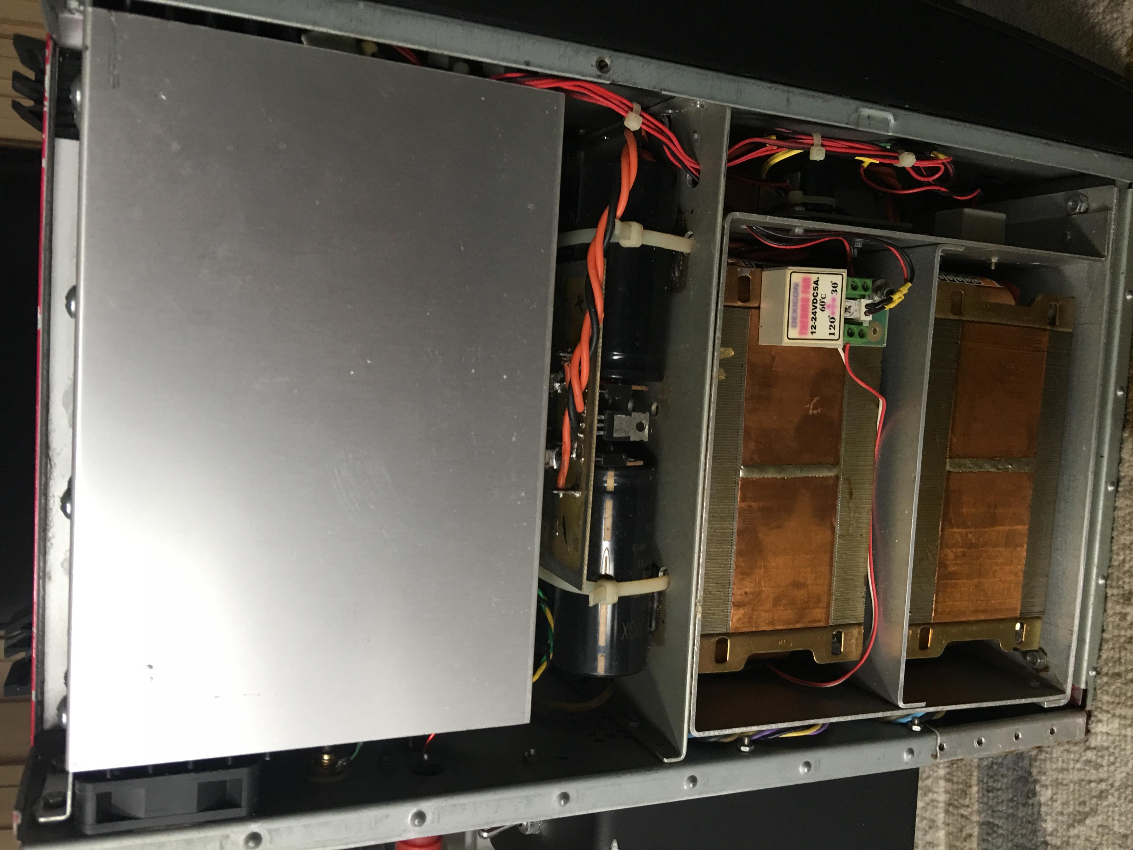

DC delay/protect is doing its job. No more cone movement at switch on.

Hi BRN. I bought a couple of these for a budget class D project a while back and still hadn't used them.
UPC1237 Dual Channel Speaker Protection Circuit Board DC 12-24V Boot Mute Delay | eBay
Thought I may as well give one a try finally. It's not perfect. There is still a small pop, but it's no where near the cone excursion I had before. I still need to measure DC at switch on to see when the relay trips. No too worried about it though. There are a few different boards on eBay. I've also been eyeing the diyAudio store boards. I need to read up on those.

I have the exact same one, I think there is a thread discussion how to mod it, actually I think it may be my thread even 🙂 you can change the RC values to get a longer delay. It is 3sec but maybe 5 is needed? Many folks use this one and they suggest changing the critical capmom time delay to a polyfilm to ensure reliability.

Please, first try to do an A/B test so you have some idea how much it degrades the sound in case...
If too much involvement just not worth to modify etc, you may have to look for other solution.

The cheap relays may be an issue - but I think a quality OMRON can be exchanged easily. I have not hooked up to mine yet so can't say. The big cone excursion is handled by my speaker ok so for me, not worth the potential degradation in sound with a relay contact. SS MOSFET relays are the way to go as they handle huge currents. Several designs floating around.
In my case the el cheapo delay/protect board is temporary until I can source/build something better. I couldn't, in good conscience, keep subjecting my drivers to 12.5vdc every time I switched on the amplifier.

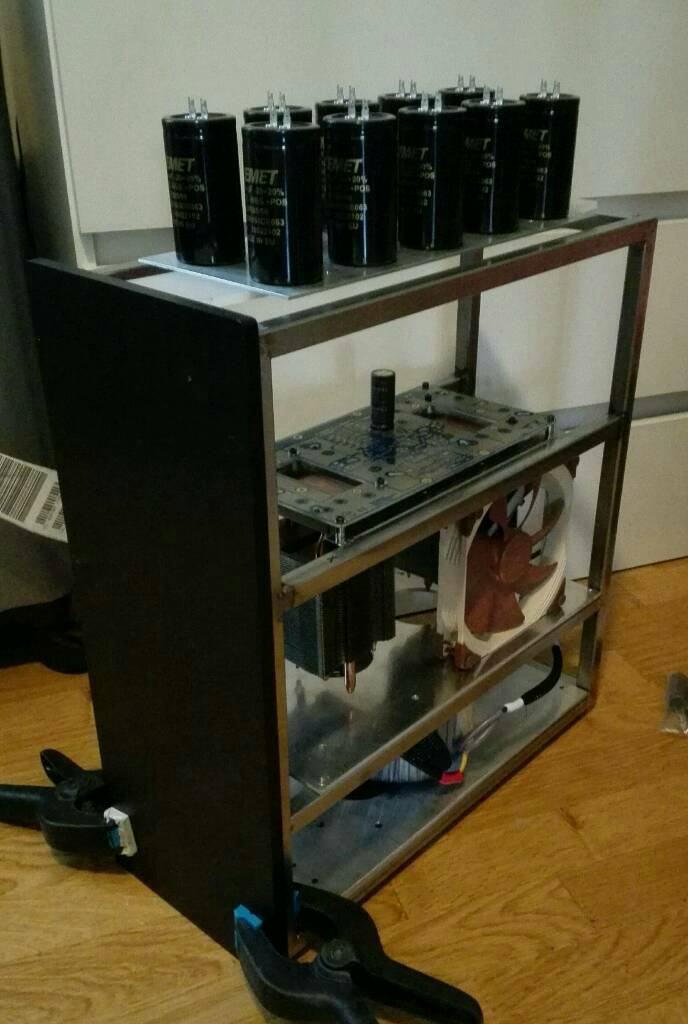

Mine are not so ready yet 😀 proto frame building up, don't know where to fit all those caps..I may have to place those pcb's high Silmics on the "wrong" side of pcb to get some more space inside.

Very nice looking Alpha Tower you have there Juntuin. So monoblock towers each wth 2 fans and massive capacitor bank.
Juntuin,
Your ALPHA B.B. frame is looking good... the case should be pretty impressive when finished. Look forward to more pics and build updates!

Where have i seen those caps before!!!:
Your way ahead of me on the BB build i like the multi level idea.

Brilliant work...... I love it!
This will consume a lot of electricity, but at least in Finland you can warm the room very nicely. I have a 1Kw electric heater sitting 30cms from my seat as I sit at my PC in cold southern Australia; maybe I should do a BB too, I have the pcbs and the mosfets!

Thank you guys, you are too nice 😱
Just like X said, monoblocks, 2 fans per case. It's really time consuming to build like this, but I have a good feeling what will become!

Those Wtl's findings are Kemet 15000uF 63v from Mouser 🙂

If there is 5mm air gap between capacitor poles and aluminium case cover, is that enough? I won't build anything where is risk of getting shocked, that's why asking. Should I add some thin cover of non-conductive material between alu cover and capacitor poles??
