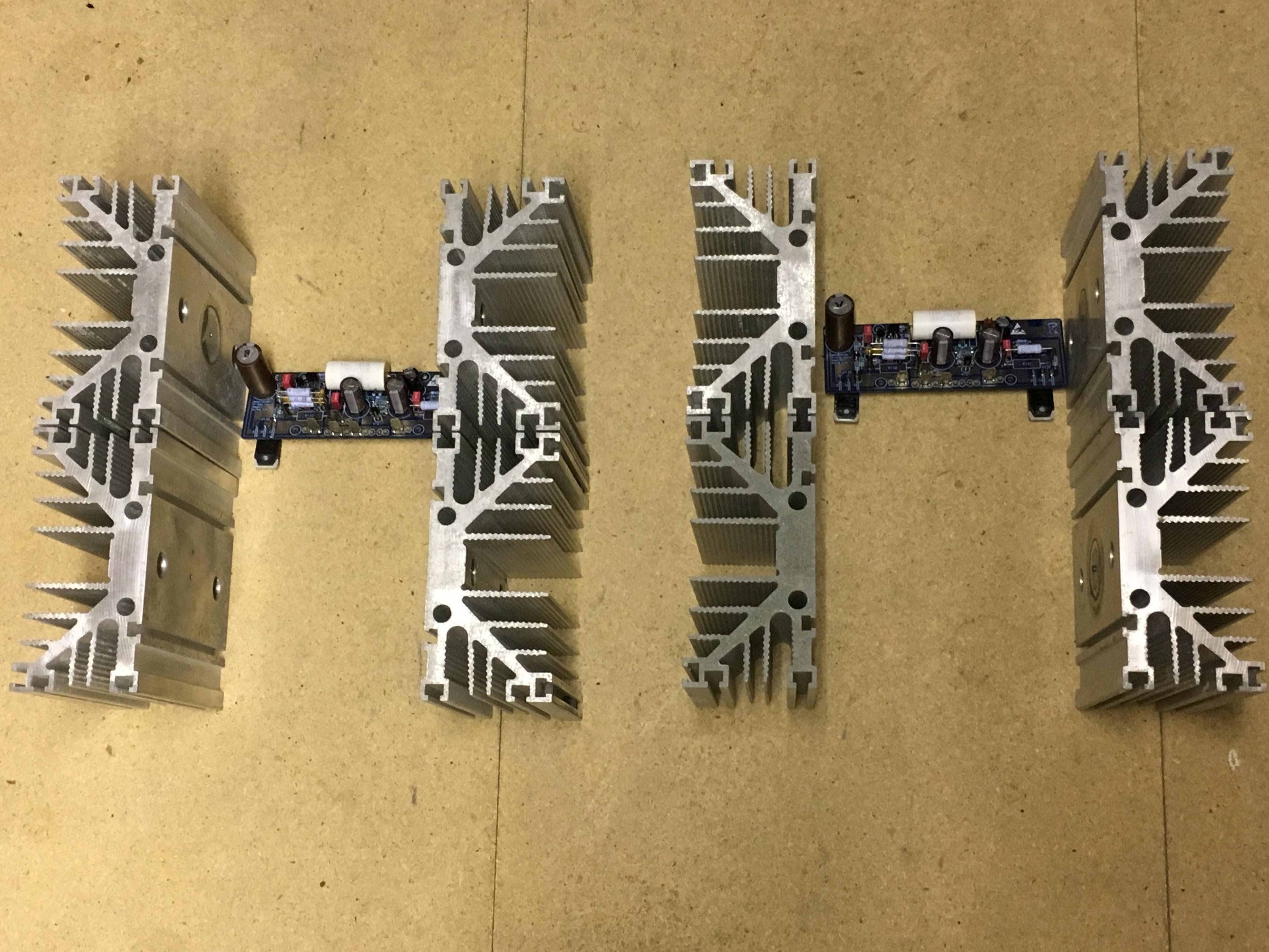

Hi, back from holidays so will have to get going again with the Alpha.
After lots of experimenting with heat sinking, both passive and fan assisted, I decided to go the passive route . I decided on a mono block construction to try to avoid large size and weight. The plan is to mount the Alpha PCB at right angles between the heat sinks that will form the sides. Due to the height of the sinks,150mm, I am thinking transformer, rectifier, capacitors etc. on the base and then an aluminium sub floor with the Alpha above. I think this will give good protection from any noise radiated from the toroid.The outside dimensions will be 300 x 300 x 150.
The heatsinks I have are not new and require cleaning, also some milling to accommodate the bottom and top cover.I don't yet know wheather to have them anodised a different colour (depends on cost ).

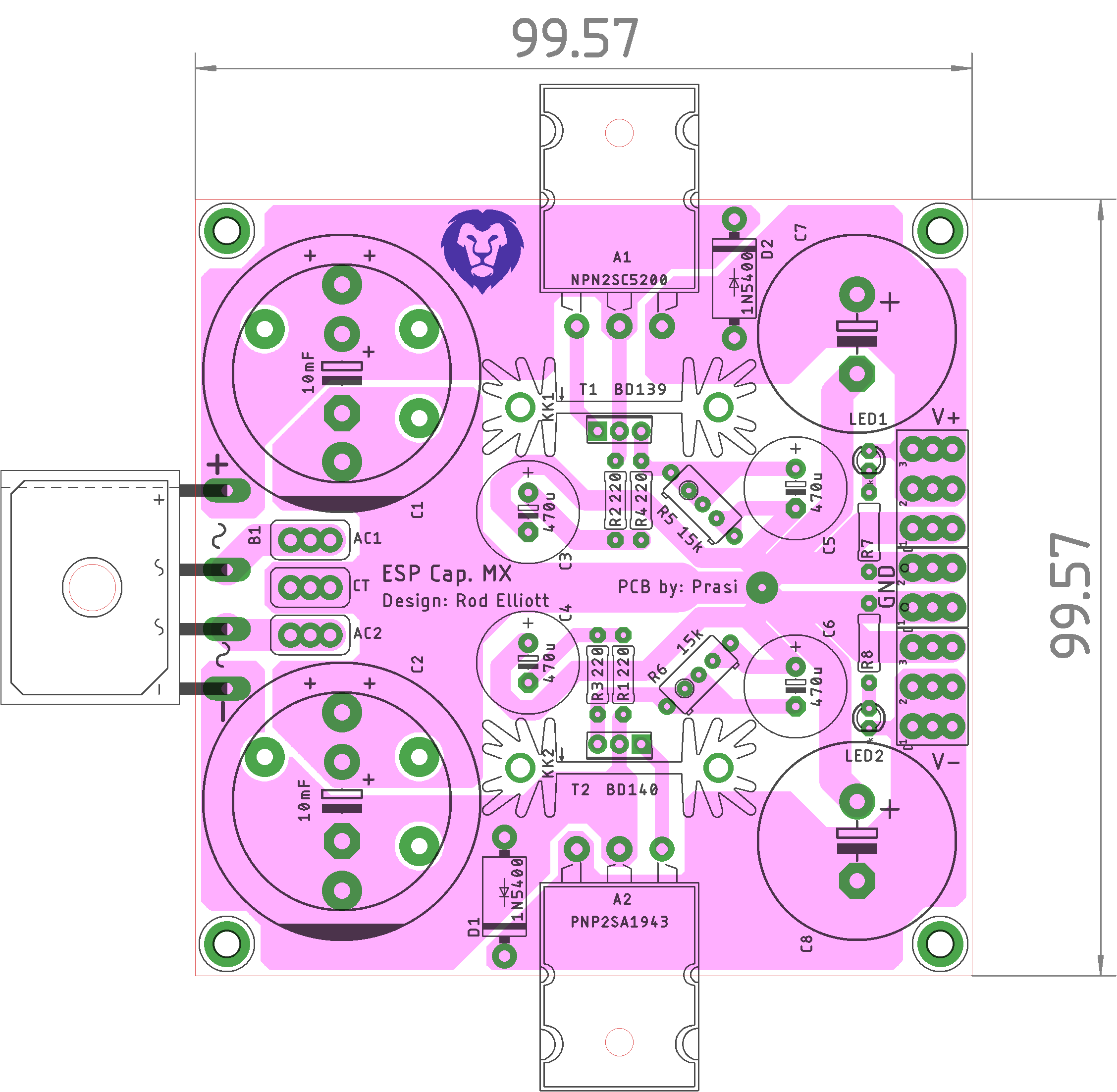

Rds on mosfet datasheet sets voltagedrop Evil capmx, plus what you add for various reasons, for example you want rails equal or unequal (rds on difference positive rail Pmos and negative rail Nmos), or for example you have 500mv ripple prior to capmx that you should add to voltage drop capmx with trimmer, for capmx not to dropout. It is in that thread also 4700uF output cap is equal to 100uF outputcap according to MrEvil, if I remember correctly and the 100nF bypass cap over outputcap increases outputripple, doesn't decrease, so deteriorates output, doesn't improve output. (Kneteman??? and Allo do have that bypasscap on pcb and both populate position, but Kneteman??? also mentioned he measured deterioration, so maybe he removed part again for pcb he uses?
Can anyone confirm if the Mr Evil cap Mx ha a lower drop out voltage and hence, less heat? I am looking into a circuit designed by Keantoken for a low dropout soft start and cap Mx. Hopefully around 0.6v to 1.2v dropout.
from memory, you had built esp cap mx and not too satisfied with results. I don't know if that would be suitable here.
since ESP doesn't sell PCB for the cap mx, I wonder if I am allowed post a design here. If not, request mods to delete the post.
ESP suggests to build it p-2-p as its very simple one.

Where do you guys get those heatsinks?
We would all like to know. Apparently from eBay but what model number to search for etc? IIRC, from MoFo thread, Michael Rothatcher said they are available new from Mouser etc but price is rather high.
hello keantoken,
something similar available in India. These are probably very old designs that were specifically meant for TO-3 as I see such heatsinks on the back of many industrial equipment.
I Purchased these heat sinks for my MoFo from this eBay seller:
Large Reclaimed Extruded Aluminum Heatsink 11"x6.75"x3.1" Audio Amp Heavy Weight | eBay
Vunce

Newark link:
http://www.newark.com/aavid-thermalloy/db120-20/heat-sink/dp/10WX1014
Quite expensive.
Thanks for the welcome X, grandchildren loved Disney Orlando, a very special place but quite tiring for an old chap like me but wouldn't have missed the wonderment in their faces for the world.
I was fortunate enough to acquire the heatsinks from low voltage high current rectifier cabinets that were being scrapped. They were used for depositing copper on cylinders for the gravure printing industry. Due to the hostile environment they were used in there is some corrosion on them, so quite a bit of cleaning up to do. If that works out well I will see how much the cost is to have them anodised. Two linked together with copper plate will I think be more than ample for each FET.

heatsink passive
https://www.fischerelektronik.de/home/
black anonized. Many profiles .
BTW got my stereo set almost complete , 2 channel is slightly better, on oscope.
From my exp. fischer does very good heatsinks.
I need some help though can someone explain a sk56 base 10mm vs diy audio 8mm base heatsink
°C/W
300 x 40 x 120 0.40 °C/W diyaudio
300 x 40 x 165 0.31 °C/W diyaudio
300 x 40 x 210 0.18 °C/W diyaudio
fischer sk56 300 x 40 x 100 0.4°C/W
sk56 300 x 40 x 200 0.3 °C/W
