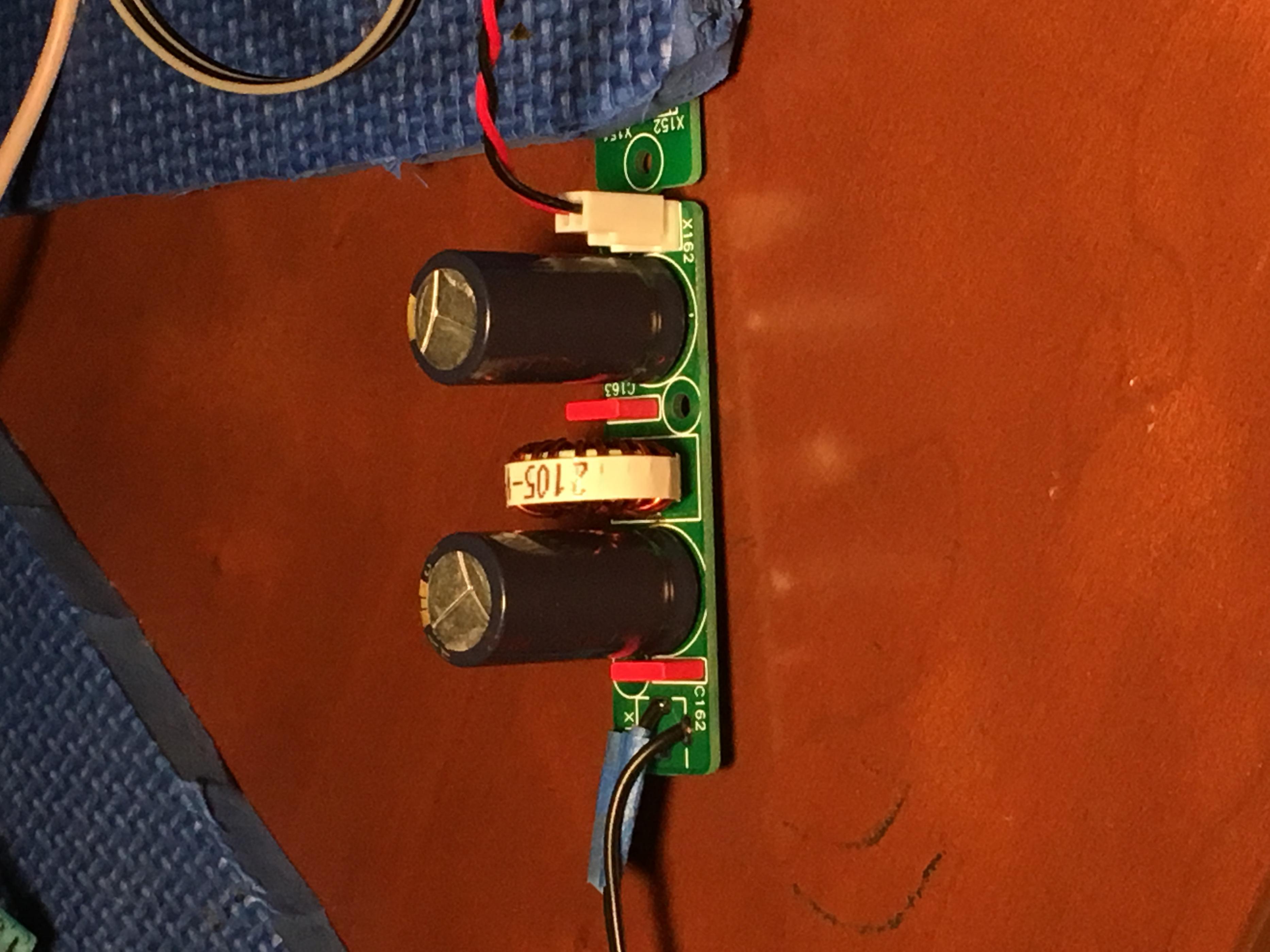

I also put the Fo-Felix EMI Filter for AC mains 120/230v; By Folsom, into the mix. I am pleased to say that this filter eliminated almost all the “extra” noises/buzzing I was hearing close to the speaker.

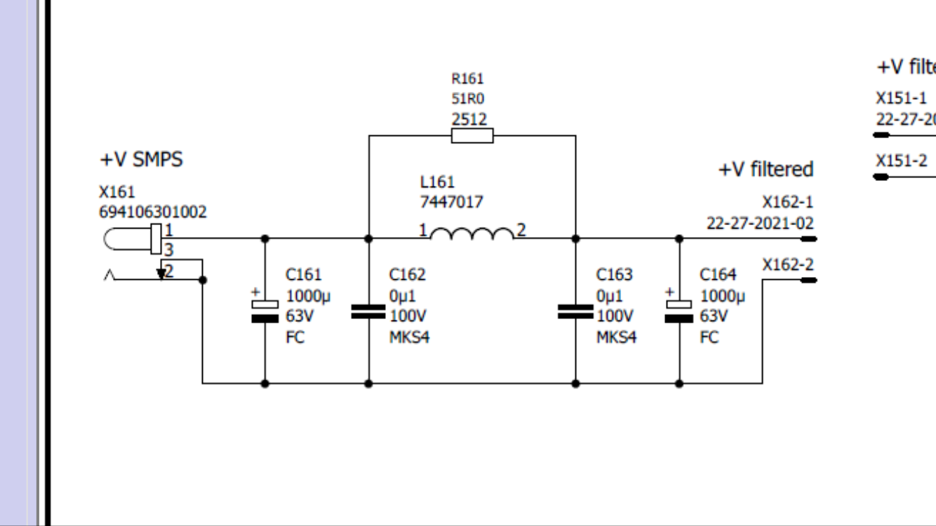

I kept investigating and found that the “extra” noise stopped when the fans were turned off. After a conversation with X, I installed a CLC filter I had from the AKSA Lender Preamp between the wallwart psu and the PWM fan controller. This combination worked very well to quiet the remaining “noise” I was hearing.
Nice result, Vunce. I noticed that JPS64 adds these CLC’s upstream of any pulsed digital system such as DC-DC or PWM modules. It seems to do the trick here doesn’t it? What’s odd is the Fo-Felix did not stop this from coming up from the mains.
JPS64 has the right idea, it worked for my setup.
The Fo-Felix is filtering the mains for the Alpha BB only, the psu for the PWM controller and fans is not connected to the Fo-Felix.
