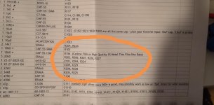

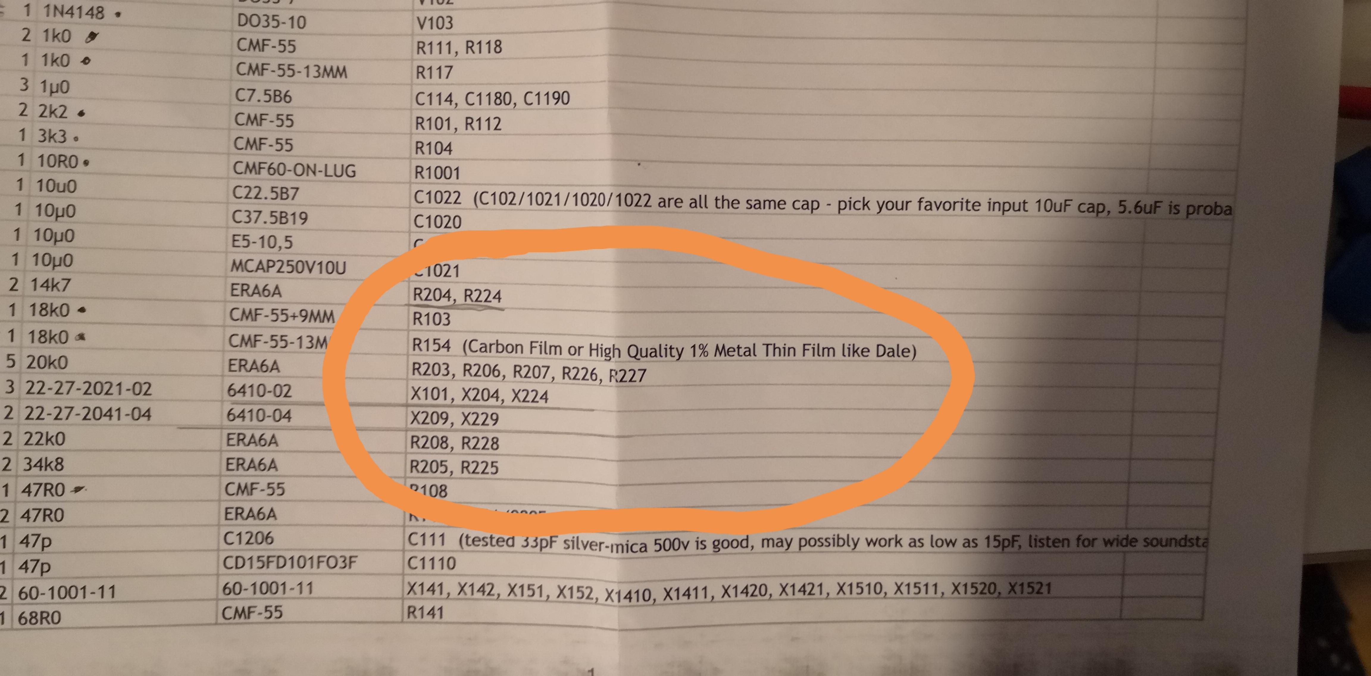

Did some soldering tonight, have to ask what those resistors marked in bom as R20x and R22x supposed to be 🙂?
The BOM for B.B. v2 is in the other thread:
http://www.diyaudio.com/forums/atta...aleph-alpha-amplifier-alpha-bb_bom-v2-xls-zip
I could not find any R20x or R22x in that spreadsheet. Can you sho wow where?
X
Juntuin,
I believe those parts are for the additional circuitry for those fan control boards. You do not have to populate that stuff now to get the alpha amplifier board to work.
The only SMD components you need are the snubber resistors and capacitors for the output MOSFETs.
Yes, those were supposed to be part of the PWM fan controller board that JPS64 designed. I forgot to move them down to rest of stuff associated with the fan controller.

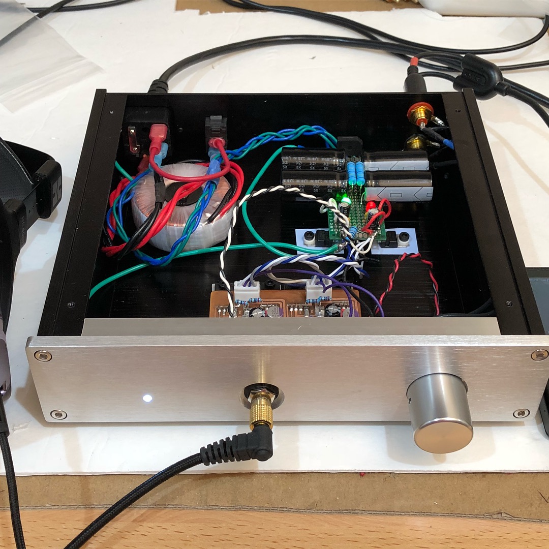

Here was my measurement of the prototype with the new ultralow noise psu. You can see the noise floor has very short "grass" - as low as a battery, and this is running off 120vac mains.
Simple High Performance DC Coupled Class A HPA with sub PPM THD
This was with my hand-etched prototype.
Of course, JPS64 is on the case and is developing an uber-special version of this HPA with built in 4uV rms dual rail power supply that only needs a 12v wall wart for power.

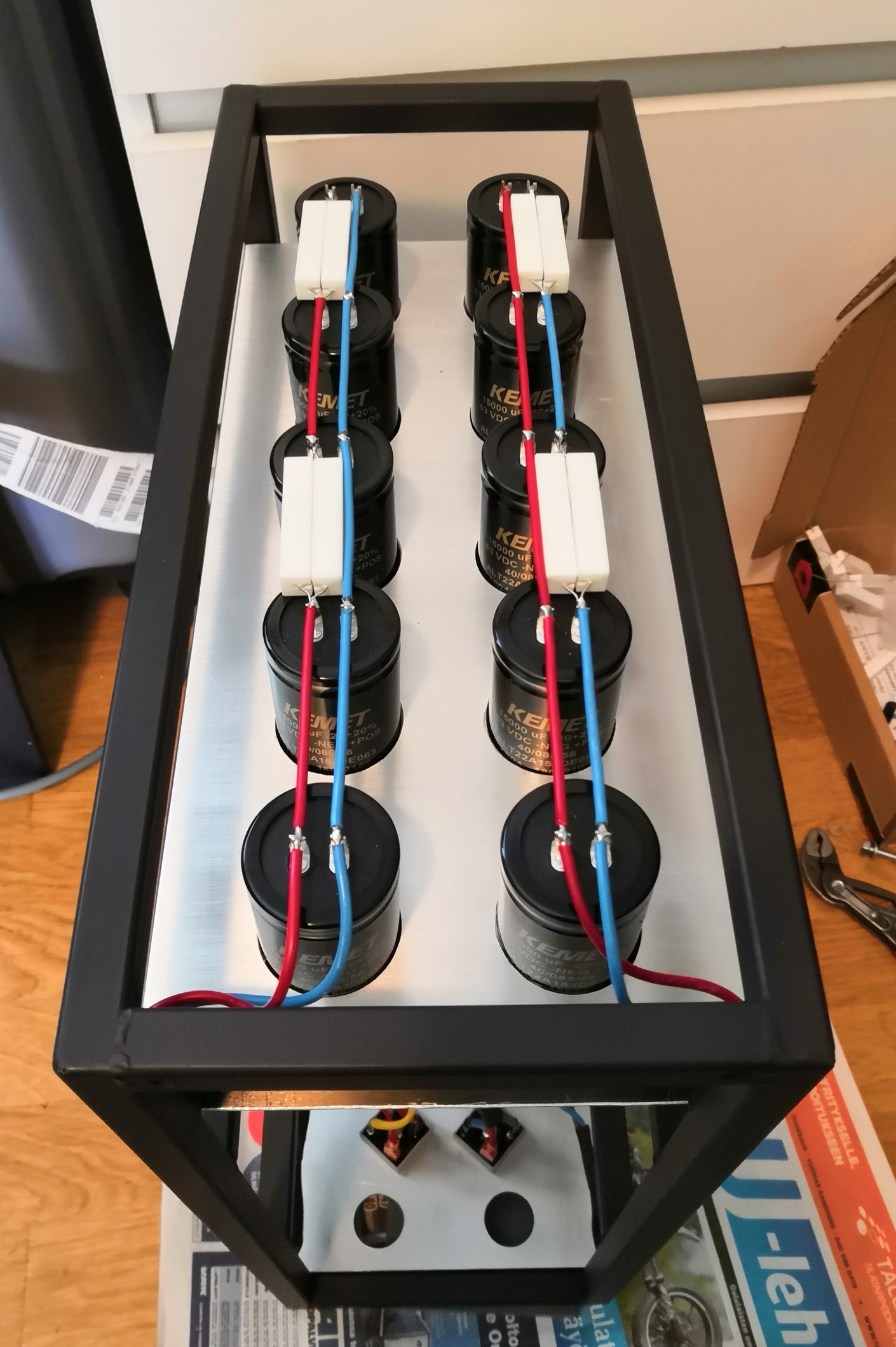

Powered up PSU couple of minutes ago, added 2,2k bleeders before that. +/-44,6v without load, that's a little more than I hoped but let's see where it sags under load.
Nice progress Juntuin!
I get about 43.5vdc without load, 37.5vdc with the BB connected. I’m good with the slightly higher voltage, heat is not an issue. You could increase your resistors a bit to lower the output or add another resistor between your paralleled C’s. (CCRCRCRC)

Ok, maybe B.B. can handle my extra 1,1v 🙂 I will use my fans at full 12v, they are so silent and I'm not using any PWM controlling on this one.

Terrific work! I like the fans bottom, amp above, power supply caps above that. Very elegant, almost like a guitar amp case.
With 37.5V supply you should get about 55W out of the BB. It will clip first on the negative rail, around -30V. This is 56W, impressive for a Class A. I'm amazed that the fans make no noise even at full tilt!

Yes, it is a nice amplifier, I wish I could have the possibility to build something like that. Unfortunately, I can not do that while I live in an apartment on the kitchen table neither on the balcony. If you would accept an advice please Try to use as short and thick wires as possible especially between you PC boards and the capacitor banks. If is too far away because of the construction maybe use an extra pair high-quality caps just before your PC boards, like a pair M Lithic. Mr. Pass always advised us at DIY Aleph amps thick and short wired as possible. If you can do that a par extra caps like 10 000uF close to you PC boards.
