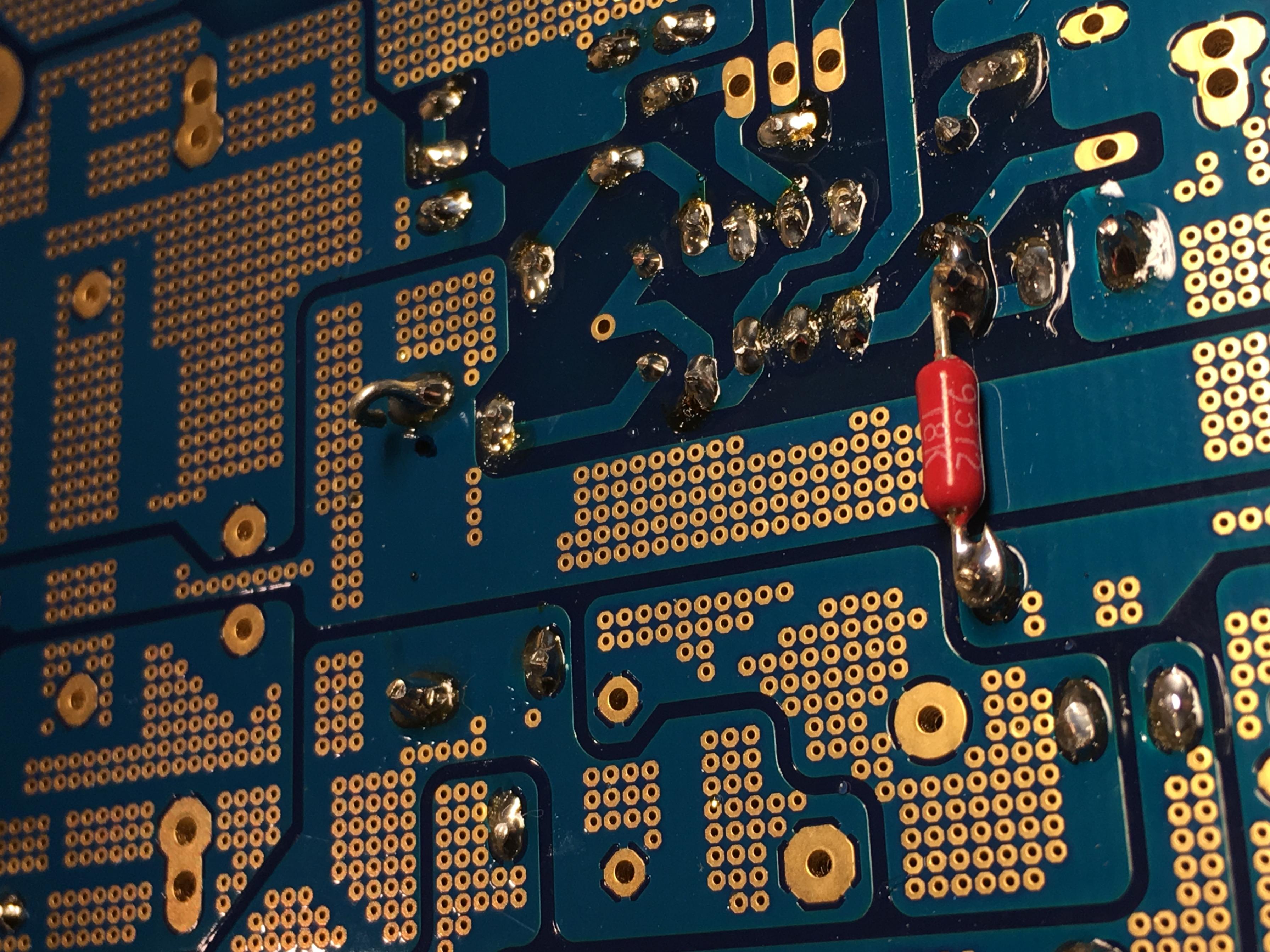

In preparation for that mod, I left the one leg of the 10R resistor long and bent it into a loop under the board to make a solid anchor point for the C104 GND wire 😉
And don't forget to put insulating washers or Kapton tape on the board underneath where the nut/washer goes to mount the CPU coolers. The exposed vias are sometimes connected to the rails or the output there. CPU cooler will typically be at ground potential.
Look in photo below and see where I put the tape 92 layers) underneath the washers.

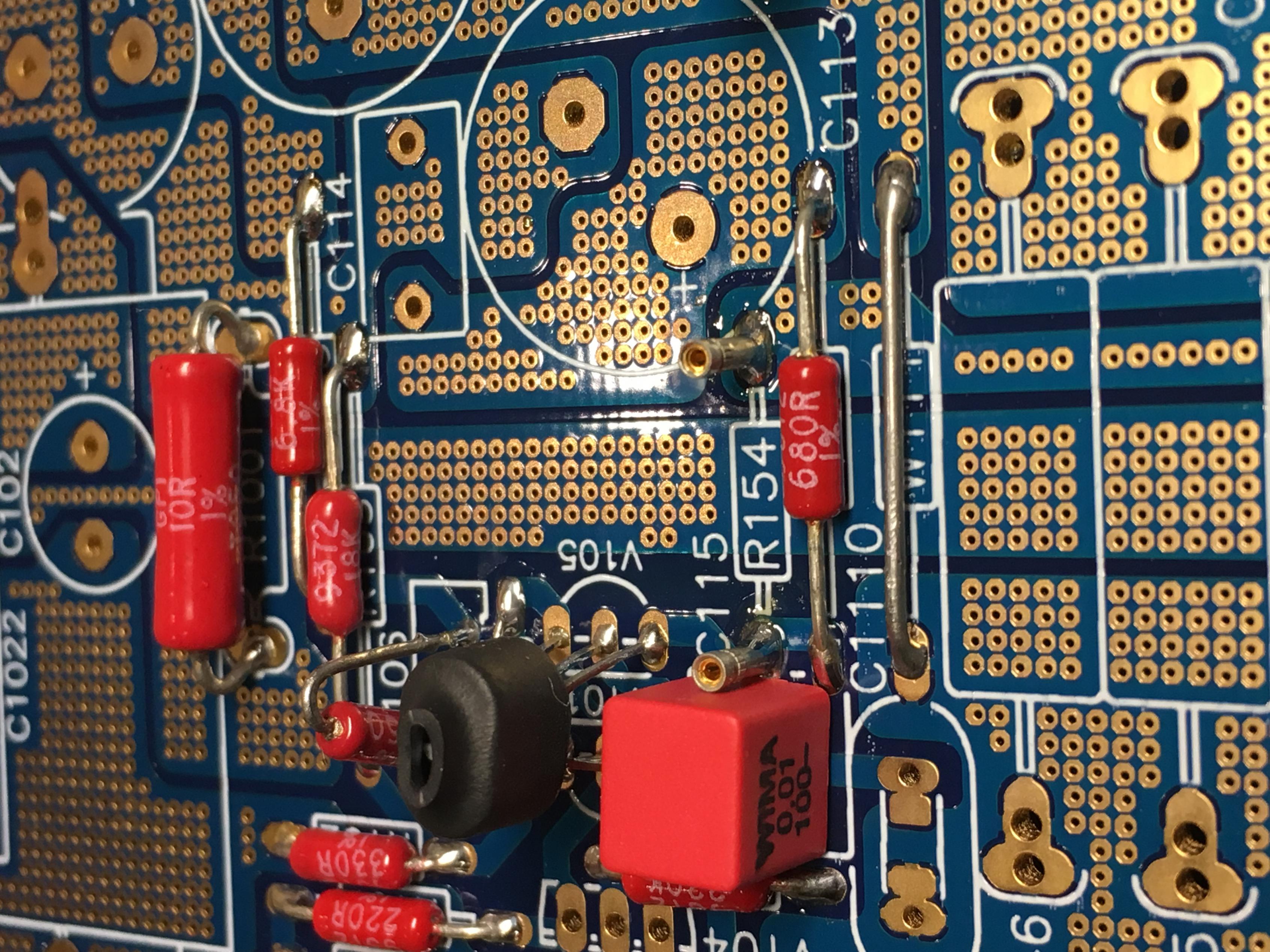

From the start, I’m leaving C111 empty and installed sockets at R154 for easy experimenting with different capacitor values. In the picture you can see the 18K resistor soldered underneath. Also visible is the small loop for the C104 GND to power GND modification (not required for the April BB version).

I too like the PRP and Takman resistors. In a few of my last builds, I've used mostly just Takman Metal.

Don't you connect all components for the 10r directly to powerground when you have soldered loop/eye on that plane/pc trace ?
