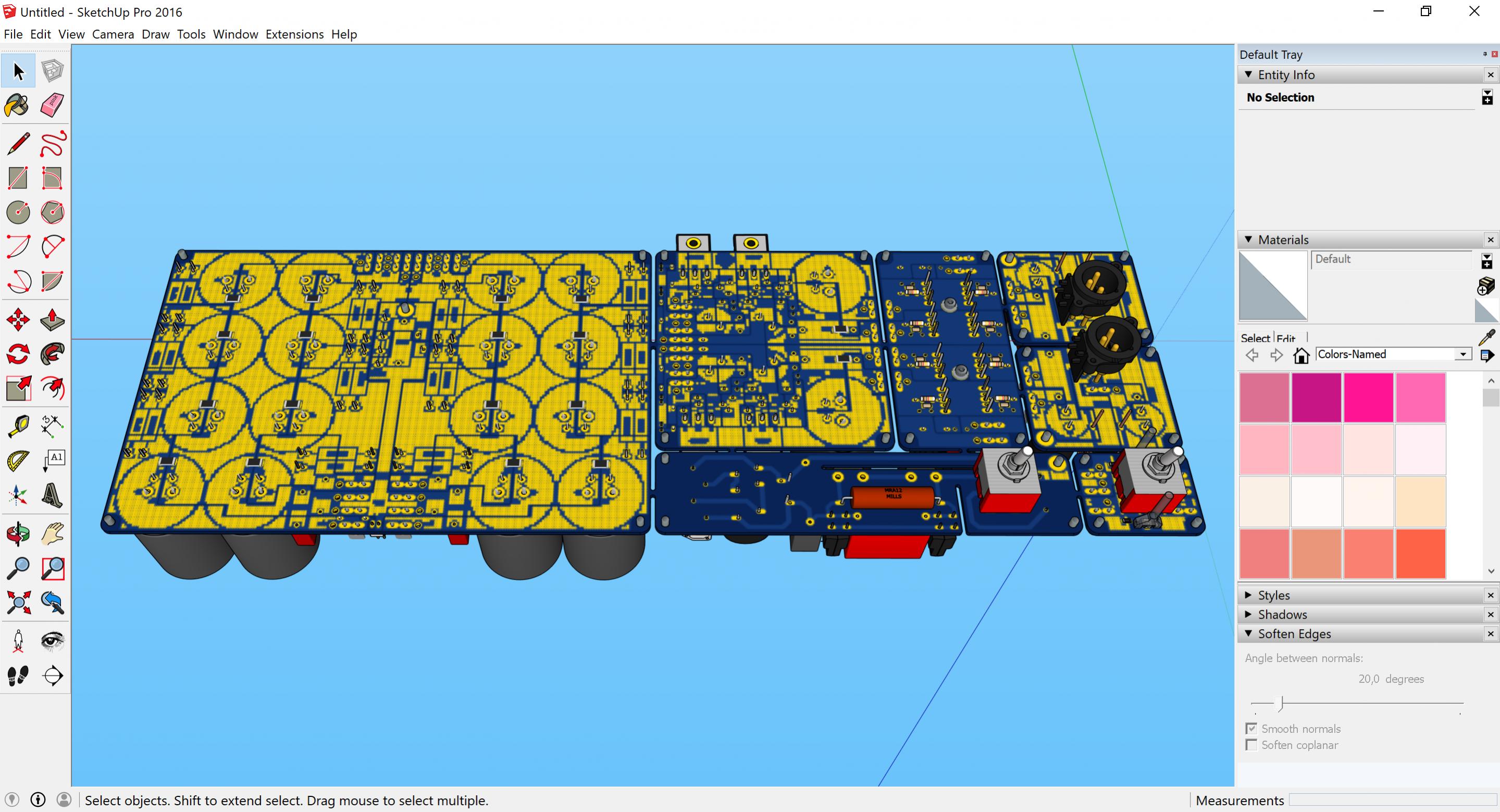

Elegant JP!
Thank you for such professional designs and layouts.

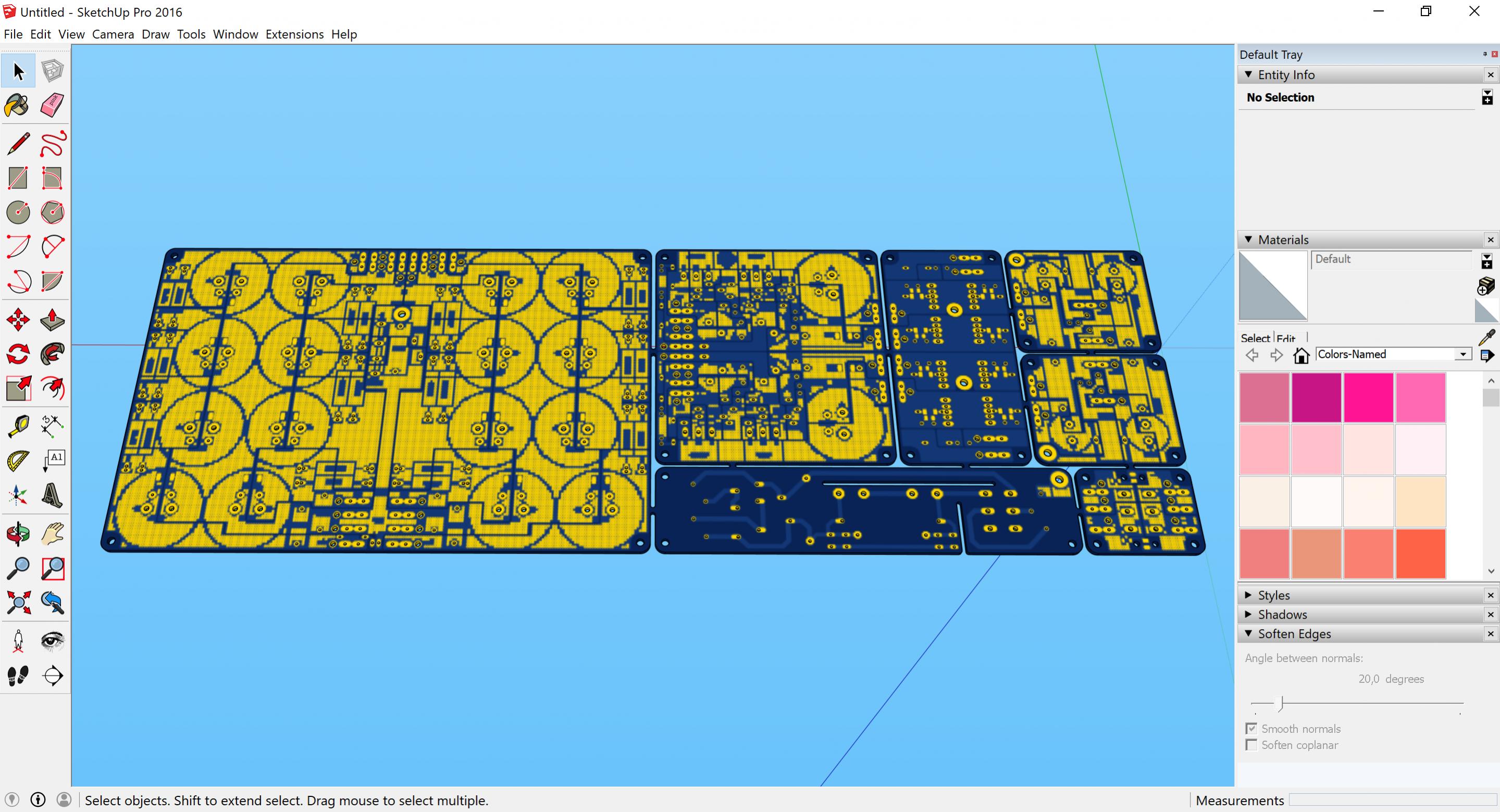

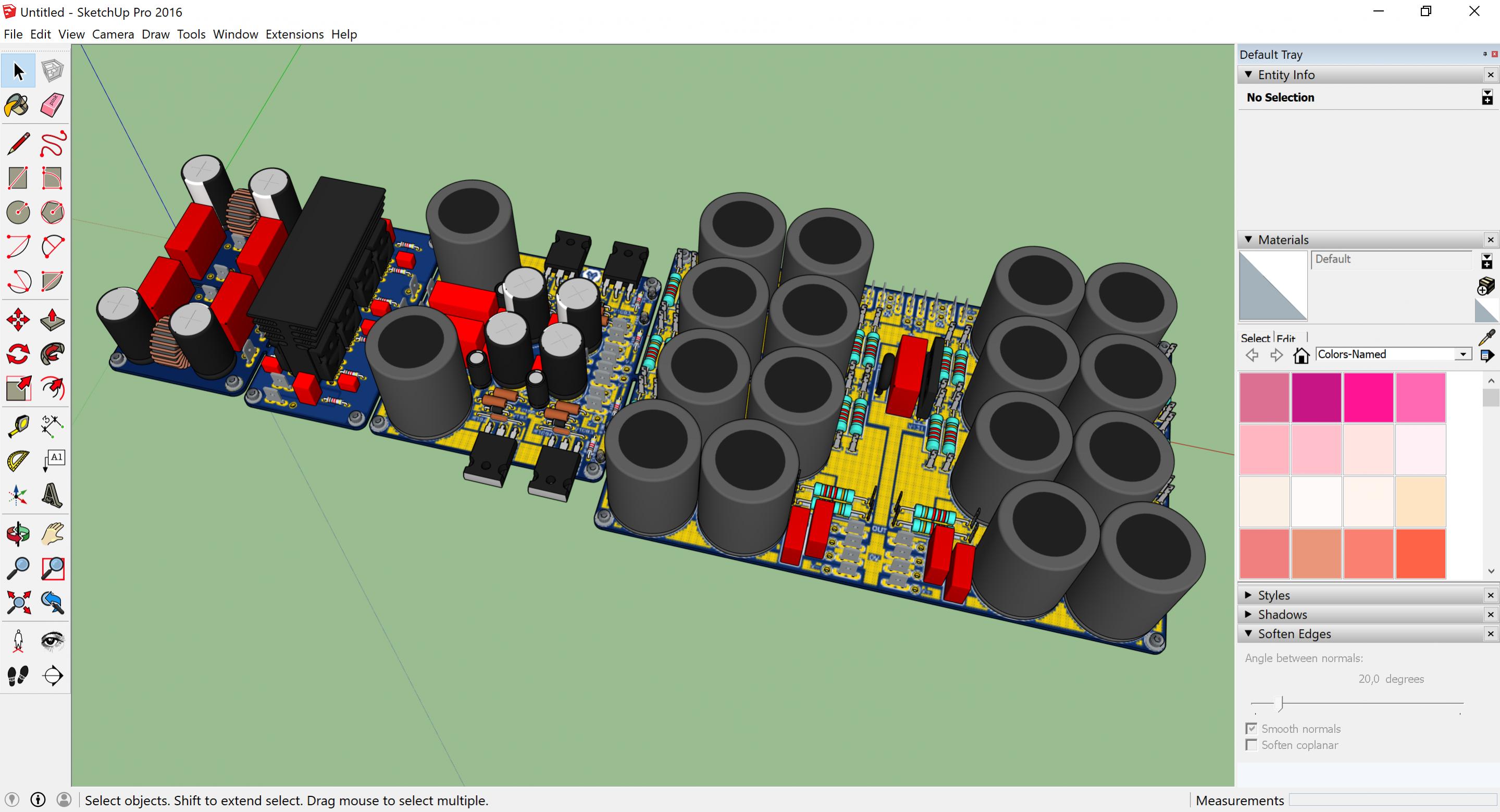

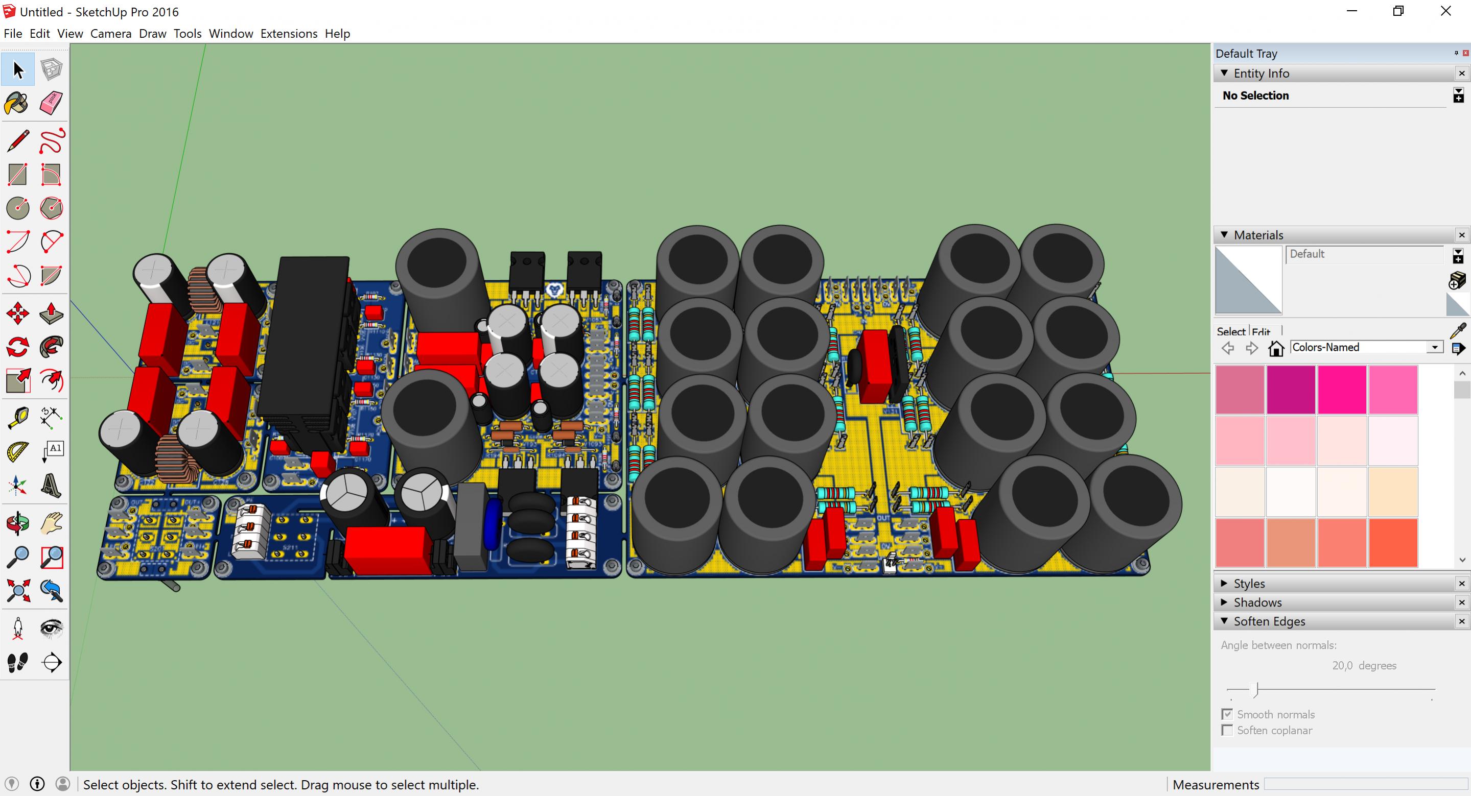

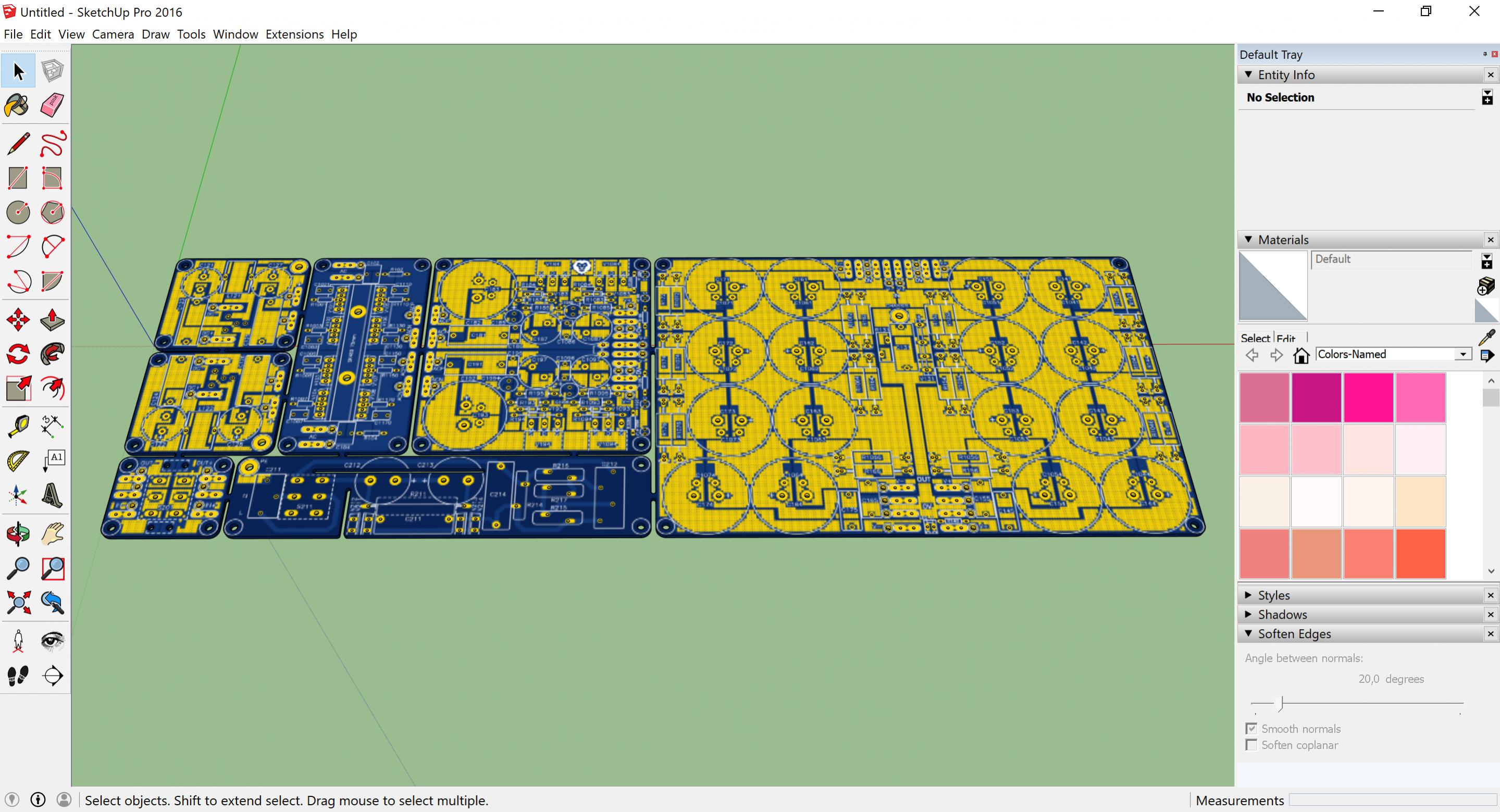

Nice work JPS64. I think the boards need to be separate otherwise cost to make is very high. They charge for multiple projects if they see it’s not all one circuit. Can you explain what the features are of the first two boards on the left?

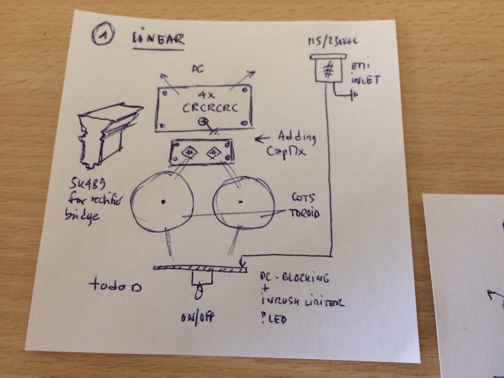

This boards allows two configurations:
- to build a linear supply
- or a SMPS supply
For the moment the bards are the following:
- two CLC EMI filter input boards (using faston or XLR)
- one dual rectifier bridges (TO247/220 SK489 mounted)
- one @Prasi/JUMA CAPMx board
- one dual+/-V CRCRCRC board
And central GROUND to CHASSIS over NTC, capacitor and rectifier on the CRCRCRC board.
I´ll add two additional boards with rocker switch one for DC use (SPMS) and one for AC use (linear) to be mounted on the front plate.
@X, after checking, no additional costs for panel! Perhaps ordering unity boaards, I don´t know for the moment.
JP

I can see a DC blocking and inrush limiter. Schemes?
If you add an earth loop breaker and RF/EMI filter it will have more functionalities than the vast majority of poweramps, DIY or expensive audiophile poweramp!
Prasi/Juma capmx didn't work either Vunce or me, it seems to oscillate atleast with class-a amp?
It was designed for typical “Pass” Class A designs at 1.25amp. It worked fine on my Class AB amps and small Class A (under 500mA) but I also noticed oscillation or noise added on Alpha at 1.35amps. There may be some adjustments to the on-board snubber needed. Or even a snubber between the drain and gate?

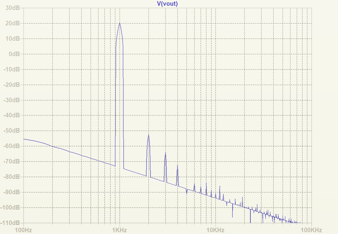

I have been exploring making a very powerful headphone amp with an Alpha. Looks like with some adjustments to the resistor setpoints I can get 144mA bias at +/-25v for only 6w dissipation per channel. This can drive 50ohm headphones to 2.25wrms (30vpp). Some very low sensitivity planars need this kind of drive. At full power of 2.25wrms the THD is still only 0.025% with a good harmonic profile.
