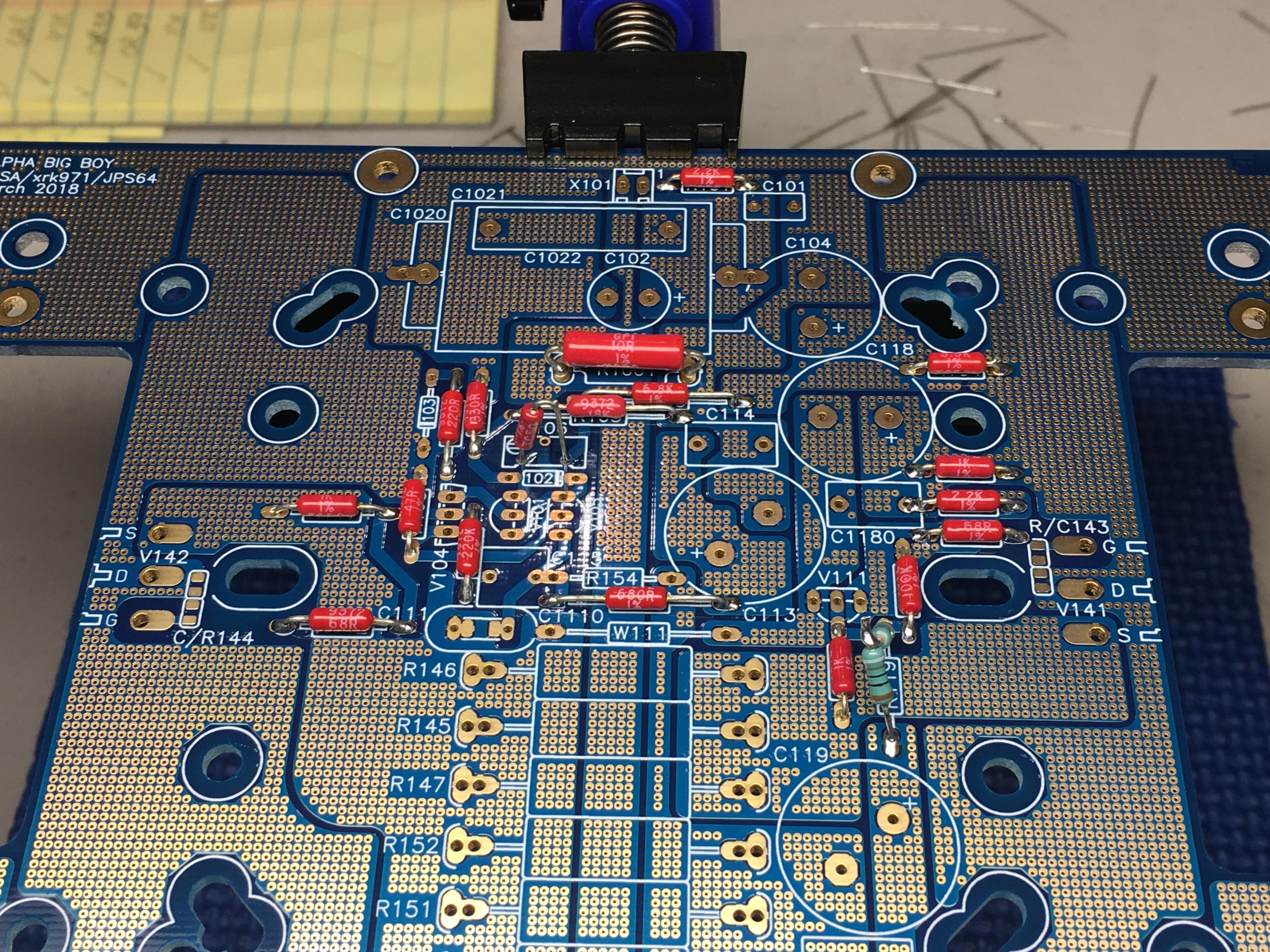

Very nice JPS64! Which PCB manufacturer were you able to get a quote to make a multi-layout board for same price as single? Both JLCPCB and PCBway would not make even Aksa Lender Preamp without charging extra for the 3 extra mini-boards (input selector, CLC, power switch).
Hi X,
you´ve to order panels: panelization done by manufacturer is cost expensive.
PCBWay considere this monster board as panel so no additional costs.
JP

Nice!! Those are premium resistors there, man. Taka-whatchamacallit brand? 🙂

Haha!! PRP and Takman.
X, Soccer is Sunday🙂
Actually, these resistors are only a bit more $ than the ‘brown sausage’ type.
Blood red sausages are just so much more appealing for some reason😀
I did find a small drop in THD when switching from Chinese steel leaded metal thin films to to the Dale brown sausages.

I like PRP, but Takman to me are such a great combination of value and quality. Between 1% Dale CMFs, 1% PRPs, and 1% Takmans I honestly can likely barely tell any difference, but to my ears I like the Takmans a tiny bit better.
They're all really good IMO.

Vunce,
That’s the B.B. v1 (March). Don’t forget to connect GND of C104 to P GND without the 10R ground lift. The v2 board has that fixed.

I will be glad to drop a set in the mail for you Hugh.
Vunce,
Thanks for the reminder X.
In preparation for that mod, I left the one leg of the 10R resistor long and bent it into a loop under the board to make a solid anchor point for the C104 GND wire 😉
