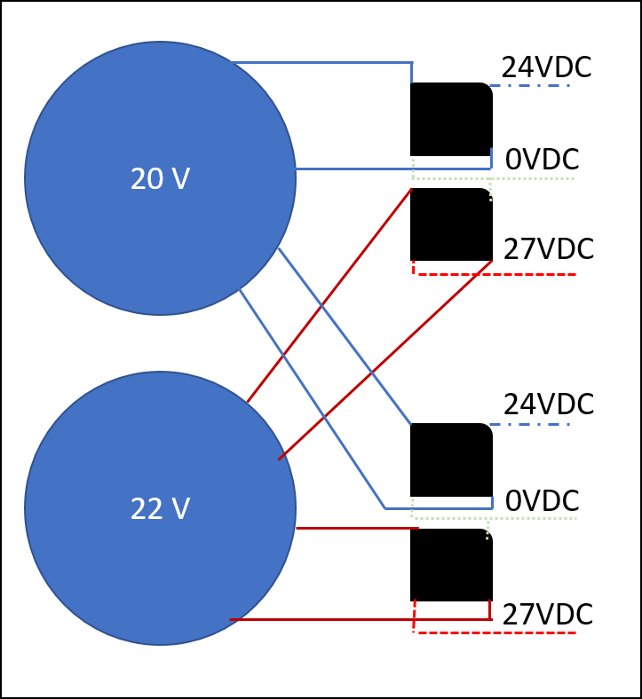

How would you guys like a 25w Alpha amp? Hugh’s latest studies show that using two trafos, one for 24vdc rail and one for -27vdc, and having each trafo feed two amps but opposite rails lowers the negative clip point to essentially make the Alpha a 25w amp. No extra cost if you had planned on getting two trafos to start.
So even if you have one all running now, simple addition of another 22vac trafo (for -27vdc after sag) will boost power and give more headroom.
What would the power supply look like? Would you need two power supplies?
Brad,
No change to existing supply. Just one trafo with 20Vac secondaries, one winding to positive rail one channel and the other winding to the positive rail other channel. The second trafo would have 22Vac secondaries, with one winding to negative rail of channel ONE and the other winding to negative rail of channel TWO.
No changes. No additional parts or cost. Just two different trafos. You go up from 19W to 25W, and increase of 31% for peanuts.
Hugh
Hugh

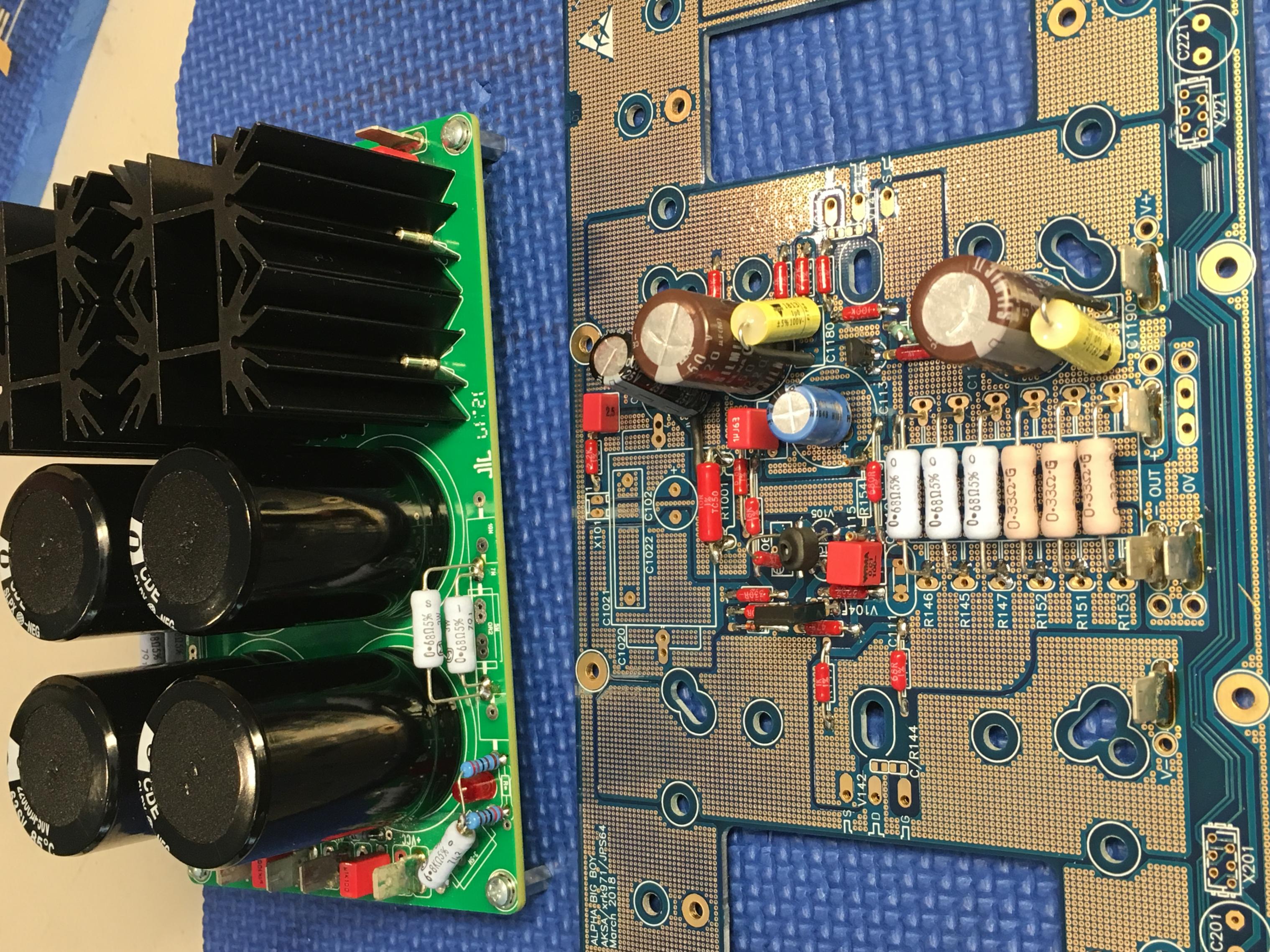

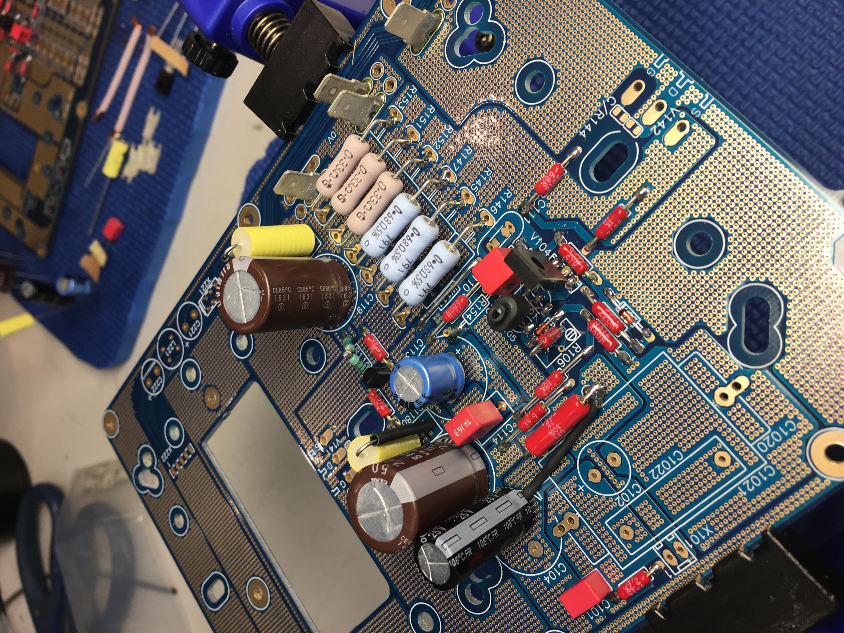

Making some progress on the BB and psu🙂
Vunce,
Good to see the build progressing, and your handiwork looks neat! 🙂
Nice color resistors, hope it sounds as good as it looks. I got a few same pcb holders for soldering.
What's your choice for mosfets?
Hugh
Hugh,
Is this what you means?
Brad
