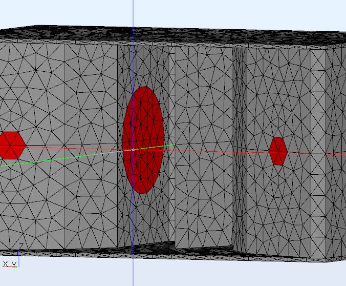

Ok, looks like I got it, now 🙂
I've build 3 interior subdomains, one for each volume. And one exterior with the external surface. It was a bit tricky with the two sides of the baffle, but it looks much better now. Thank you!

Good to see progress but I am not sure I understand the volumes. Are two of them the sealed air volumes behind the drivers? If so, what is the purpose of including them in a BEM simulation? Or are they only used to determine part of the lumped model for the driver?
Hi AndyGR42,
The following applies to a free field simulation:
For a standard dipole (including U-frame) you need 2 subdomains: one external for the front of the driver and one internal for the rear of the driver. This is required since the driver front and rear are so close and suffer from “thin-shape breakdown” - the subdomain is an efficient workaround to this numerical issue. The two subdomains are connected though one interface.
The Ripol as you drawed it would need 4 subdomains: 1 external and 3 internal. However if you take advantage of left-right symmetry at the mid plane between the two drivers you would only need 3 subdomains (1 external + 2 internal subdomains).

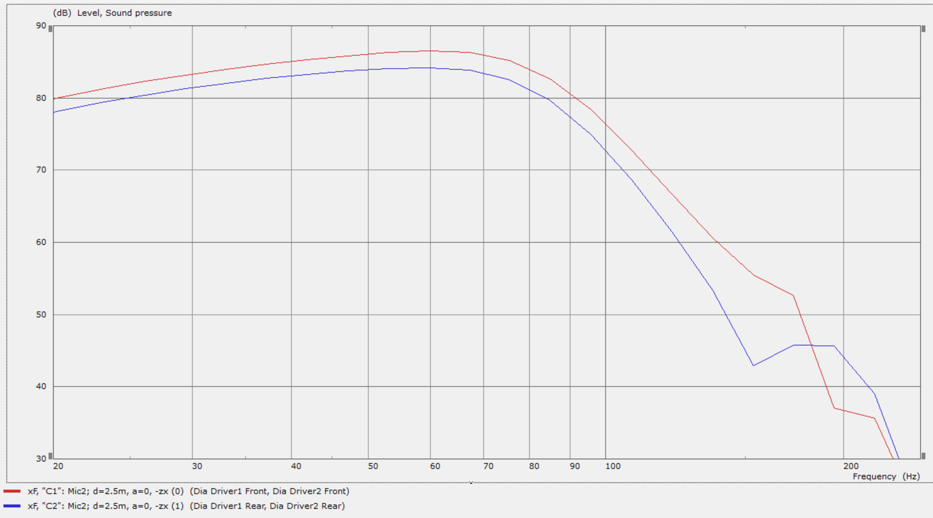

Hi David. Thank you, much appreciated. I'll stay with 4 at the moment, using y-symmetry. But I'm wondering about the high level of rear radiation in front of the speaker. I've places a point mic 2,5m in front and it measures nearly the same level from the rear than from the front. In free air without any walls, I won't expect that.
[LR8 low pass 85Hz added in LE to suppress the resonance peak around 200Hz)
Thanks for sharing the Project. I think it does make sense at low frequency where, taken individually, the front and rear act as omni monopoles and their spacing relative to the 2.5m distance is not so great viewed on a dB scale (6dB per doubling distance). What is interesting is how they interact to yield the typical dipole radiation pattern. I've added some "Radiation Polars" Observations to your Project that you can solve pushing F7 and visualize/plot into VACS. That should help figuring out what is going on. I suggest that you turn on/off the LPF. Also instructive is adding an Observation Point and plot the Front/Rear/Sum FR with their phase.

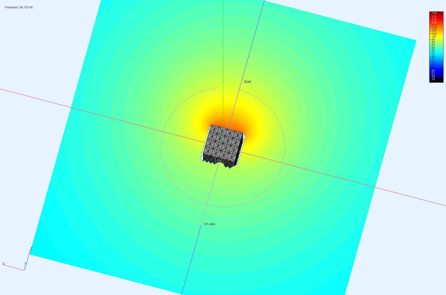

I've finalized the design, and 0.3 x SD (sum of both drivers) seams the best value for the front duct. I've added the polar mic's and you can find the detailed charts in the ZIP file.
What I still don't understand, why is the rear radiation so dominant in front of the speaker? When I look at the mic field (rear only), I would expect less or nothing from the rear in front of the speaker, unless there is a wall reflecting the sound. Or some pressure through the front duct, never at the sides. But I see a smooth omni of pressure around the whole cabinet. The polar mic's showing the same.
Thank you
The front radiation should be as significant on the rear as the rear radiation is significant on the front. If you had just a sealed sub of comparable dimensions the radiation pattern would be very similar to either the front or the rear of your dipole.
At low frequencies the wavelength is much larger than the dimensions of the baffle or the sound source (in this case the slots), so the sound field "wraps around" the baffle and we have near-omni (4-pi) radiation. Note that even in infinite baffle you would have wide radiation pattern when wavelength>>source dimensions (although we cannot talk of "omni").
If you run your simulation (or better just a sealed "cube" sub to avoid the cavity resonances that will pollute the data) to higher frequency you would see that eventually the directional behaviour you are expecting will be present.

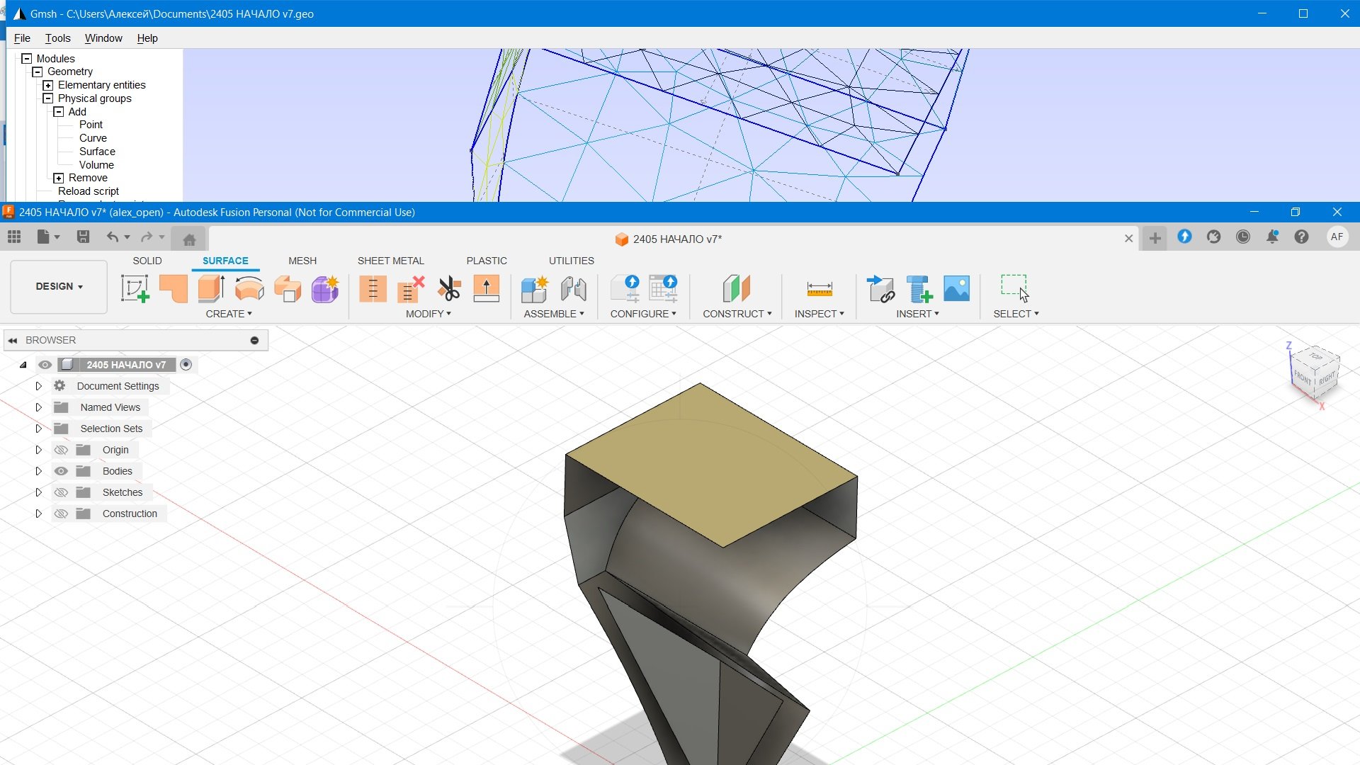

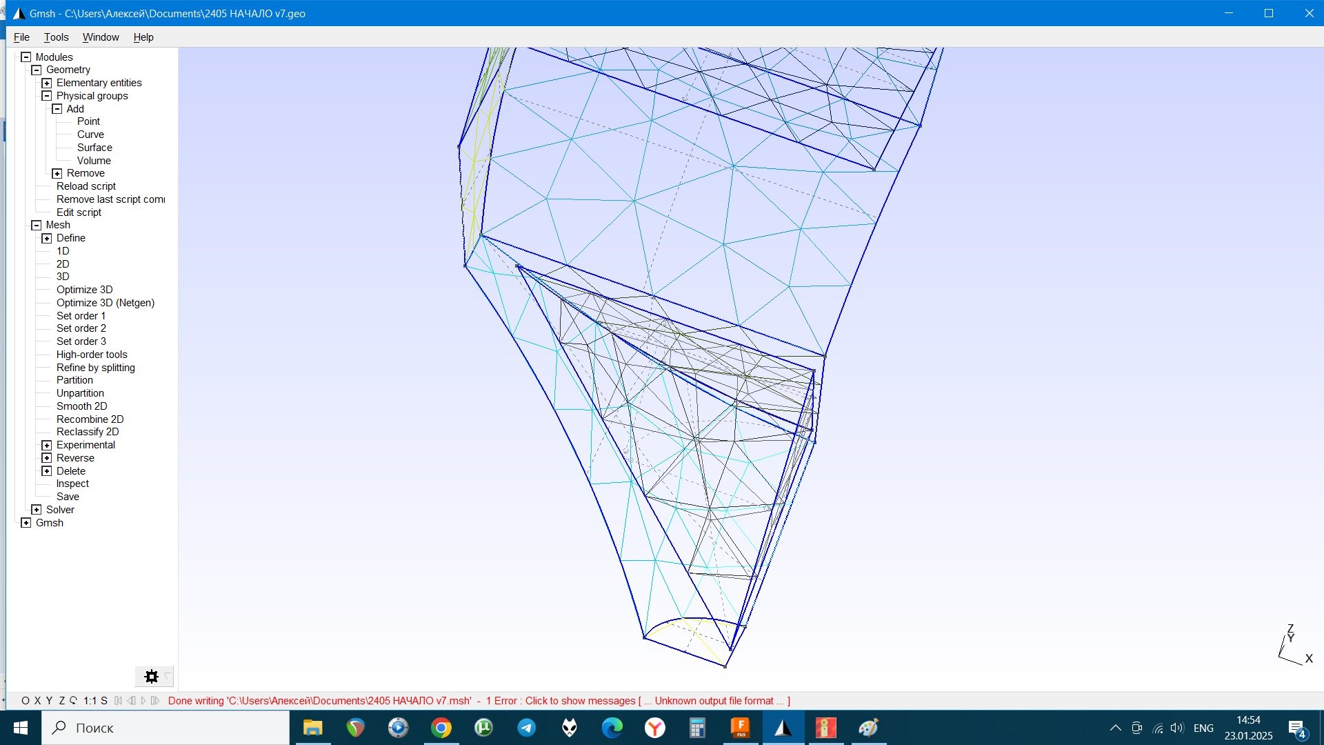

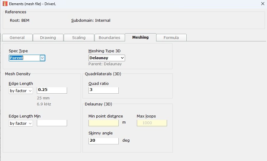

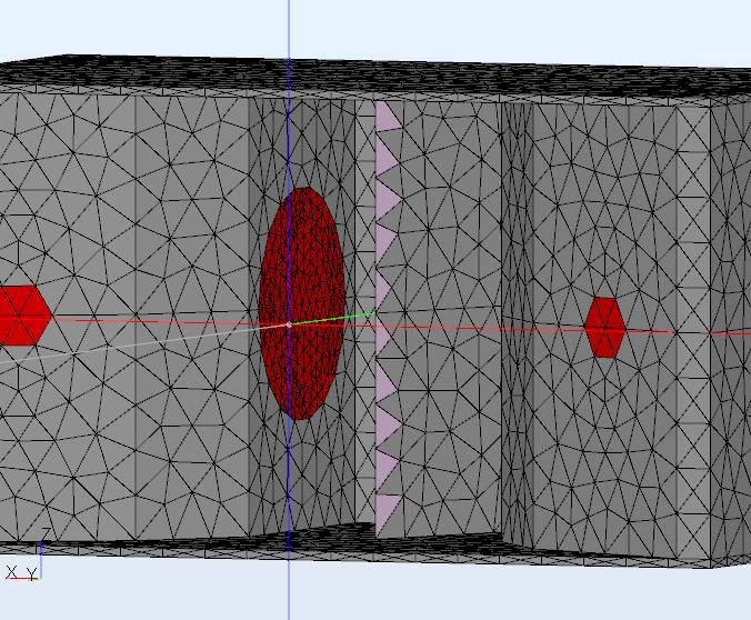

Hi guys. Maybe my question will seem off-topic, but I hope you can help me. How to increase the resolution of the model mesh? At what stage is this done. I model surfaces in Fusion 360, Then I export to STEPE, then I export GMSH, then I export AKABAK and I see a very rough resolution. I will be grateful for any help

chatgpt was trainied with gmsh perhaps you can Upload the content of your .Msh-Data there and tell chatgpt to increase the Resolution.
but before that you should define physical groups in Mesh - add physical groups - surfaces.
i dont know If it works but you should give it a try.
Gmsh is the grid generator in your chain and so what you would use to create a finer grid. Gmsh uses a user supplied value to determine how fine to make the grid. A single value can be applied to all nodes or you can have some regions finer than others by specifying different values for different regions. If you wish to refine everywhere this can be done with a single click: Mesh -> refine by splitting. Repeat if you want finer again.
I figured out how to increase the resolution everywhere. Can you tell me how to do this for each element separately?
That will depend on what is in the STEP file from Fusion 360 (which I don't use). To check select Visibility in gmsh and then look at what is present in terms of "elementary entities" and "physical groups". If you are lucky there will be physical groups present and you can assign conditions like sizes to those. If not you will need to create physical groups from the entities first.
I have never used the gmsh GUI for anything other than a quick check of a mesh created using a script. I have just tried to use the gui to create a physical group (achieved) and assign a size to it (failed to see how to do it). You will have to ask someone else how to assign a size to a region using the gui. It is straightforward with a script but this requires the user to be comfortable with scripting which is often not the case. Most of the help on web seems to assume the use of scripts as well.

There a few things that should be cleaned up and the model solve warnings will go away.. I've attached a new version
The driver faces (front, rear) should only be declared once (unique) per subdomain. The "sub center" baffle has both the front and rear surfaces, and the "Sub Driver[1,2]" baffle has the rear surface as well.
A few small but useful preferences. The global drive level should be set to "rms" otherwise you get a peak output level and it will not match measurements. The global sample freq should be logarithmic sampling to provide better spacing on the logarithmic freq response charts.

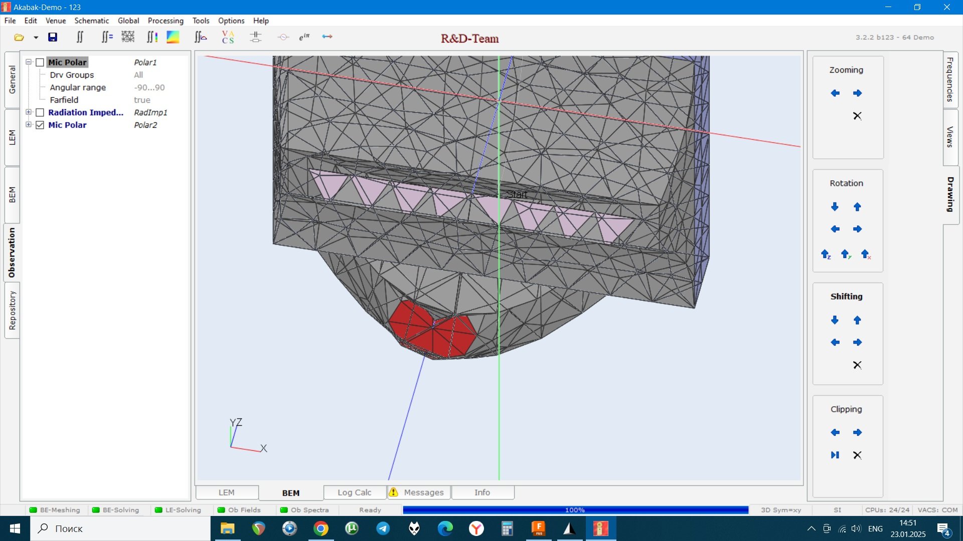

Thank you all for your answers. I figured out how to increase the resolution everywhere. Can you tell me how to do this for each element separately?
You could mesh each surface separately in GMSH.
You can also re-mesh in AKABAK on a component/element level. I've attached a few pics showing where to set re-mesh and what it looked like before and after a driver surface was re-meshed. BTW, this feature has improved a lot when compared to earlier AKABAK (ABEC3) versions.
