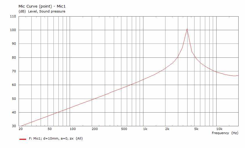

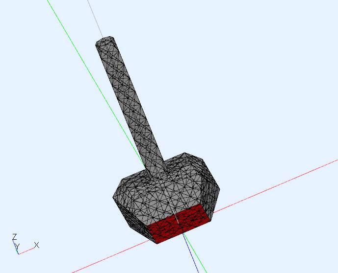

@hugoherman I was curious about how Akabak BEM would work when things get very small. An air molecule is 3.4nm, so plenty to fill the tube. I used a 2.5mmx1.5mm chamber and a 4mmxR0.25 tube. I drove the membrane (red) at constant velocity of 0.1m/s to see if the system worked as a Helmholtz resonator. Sure enough,.. it works. The Akabak files are attached if you wanted to investigate. The drawing (STEP) was done in FreeCad and mesh by GMSH.

Interesting approach, I've mainly used Akabak's own 3d modelling tools in order to make the calculations faster. How come you did put the the driver inside the Helmholtz? What I've found to work is to put a pressure source outside of the opening of the "bottle" and then have a measurement point inside, see attached file🙂
@hugoherman , You're welcome, and thanks for the project file. The example I provided was just my experiment to see if the model worked for very small geometries. This is the smallest thing I've ever tried to simulate in Akabak. There should be reciprocity whether its excited internal or external.
Yes for your specific application I would also use the external pressure source to excite the resonator, and measure at the mic plane. The Akabak primitives are OK if your design actually matches the shapes available. The solve times are based on what symmetry is used (circular is fastest) and #elements. I just looked at the paper you referenced and built something like that shape in FreeCad because it was convenient for me and it solved quickly.

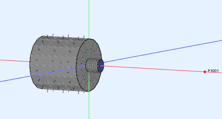

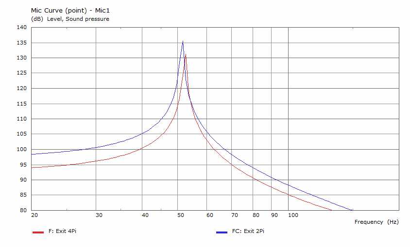

I’m currently exploring the capabilities of Akabak for microphone simulations and came across an interesting observation regarding cylindrical Helmholtz resonators. I’ve noticed a small difference in the calculated resonance frequency depending on how the internal and external volumes are defined.
Specifically, I’ve been comparing two modeling scenarios:
  1. Scenario 1: Only the internal volume is defined with inward-pointing normals.
  2. Scenario 2: Both the internal volume and corresponding external walls (placed as exterior boundaries) are defined (See figure).
I've attached the two models for comparison. Additionally, I’ve calculated the theoretical resonance frequency, accounting for an end correction of 0.6. For this particular resonator with the following dimensions:
  • Volume: r = 0.2m, L = 0.4m
  • Neck: r = 0.025m, L = 0.05m
The theoretical resonance frequency comes out to 59.9Hz. However, the simulation results show:
  • ~56Hz for Scenario 1
  • ~52Hz for Scenario 2
Given these results, I’m wondering which modeling approach is more accurate. Intuitively, I’m inclined to believe that the second scenario (with both the internal volume and external walls defined) is more correct. Can anyone provide insights or guidance on why this difference in resonance frequencies occurs and which approach is more appropriate for accurate simulations?
Thanks in advance!

There are a few factors to consider in comparing the models. Overall the global mesh freq should be specified otherwise it may not be consistent between the models compared. The tuned freq depends on the effective air mass of the tube which includes the port exit air mass and this depends on the termination (flare) and the surrounding boundary coupling. Sometimes a port correction factor is used based on port cross section, termination shape (flare) and boundaries. Since only discrete sample freq are solved some care is needed in selecting the number of samples and freq range (PPO) to find any peak accurately.
Model 1 has only internal surfaces and port exit (subdomain interface) but no external surfaces. To make this model more accurate include an IB at the port exit. This is a "hole in the wall" for perfect 2Pi radiation space, and there will only be an n-Pi to 2Pi boundary transition.
Model 2 has both internal and external surfaces (good). The port exit has zero surface area (coincident tubes, no baffle) so there is an abrupt transition to 4Pi space. The baffle step will be around 6dB between 2Pi and 4Pi radiation space. The transition is affected by boundary surface area, location, radiator size and wavelength. This is a "tube hanging in 4Pi freespace". The actual tuning freq will be somewhere between V1a and V1b depending on the actual boundary area and port flare.
I've included the models I used and this link for some PortTuningExperiments .

Thanks for your thoughts on the approach. I get where you're coming from regarding the simplifications in the linear acoustics model. Yes, it does overlook things like turbulence and friction, but for the purposes of getting a quick, reasonable estimate of the resonance frequency, I thought it was a good starting point.
For the resonance frequency, I used the standard equation for Helmholtz resonators:
It gives a solid first-pass result, and while it doesn’t include all the nuances of the flow, I felt it was accurate enough for this context. (L being effective length).
On the grid resolution, I made sure the mesh was refined enough to resolve the acoustic wavelengths properly—around 5-10 grid points per wavelength. I did some checks to make sure it was close to grid-independent, and it seems like further refinement didn’t change much.
12% looks a reasonable error to me given the missing physics w.r.t. the flowfield assumed by the linear wave equation. You can get a feel for this to some extent by considering potential and rotational flow into and out of a hole. Your error is in the ballpark of the "end corrections" that get applied to try to compensate for the missing physics in your formula.
6 elements per wavelength is a rule of thumb for BEM schemes that use conventional reasonably accurate elements. Akabak I believe (never used it) uses zeroth order elements (sidesteps a number of numerical issues) with a flat planar geometry when integrating in space over an element. Resolution will need watching particularly in regions where the geometry various sharply. But 10 elements per wavelength looks a reasonable place to start to me.
If you are coupling various domains I would suggest moving the coupling surfaces around to get a feel for the size of the approximation they are introducing. For example move the coupling at the mouth into the port perhaps a diameter or two so that the changing conditions around the mouth are reasonably resolved.

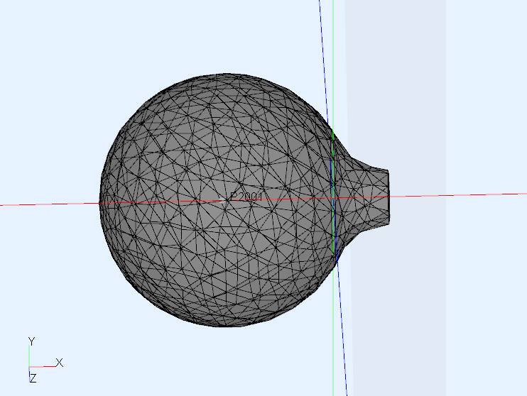

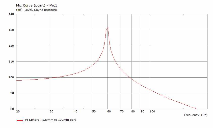

Lets repeat Helmholtz's experiment using the same configuration that he used. I used a sphere blended into a cylinder. I've used a R229mm sphere to match the volume of the previous cylinder merged with a 100mm X 100mm exit port.

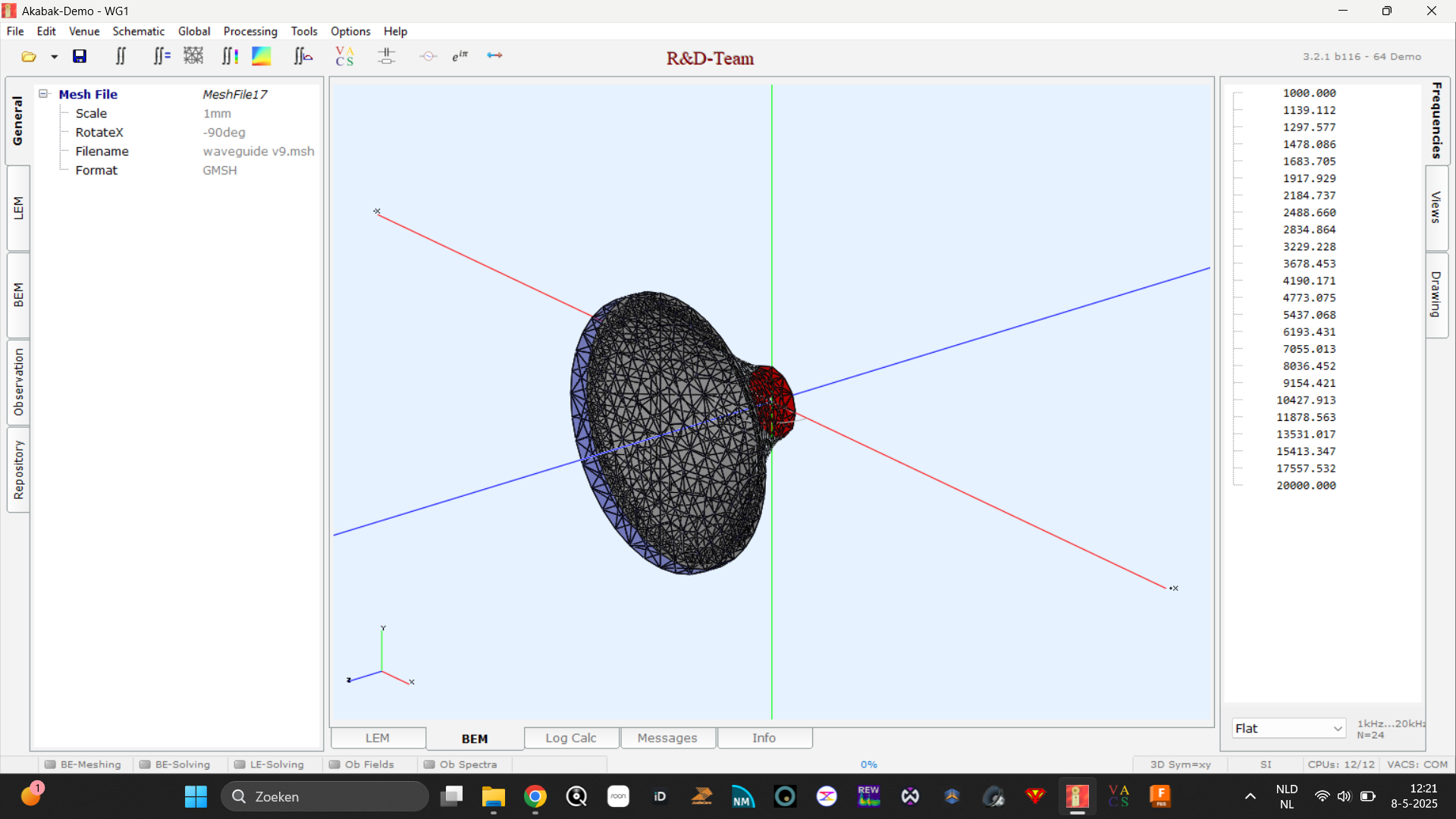

Hello, stupid newb question. I´m trying to do some simulations in Akabak but I've drawn my WG in front of the X-axis so i need to shift some things to get the WG exit on the axis. But the moment i use even 1 mm "shift" everything disappears. First I tried to offset the infinite baffle. But it also doesn't show up when i use a shift. Driving me crazy.
@3wayaddict , this is usually caused from problems with scale within the project. Most CAD files have a default 1mm scale that can be specified globally in the [General][Component][Scaling] tab as "1e-3". Then in the [BEM][Component][Scaling] specified locally as "1" because of the previous global setting. If the scaling is weird or duplicated (ie. 1e-3 * 1e-3) there will be a drawing problem. If you can post or DM the project to me I can have a look.
