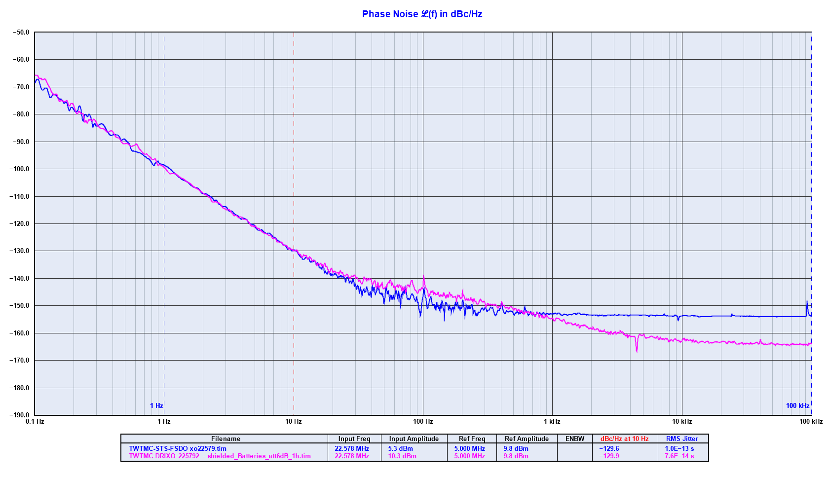

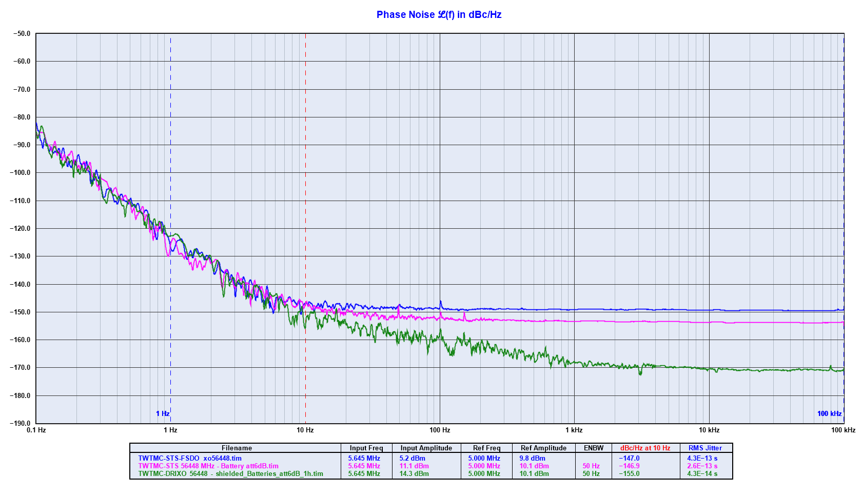

It's not true, the kind of signal sine or square and the amplitude don't matter.
The plots I have published about the noise of the picogates clearly demonstrate that the close in phase noise is not altered by the kind of signal and by the amplitude.
The picogate have been used to square the sine output of the oscillator and the close in phase noise is almost identical.

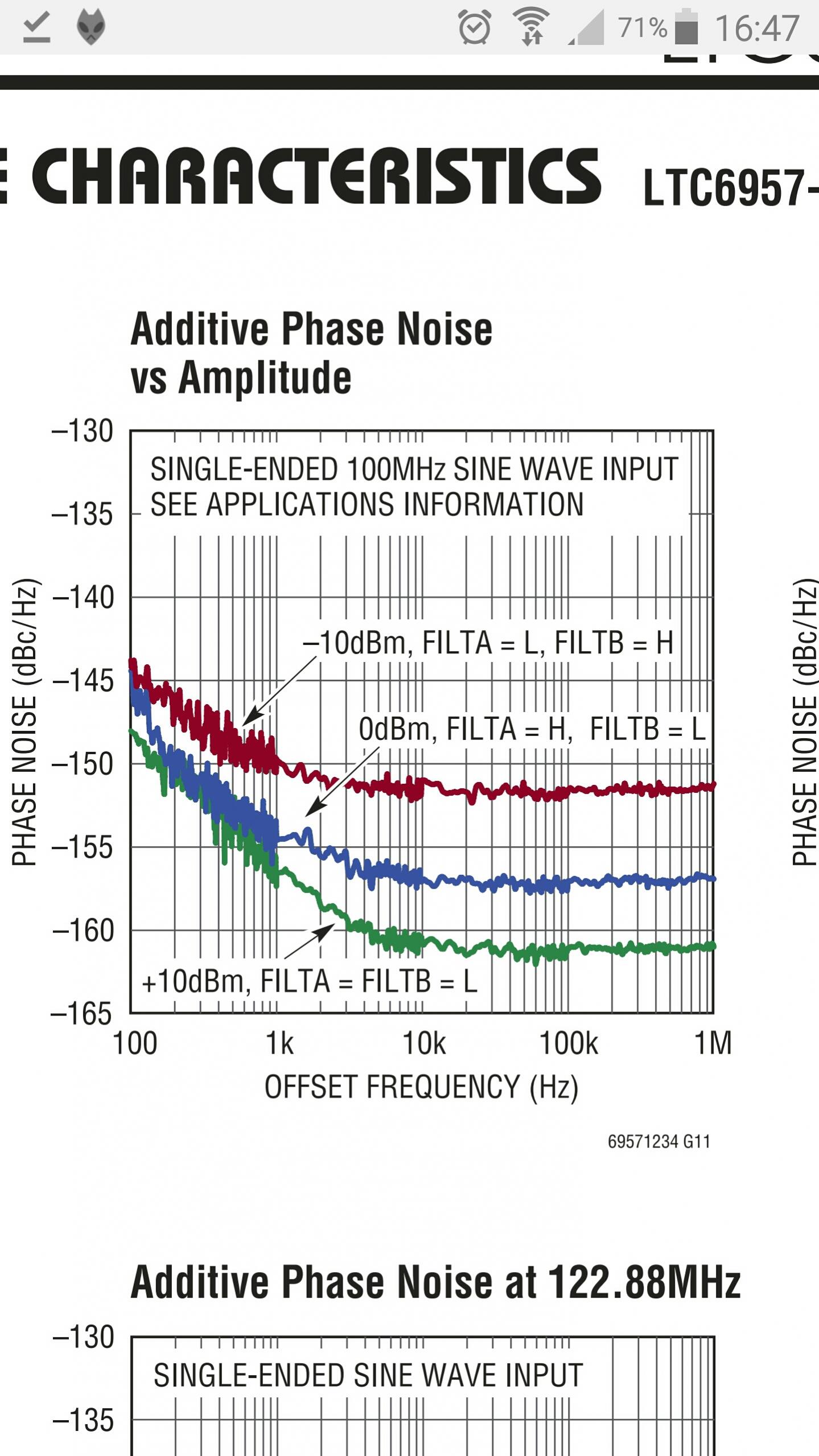

I wasn't referring specifically to you Andrea, but in general and actual hardware implementation in one's home.
You know the requirements for converters as well as comparators etc etc dictate a minimum speed requirement, otherwise jitter goes up.
Same goes for e.g. the ltc6957, the plots are very clear, see attached (pecl plot).
Last but not least, I'm pretty sure high speeds as well as proper routing and termination aren't tested at all in the diy-community. So adding a good clock with rather steep edges might even do more harm than good. If you catchy drift.

I have tested the LTC6957 (plots attached), the results are the same of the picogates, they don't add close in noise.
We know that every component of the audio chain and also external factors can affect the jitter.
That's the reason we are building a FIFO buffer where the dirty signals are strong isolated from the crucial signal for the DAC (the LRCK for our discrete DAC).
Our target is two fully isolated time domains, so nothing can affect the conversion.
