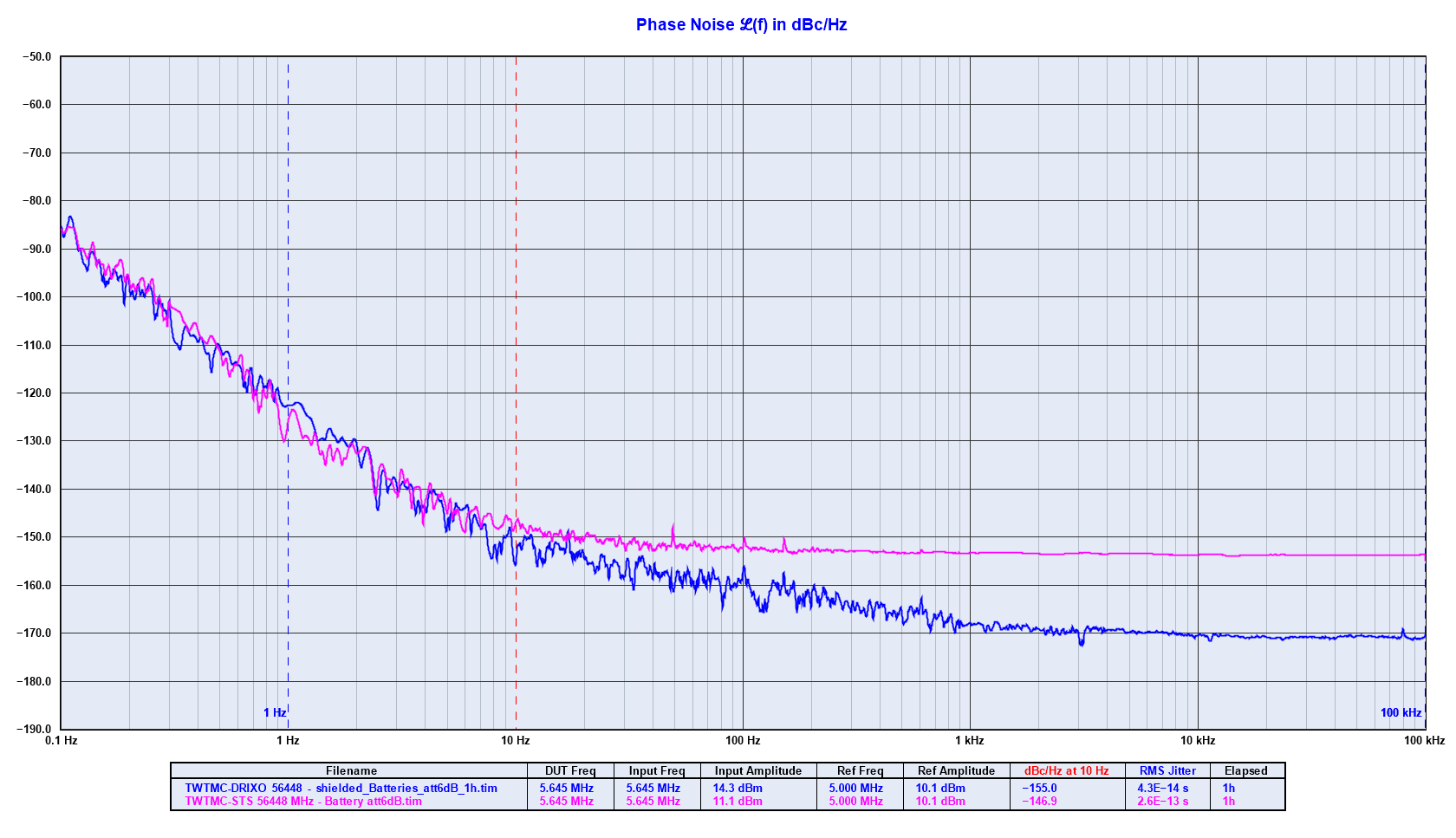

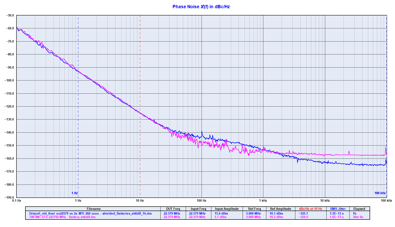

They seem to forget the PDFs from TI and others describing the jitter requirements of a data converter and what that looked like at audio frequencies.
I also wonder if you can preserve the level of additive phase noise performance that TI and Linear get in their top ADCs in an audio grade converter that’s got integrated DSP functionality. If only picogates and GHz clock buffers with fs PN are good enough for the jitter fetishists here, what do the buffers inside an AK4499 look like in terms of performance and what is it like at the destination?
It looks like the picogates are good enough.
Indeed they degrade the noise floor but not the close in phase noise.
