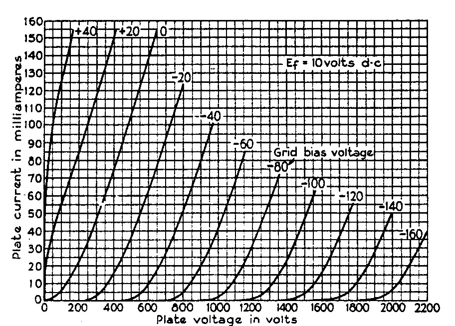

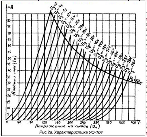

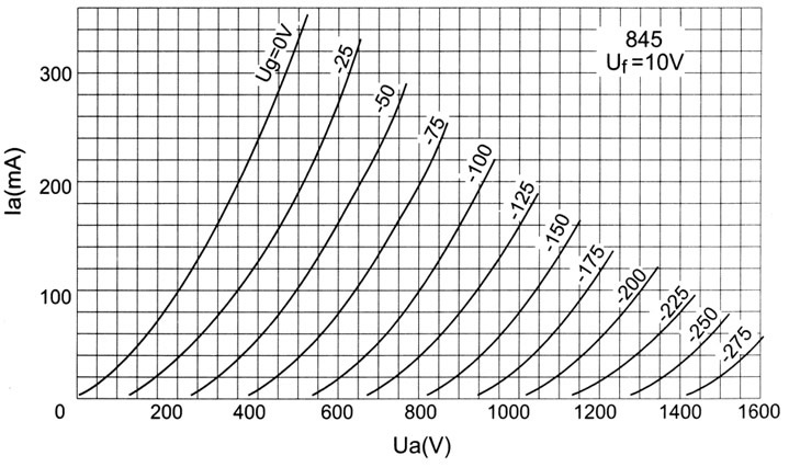

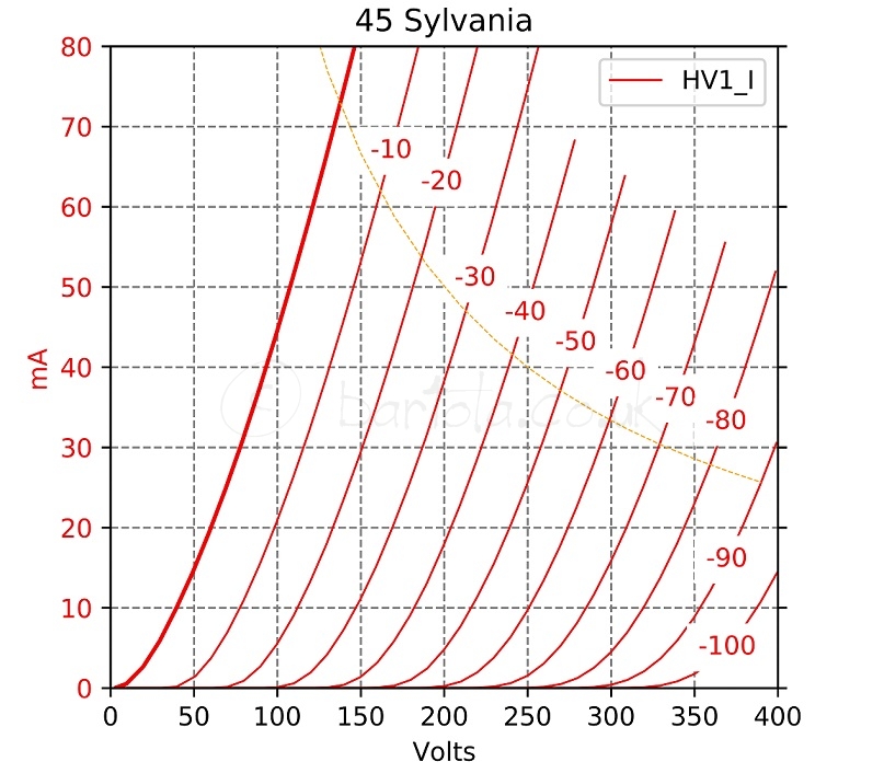

What are these solid state devices that have solved the problems?
The linearity of the vacuum tubes I have pointed out is clear and documented (curves attached).
So please publish the curves of the solid state devices you are referring.
Anyway for this topic there is a more appropriate thread
Sound Quality Vs. Measurements

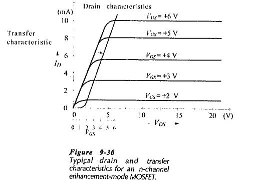

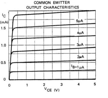

Its all in how you use the devices. BJT current driven are pretty linear. Mosfet transfer curve is voltage driven and quite linear.
As Scott mentioned its possible to build simple circuits with extreme linearity using these devices and no feedback. There are other considerations that lead to more complex circuits and need for feedback.
