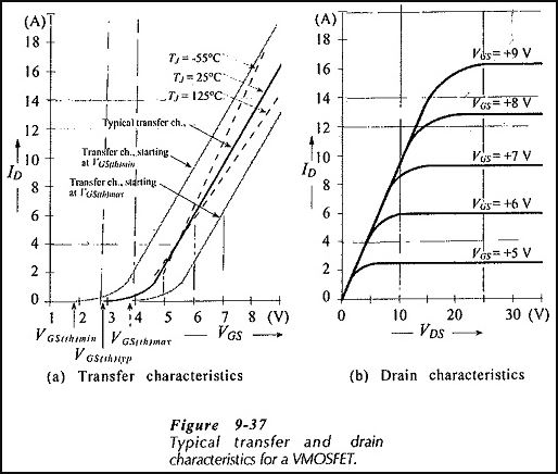

Demian,
the curves of the anodic characteristic of the 45 are practically equidistant.
It's not so for BJT and mosfet.
In the curves you published you can clearly see a difference in the distance between the various curves, and this means less linearity.
This means that if you use a BJT or a mosfet without feedback you will get more distortion than the valve which has better intrinsic linearity.
Indeed as far as I know there are very few open-loop zero feedback power amps.
Actually those curves looked quite evenly spaced to me.
This may be clearer. The transfer curve of a Vmosfet is very linear as you can see with lots of current. Nelson Pass was taking advantage of this in some of his interesting designs. I used it as well also because it's gain doesn't fade with frequency unto you get very high, way beyond audio.
When you use them without feedback loop you get high distortion.
The F1 amp (IRFP240) has around 3% distortion at 8W power output (1kHz 8ohm), while a GM70 or 845 amp at the same power output has a distortion around 0.8%.
And moreover we should compare the harmonic spectrum of the distortion, the tube amp is mainly 2nd harmonic, 5th harmonic is -90db and 7th harmonic is practically zero.

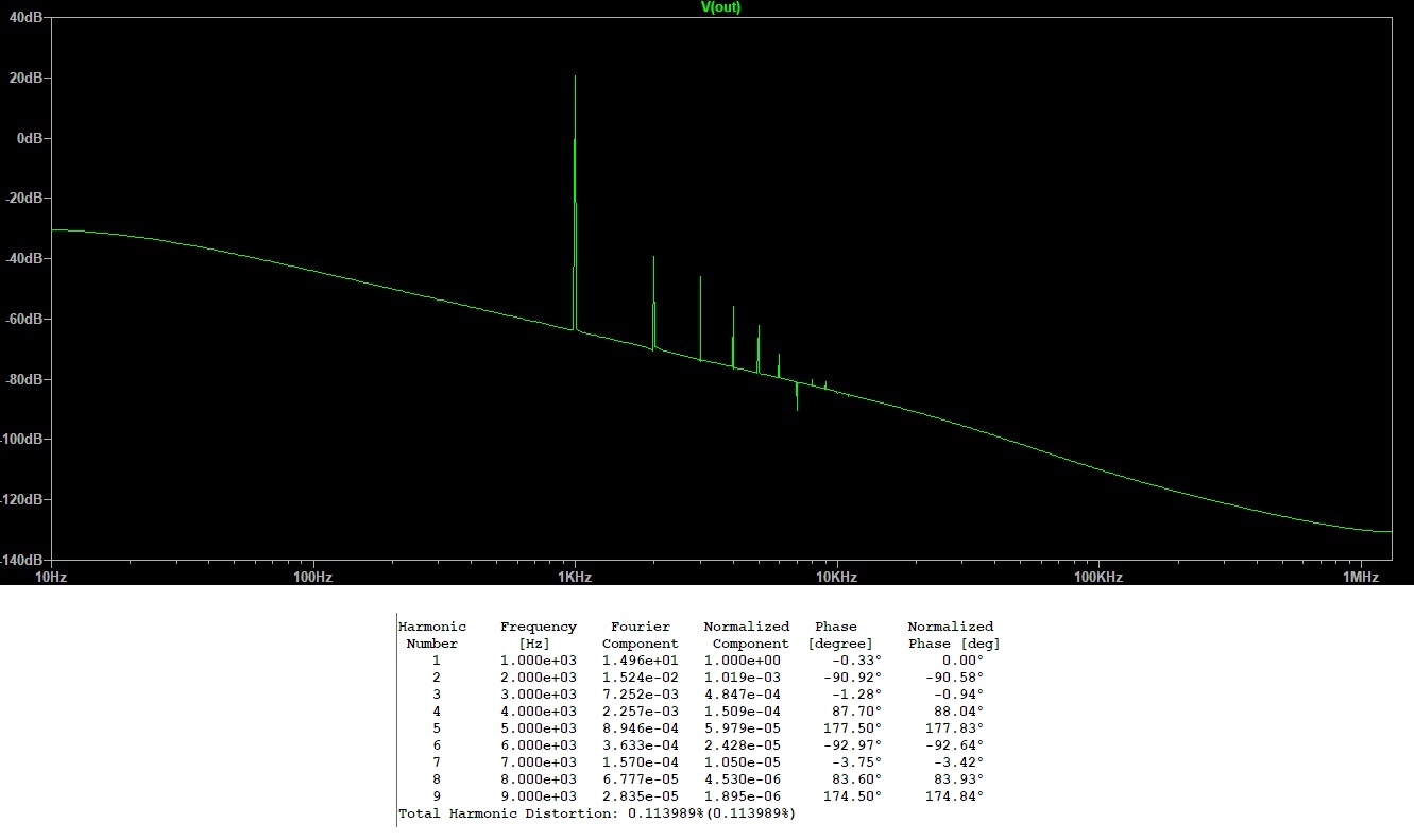

This is a simulation of a zero feedback solid state power amp I have to build as soon as I find the time.
At 14W power output (1kHz 8 ohm) the THD is around 0.1%, but there is no voltage gain from the active devices.
As soon as the circuit is modified to get voltage gain from the active devices the distortion increases significantly.
