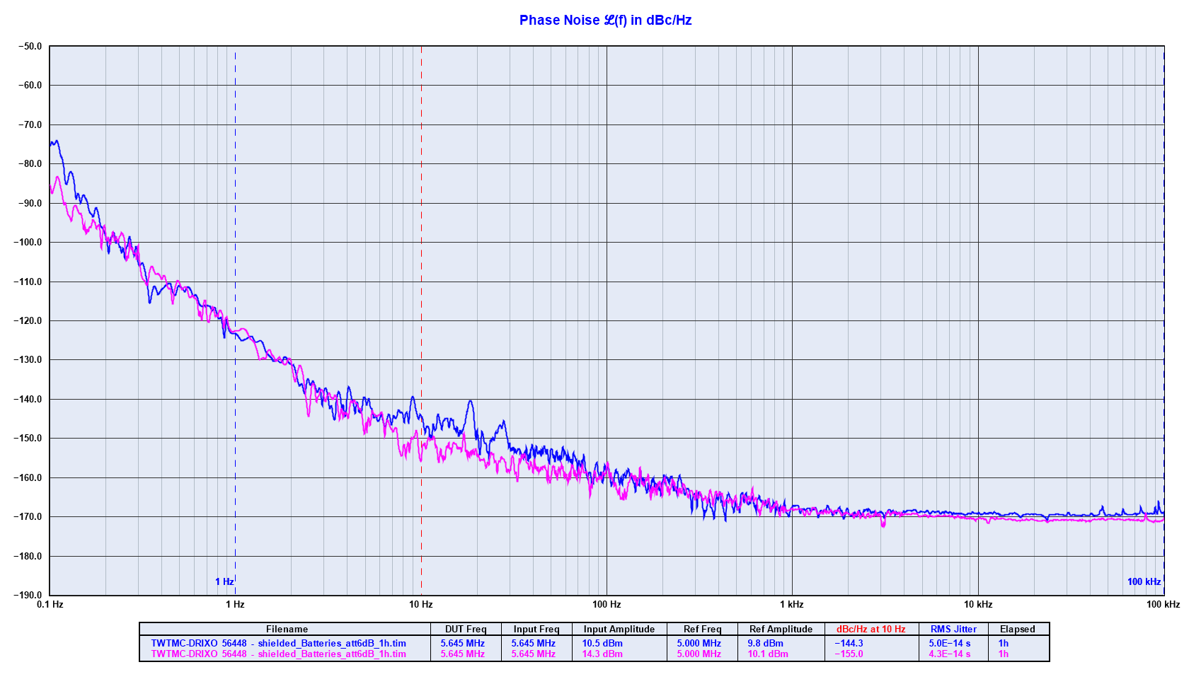

Mark is right.
The crystal, especially if SC-cut, is a bit like a bottle of good wine, it improves its performance over time.
It can take months to reach the maximum phase noise performance for an SC-Cut crystal.
Mainly this is due to mechanical settlements in the crystal.
I have measured several SC-Cut crystals and this phenomenon has occurred for practically all crystals.
And it's not about nuances, sometimes the improvement can reach 4-5 dB.
Even if in a less marked way, the same behavior also occurs when the oscillator is turned off and then turned on again.
The attached plots are the phase noise measurement of the same oscillator with the same crystal.
The pink curve is the phase noise we have reached after several days the oscillator was powered on.
Then we have measured again after the oscillator was switched off and the results was the blue curve.
Finally we have measured one more time the oscillator after a few days and the phase noise plot was again the one of the pink curve.
Indeed in our battery power supply we are using to power the oscillators we have provided a supplementary linear regulator to power the oscillators during the battery recharge to never turn off the oscillators.
Finally the oven is useless in audio, just a complication and a wast of money.
We have measured the phase noise of the same oscillator with and without the oven and the plots were practically identical.
Of course, without the oven the oscillator's Allan Deviation is far worse, but we don't care about that since in digital to analog conversione the long term stability does not matter.

The published plots show the phase noise of a state of the art oscillator (around -150dBc at 10 Hz from the carrier) while a ordinary Crystek has a phase noise around -97dBc at 10 Hz from the carrier.
So the impact of the described phenomenon (if it occurs in the Crystek, I have not made the same measurements with it) would be greater.
While the phase noise of an oscillator used to clock a DAC can be easily measured (although one needs expensive gear), measuring the effect of the phase noise variation at the output of a DAC is tricky.
And it is even more difficult if you want to measure the effect of a 4-5 dB change in the -150dBC region.
The DAC input should be modulated by adding -150dBc phase noise in order to measure the noise at the output.
To make this measurement you need an instrument with an ideal time base, certainly with a phase noise better than the -150dBc at 10 Hz from the carrier we want to measure.
The attached TI paper gives you an idea of ​​how this measurement could be made.
Consider that in the test they used an integration bandwidth starting at 100 Hz, while we are talking about phase noise at 10 Hz from the carrier, so the instrumentation should be at least an order of magnitude better.
It seems that for TI it is not a waste of time.
If you read the TI paper carefully you see that they have formulated a model to take DAC intrinsic noise into consideration.
Anyway I don't own the gear to make such that measurement, so my thought is irrelevant since I cannot measure the effect of phase noise and neither the DAC intrinsic noise.
From the technical point of view without proper measurements, every thought is mere speculation.
The only thing you can do is listen to the difference and draw your own conclusions.

Now strictly technically speaking..
The difference in Andrea's curves is not finished at all at the 10Hz/ - 150dBc zone.
There is a visible difference in the close in, <1Hz region as well. And at that zone we are not talking about - 150dBc, but - 20/ 50/ 60 dBc.
And these levels /differences actually are macroscopic..
So at wander/ walk/ (actually jumps) zone, where Allan deviation starts to be a better descriptor.. And where a lot happens with warmup/ aging.
True, and a hypothetical "phase noise magnifier" would show even larger differences @0.1Hz, @0.01Hz, 0.001Hz. We call this "1/f noise" or "flicker noise" and is a fundamental property of condensed matter in our version of the universe.
The region you pointed out is usually called 1 / f3 (and so on) noise, where the phase noise degrades around 30dB/octave (Leeson equation).
The 1 / f region has a slope around 10 dB/octave.
