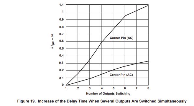

I can understand the desire to reclock on a discrete R2R DAC, but for that to be meaningful at the picoSecond level you have some serious layout issues to resolve. Not to mention skew in the switching time of the logic. The plot below from TI shows what happens to your transition when more than one output switches. (https://www.ti.com/lit/an/sdya009c/...35015&ref_url=https%3A%2F%2Fwww.google.com%2F) Your femtoSecond jitter just got modulated by the audio waveform. . . This is why clock analyzers are a great tool but cannot replace proper analysis of the analog output.

It's one of the fundamental limitations of R2R ladder DACs. There are many others too.I can understand the desire to reclock on a discrete R2R DAC, but for that to be meaningful at the picoSecond level you have some serious layout issues to resolve.
But you have also highlighted a fundamental advantage of a native DSD (or PDM) type DAC with multiple unity weighted bits arranged in a moving average topology.
a/ Any clock delay does not affect linearity at all as long as the clock delay is constant for that particular OP bit.
b/ The bit switching time skew can be addressed with RTZ encoding where it is very effectively nulled.
