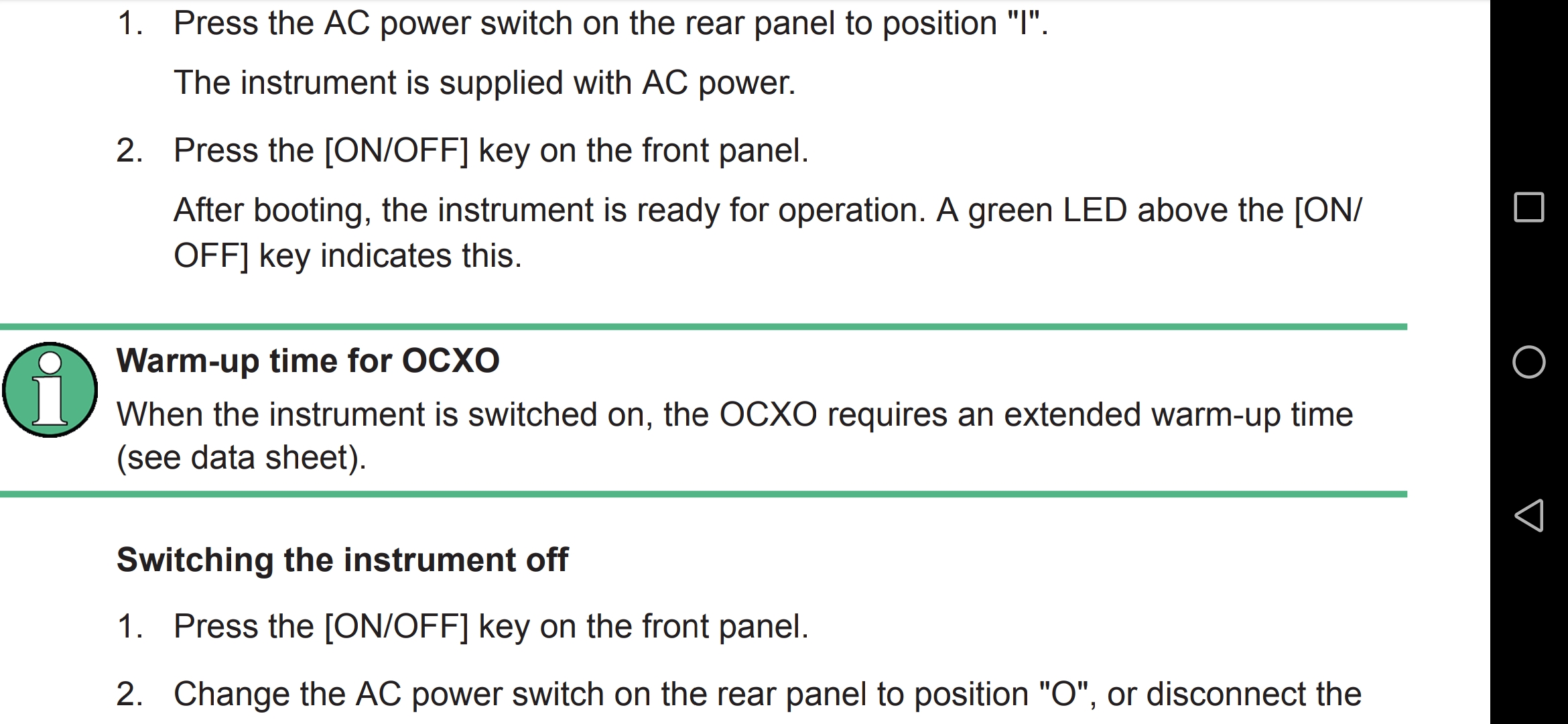

Chris, the screenshot is from the manual.
The procedure of off/ on is multi-level, the front panel switch is just standby (this is what it should be left in).
I do not know why should it be questioned.

It's kept on for convenience to avoid 30 min of wait, it is not the same thing as needing to be powered continuously for days to reach spec. Don't continue with the BS. I mentioned in my first reply that I saw it required 30 minutes. This whole thing was about claims of in the order of days, not minutes.
