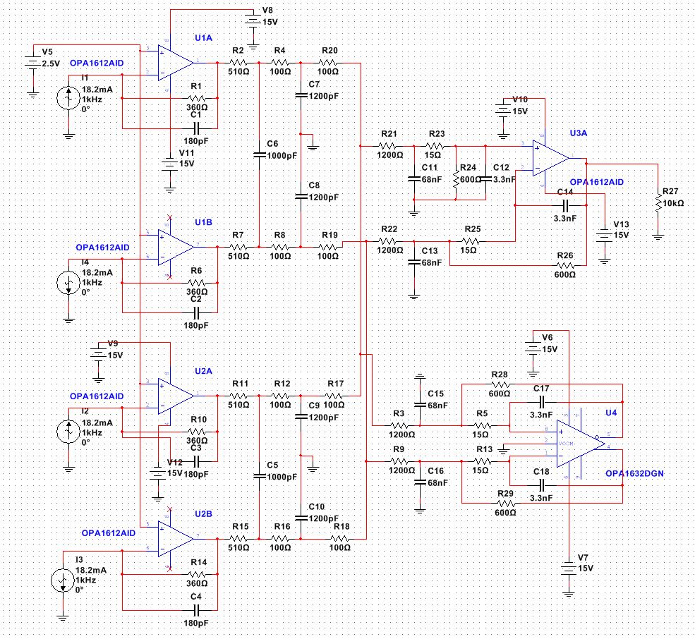

Proper way to use OPA1632?
Can someone check if this is the proper way to use OPA1632 for balanced output of AK4499? This would be schematic for one channel only.
Thanks!
Any intentions with respect to balanced loads and build-out resistors for OPA1632?
I can tell you that what you are suggesting is rather different from what Topping did with D90. They used active summing of parallel dac channels with some brand of 49720 opamps configured for differential summing only (no filtering). They then produced the unbalanced RCA outputs by differential summing of the summed-channel balanced outputs.
I'm trying to follow what the eval board schematics and datasheet suggest, but with the addition of OPA1632 for balanced outputs. This works in simulator. I just asked if more knowledgeable folks would comment on possible mistakes/improvements.
Yes, there should be output resistors of say 22-100 Ohms after OPA1632.

Maybe I could post some of it, but you should understand that the output stage is pretty perfunctory. The AK4499 datasheet suggested I/V works fine if the physical implementation is good. However, a possible problem is that the suggested passive filtering of the I/V stages does not fully filter out some RF at twice the BCLK frequency (and some other lower level stuff). IME the RF can cause some low level yet slightly audible distortion in downstream equipment.
In any case, the output stage is only one part of a good AK4499 implementation. Other things need to be 'right' too. Clocking and I2S data jitter also affect sound quality (I2SoverUSB is not quite good enough to get the best out of the dac).
The 8 dac chip output channel voltage regulators can affect the sound significantly.
If the dac output channels are paired up then the number of output voltage regulators can be reduced to 4. They still should be chosen for best sound quality.
Topping did not use RF LDOs for that, although they did use LDOs recommended for dacs, but with only 0.5v drop across them. The input voltage for those LDOs is provided by two of some brand of SMD 317 type linear regulators.
The power supply voltage for the I/V opamps also affects sound quality, as does the peak digital input level going into the dac.
There are many details to optimize for AK4499 to sound as good as it can.
So, to my way of thinking and in the context of today's discussion, whether or not one chooses to use OPA1632 for balanced outputs is kind of a small thing in the big picture. May depend in part how it responds to low level RF over the BCLK x2 frequency range for sample rates the dac may be used at. The opamp datasheet might not show possible sensitivity as well as prototype testing could.
What I would suggest for you samoloko would be to build the I/V circuits and differential summing circuits suggested in the AK4499 datasheet. No need to parallel channels too early in the development process, its not needed for the dac to sound great. Its all the other things that matter more.
