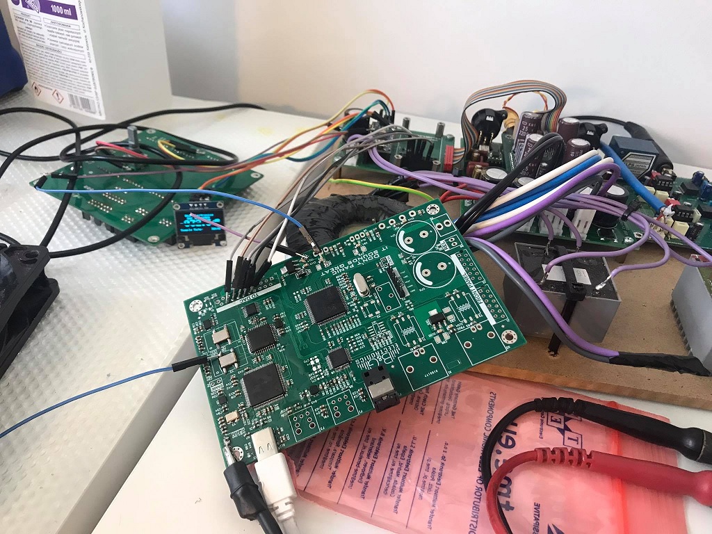

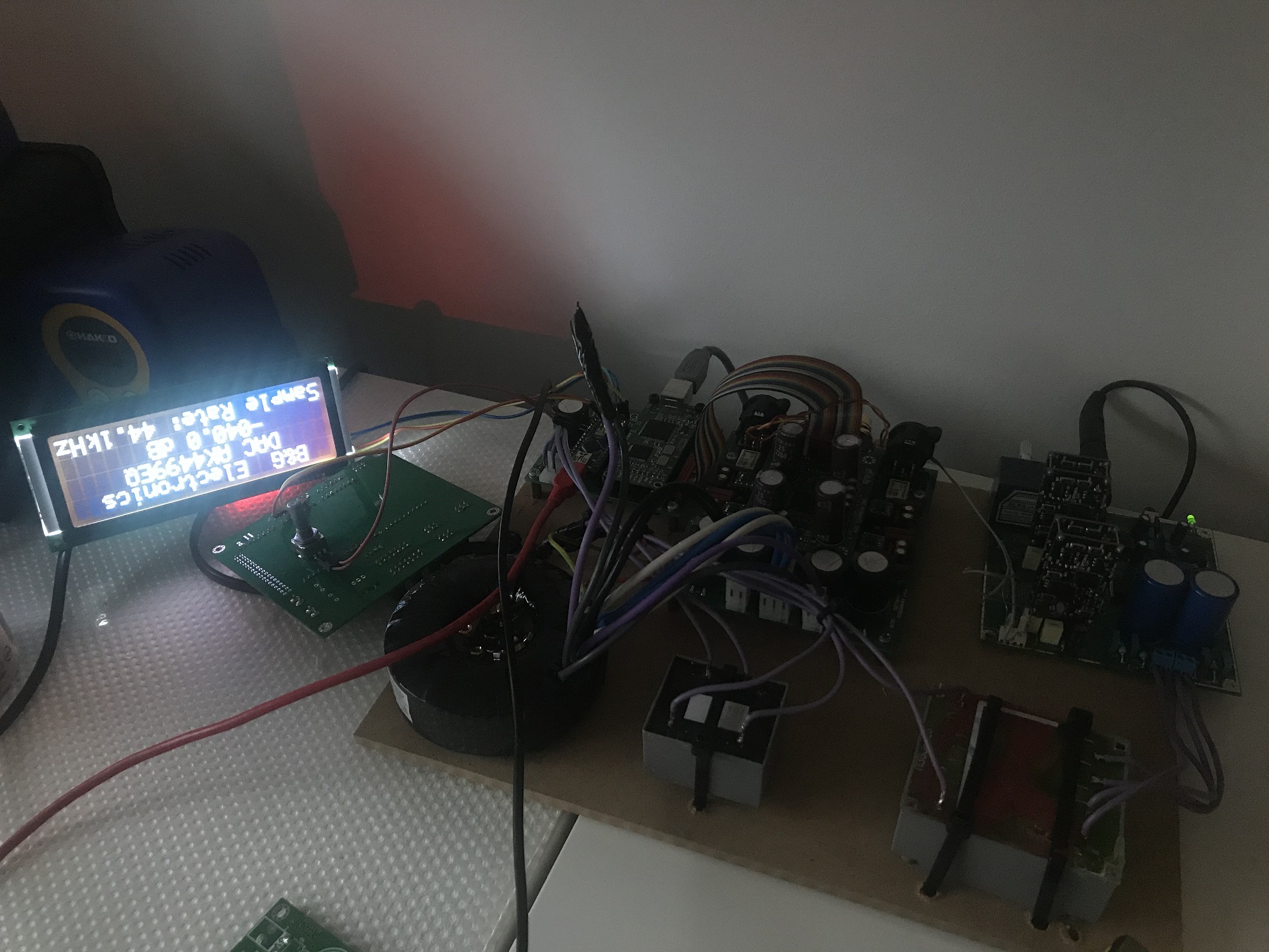

I would like to share about my progress with DAC 🙂.
Now everything works on the plank (i implemented LCD, digital volume control) but I'm designing new home for DAC 🙂

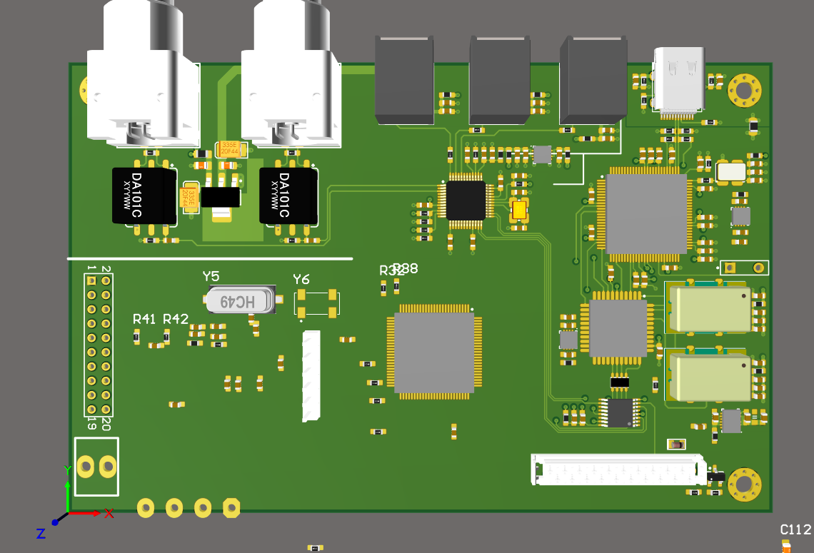

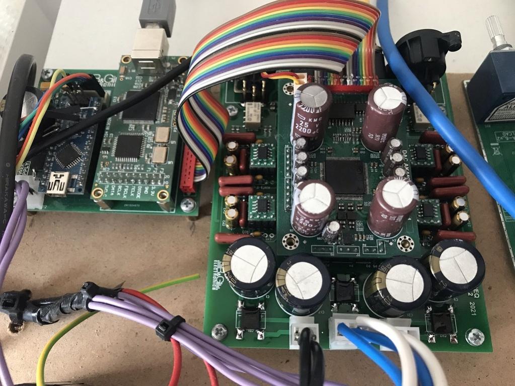

I did my own version of PCB's for DAC.
1 - 4 layers board with AK4499, ultra low noise voltage regulators from LT.
2 - 2 layers board with analog part and pre stabilization voltage for Digital part.
3 - 2 layers board with amanero and arduino nano for parametrisation of DAC, volume regulation, OLED.
Third PCB will be replaced for new one 4 layers board with 5 digital inputs on AK4118 and one USB Amanero in my version with better voltage regulators, clocks, uC STM32.
To this board will be connected PCB with OLED 256x64.
If You want PCB, just write PW 🙂
I did some measurements, SNR less than 130 dB, 50 Hz harmonics does not exist 😀
