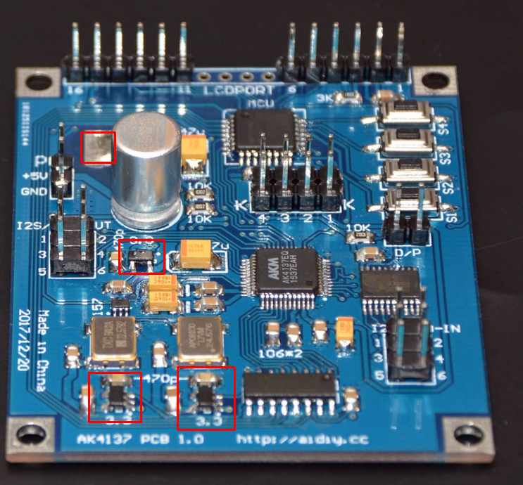

Attached below is a pic of a cheap Chinese AK4137 board. The red boxes show were some voltage regulators are. As can be seen, there is one for each clock, a big one behind the big filter cap, and another one kind of in the middle I would have to check to see what it is powering. The board sells for about $30 including shipping.
That's a piece of cheap junk, one might say, and now we have complaining about doing something maybe a bit better?
Nobody is forcing anyone to do anything they don't want to do 🙂

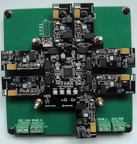

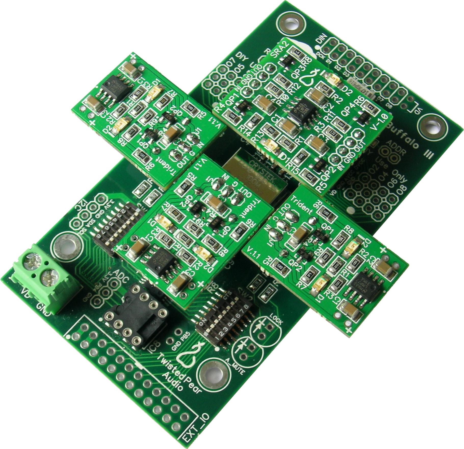

Some examples of other people's ideas below.
Optionally, if one wanted to make the AK4137 board more generally useful, say, for other projects, it wouldn't hurt to provide pads for a clock, voltage regulator parts for it, and a jumper to select it (possibly including the ability to turn of its voltage regulator when it is not in use). That sort of thing could be completely optional, up to whoever wants to design an AK4137 module I guess. Reason for saying I guess is we still don't have a perfectly clear idea of how the project is envisioned to be divided up in modular fashion.
An overall system concept block diagram and some interconnection standards for how things will plug/solder/wire together could be useful, seems to me anyway.

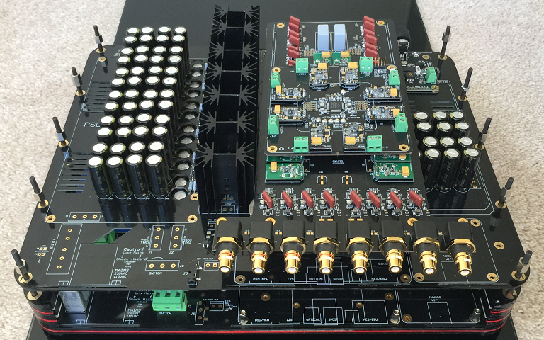

Beginning on defining a system-level design: Thinking of having a main board with very minimal circuitry, actually just the power switch, a power supply for an 8V bus, and the serial isolation circuitry. Given the relatively complex power-up sequence for all the chips onboard, I'm also thinking of putting an i2c controlled PMIC from TI, which will also give metrics on the dac rails, maybe even some current measurements, which may be useful for debugging. I still have some figuring out to do with where I want to put the clocks, more info on that to come soon. I then want to have .1" pitch headers to mount a microcontroller board, this is not a critical or high-speed interface so these should be okay, I also plan on integrating screen control circuitry on the microcontroller board, so plan on including a connector for the screen on the board near the microcontroller. I then want to have likely the following solution, unless anybody has any better recommendations: Individual PCIe cards for the input, ASRC, and DAC chips, with SMA connectors in between them for time-critical signals. Planning on separating DAC and I/V stage into two sub-boards on the same card, clocks will either be on one of the cards or on a seperate card feeding each of the other cards. Probably going to keep jumpers to switch between clocks, can't imagine a time when I would need to switch clocks other than during testing, where the chassis will be open anyway.
PCIe extenders and longer SMA cables for troubleshooting and or measurements?
Also, boards can be too close together if EMI fields can interact too much in a parallel geometry. Already have observed audible issues with too-close-coupling using JLSounds I2SoverUSB and AK4137 boards with AK4499 eval board. Have seen similar/worse issues in RPI hat DAC stacks. Shielding can help a lot, but tends to get in the way of development and or experimentation activities.
