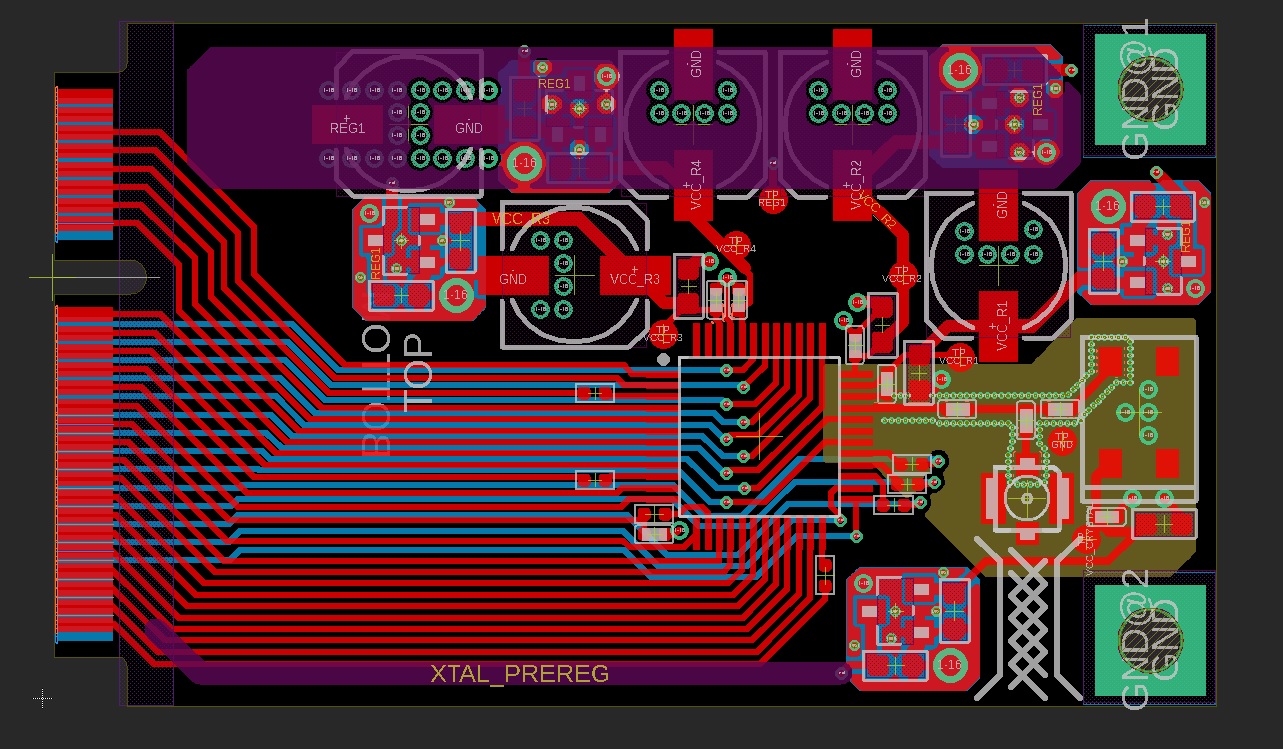

I’d prefer to just run the clock over the board to board connectors if they are designed for high speed use, which a PCIe connector is.
If you are worried about EMI, you can always provision the boards for a shield and you can also bury traces between stitched planes where appropriate.

Concern about running clocks though a back plane is steps need to be taken to assure signal integrity if the clock is distributed to multiple devices in parallel. That is a type of design not typically encountered in dacs where we are trying to keep clock signals perfect. The connector itself doesn't bother me if it is made for high speed use and proven very reliable. (I don't put u.fl connectors in that class as durability is not very good, IMHO.)

toni - What’s up with all those pins? On the backplane, all the lines will be shared so need to take into account which pins for which cards, and i’ll be using I2C control so i suspect most of those are unnecessary.
Been thinking about this project a bit more, figure there's no point in including all of the indivudual voltage regulators from the eval sheet, I think I'm at a point now where I feel comfortable diverging. I just wanted to get far enough that I felt I understood the choices being made on the eval board, and I am now at that point. See the PDF linked in other pages for the "final" version of the eval board schematic. Next steps are defining the PCIe connector interface, I plan on using a 4x slot with SMA connectors for clock and I2S signals. I plan on putting the input connectors on the same card as the AK4118 DIR chip, having another card for the SRC, and a third for the DAC and I/V stage. Debating putting output connectors on the backplane or on the card, it would increase the width of the card past the PCIe specification, making it virtually impossible to use an old PC chassis as a test bench, like I was planning to do, without cutting out one of the slots to be double width. Looking for some feedback around this, how you guys would do it if it were up to you. I plan on getting some schematics, documents, specifications, etc. onto github in the coming days to open it up to input from the community.
Also, looking at the PCIe specification, I see 12V lines, obviously should have no problems running 8V over these, but what about 15V? Figure it shouldn't really be a problem, as a connector is a connector, but wondering if I should put another connector on the I/V stage card and run a cable directly from the backplane.

Wondering if anybody has any resources apart from the datasheets that may be useful in doing layout of this DAC board, specifically the higher speed signals and grounding considerations.

i see they are using source series termination for most of the high speed signals, so I assume one would run 50 ohm transmission lines. For that you need to determine your stack up and trace widths.
I did some high speed designs, now many years ago but there were a few Intel documents on high speed layout, specific to the serdes chips we were using. Also some others too I 'd have to look, its been a while. We were running GHz signals so via design was critical. Have to concern yourself with stubs.
We also used a s/w tool called hyperlynx used for modeling our signals, that and IBIS models of device I/O's. We were using high end pcb layout tools, it was a luxury but these designs can be done if basic rules and techniques are followed.
In a nut shell there are general rules to follow like having a continuous ref plane, controlling the Z using a strip lines or microstrips. Via design. Now that I think about it, way back we referenced a Motorola ECL handbook, authored by a guy by the name of Blood iirc, I think I have it in my disk, have to look. Onsemi still makes ECL logic so that is a good place to look for high speed design info, that and some pcb mfgs have info as well. I will look at what i have, maybe I'll put them up on my google drive for you to review. okay that is what I'll do and provide you with a link.

i am confused I2C spec has max freq stated 5MHz, clock is at 26MHz, at 0.16mm height and 0.25mm trace thickness that is aprox, 52Ohms.
why do we need special connector for I2C(S) while pcie spec is routing multiple even faster signals trough connector? are those differential or what but it should work good for this use.
it is hard to conclude what is needed and what is too much.
also would it be better to pass singal trough few vias and route it in middle layer sandwitched or two middle layers ground while top and bottom signals?
what is with vias dimensions on high speed, what are rules?

No special connectors needed for I2C.
I2S and MCLK are the digital signals we want to keep in good shape, especially so for MCLK. Mostly the concern about things like: jitter introduced by poor connector contacts, ground bounce issues, potential cross-talk, etc.
Regarding source terminated 50-ohm transmission lines recently mentioned by someone, they are not commonly needed for dac I2S signals since the signal runs are normally kept pretty short. In addition, we want to preserve logic levels at the receiving end. At least some dac chips are clearly specified for normal logic level input signals.
Although the AK4499 evaluation board schematic shows 50-ohm resistors in series with the I2S and MCLK lines, they are not located at the source end. Rather they are located somewhere roughly in the middle of the lines as damping resistors for non-impedance-controlled interconnections.
The idea with the modularity is to have this design as easy to iterate on as possible, maybe once it’s “finalized” a single board solution would be preferable. I’d like to be able to swap out any individual module without having to get the whole board remade, and the modularity lends itself well to a relatively small form factor IMO because of the stacked boards. Yes the connectors will add expense, but it should only be a one time cost with the advantage lasting the lifetime of the DAC. Also, I plan on releasing the source files for this project under CC-BY-NC or CC-BY-NC-SA, any thoughts on either of those?
