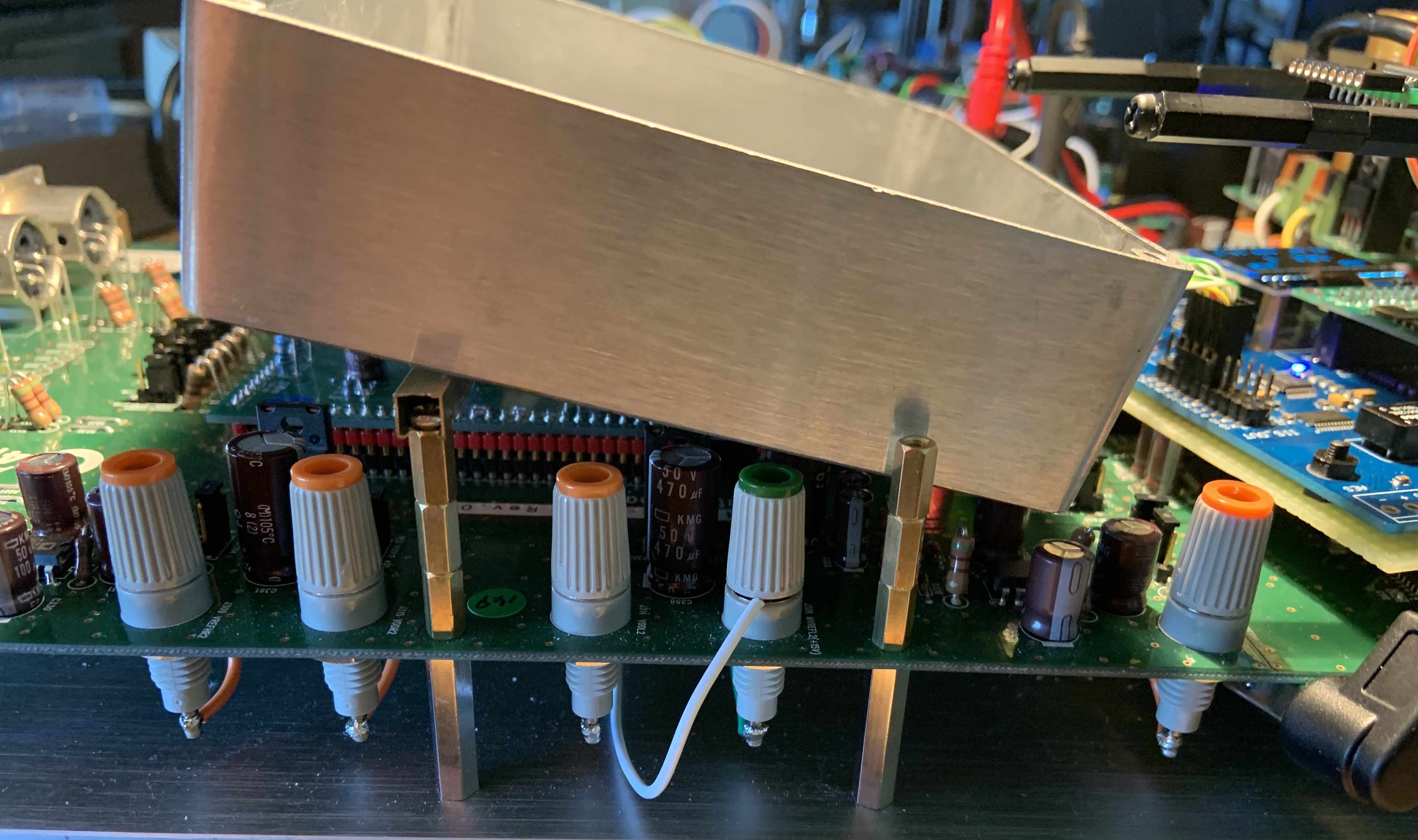

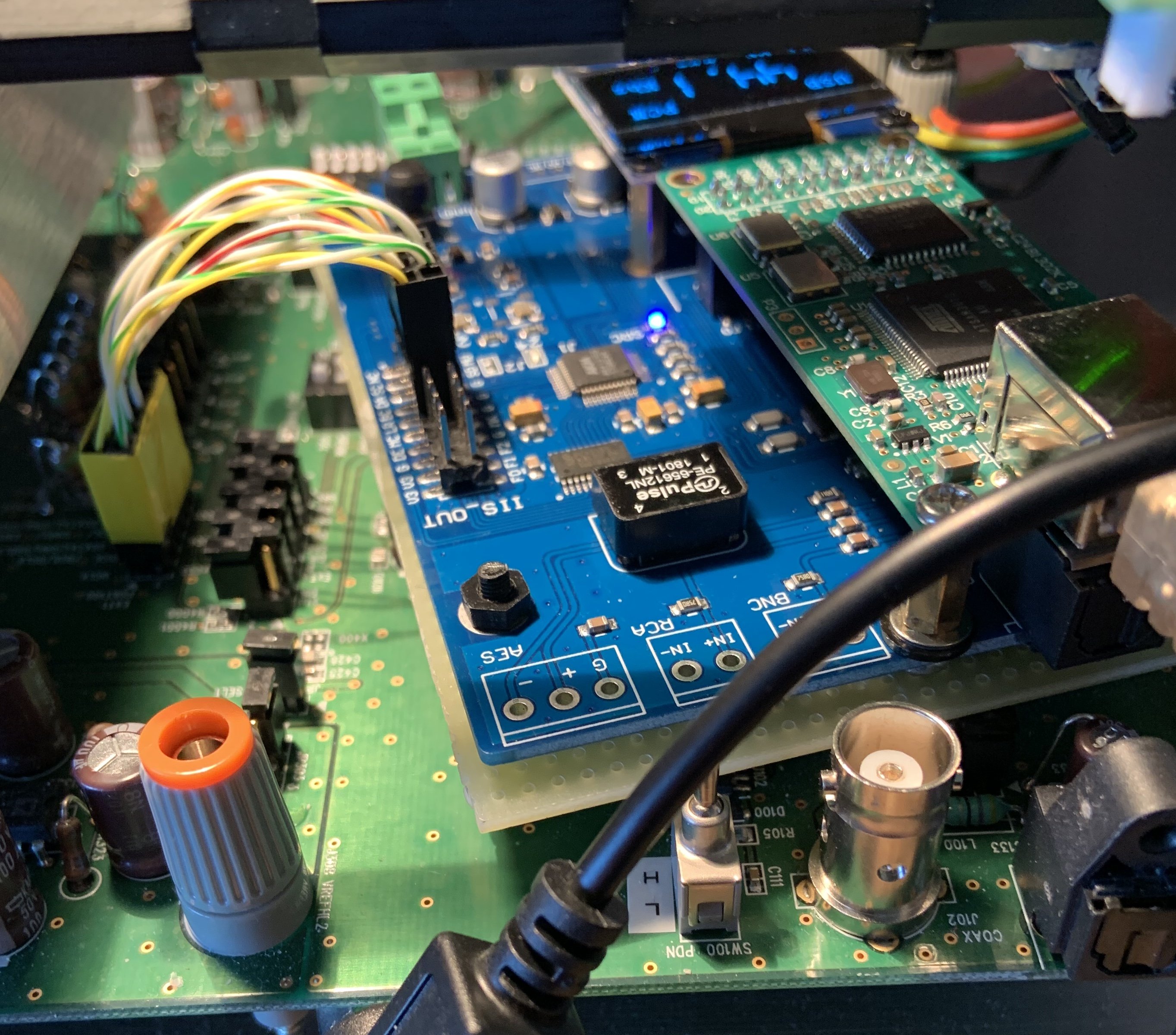

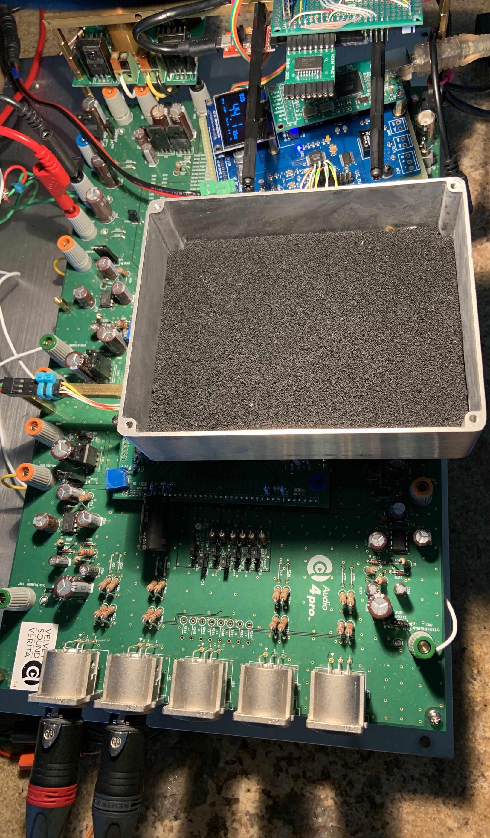

Perhaps some info of interest to AK4499 dac builders: Just tried hooking up an external AK4137 board to the AK4499 eval board. When set to DSD256 it sounds better to me than some (or many) of HQ Player conversion options, but not better than the very best and most computationally demanding options HQ Player can do.
Some pics below for your viewing pleasure. An Amanero USB board is used with the AK4137 because the two are designed to easily plug together and ASIO drivers are available. The I2S wires were left longer than might have been best, but I wasn't sure how the board was going to fit in the space available. A bare perfboard was attached to the bottom of the AK4137 board to provide some safety insulation.
Also in the pics the bottom half of a Hammond box can be seen sitting on top of some of the eval board. It seems to work best were it is shown sitting to help provide some shielding between the more sensitive dac circuitry, the AK4137 board, and the I2S interconnection wiring. I just moved it around to find the cleanest sounding spot 🙂

Mark, trying to bring this thread back OT yet again — thanks for all the help in that regard. Wondering why you’re using the external 4137 over the one on the eval board, I imagine the implementation can’t be that different. Is it just to interface with the Amanero USB module?
Adam,
The eval board AK4137 might be preferable in some ways, however the eval board does not provide an option to route external I2S input through the AK4137. It only allows optional use of AK4137 in conjunction with the AK4118 SPDIF receiver.
Possibly eval board PCB traces between AK4118 and AK4137 could be hacked to allow insertion of external I2S. The setup in the pics was easy for a quick tryout.
Also, some suspicion the AK4137 board in the pics could sound a little better than I have it now. Used its clocks, and also its default configuration which takes the MCLK signal for AK4499 from the AK4137 chip rather than directly from the clock modules. Pretty sure the clock modules direct should be lower jitter. Don't know if I would need to buffer them. Also possible to try different clocks, improve their power supply, etc. Don't know which mods might help most. Always ways to spend time experimenting with DACs 🙂
