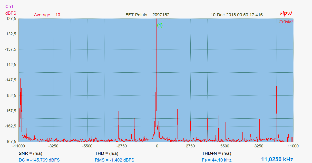

For comparison, I would show here the 'classic' results that I regularly obtained from the 'previous level upgrades'.
First is the distortion spectra, second graph is the jitter spectrum from the end of 2018:

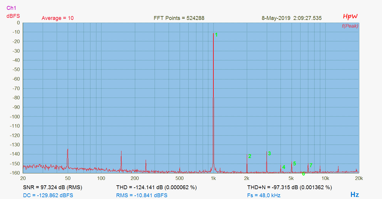

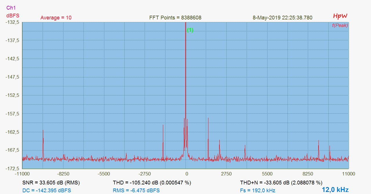

After this last little correction in the power supply topology,and some new power supply modules applied the same measurements look like this:

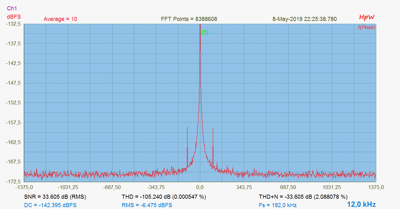

first is the distortion plot taken same days ago, second is the jitter spectrum, third is a zoom-in in the jitter spectra.
Again: this is obtained with the 'old' Xmos implementation, (no galvanic isolation scheme), NDK SDA clocks on board, new LT3045, LT3094 preregulators, slightly modified discrete output shield with updated SITO discrete opamps, differential output into the RTX6001 diff. input.
For the jitter measurement the Mirand V1.0 had been driven 384kHz/24bit resolution, 12kHz test signal, Full scale (0dB). The recording was done with the RTX6001 ADC at 192kHz ,20dB attenuation setting, so the recorded level is -6dB.
384kHz drive was applied so as to stress the dac as much as possible. (at lower speeds the result is cleaner)

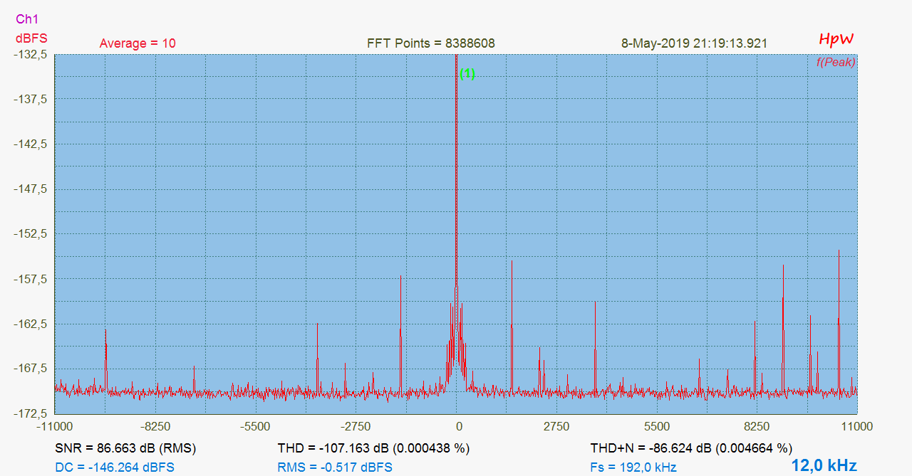

Finally here is a loopback test of the RTX6001 analyzer itself, it's built in dac / ADC driven at 192kHz (the max. possible). So the jitter spectra is in a slight 'advantage' with respect to the 384kHz testing.
As visible, the artefacts around -9600 Hz and the modulation lines around the carrier at ~+-1400Hz are common to both the previous and this graph, so most probably a product of the RTX6001 ADC itself.
