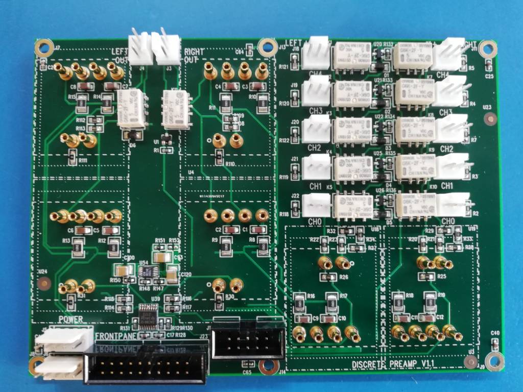

Just a short update.
Turned out that some of the relays that i use from Fujitsu is not in stock. So instead of have some boards populated with fujitsu and some with omron. We ordered Omron friday for them all. The arrive tomorrow.
Model number : G6K-2FY 5DC
They are SMT. So we want to populate them in 1 run.
The Preamp uses the exact same firmware as previous board. So no need of work here.

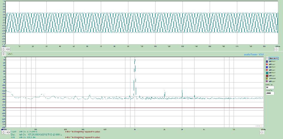

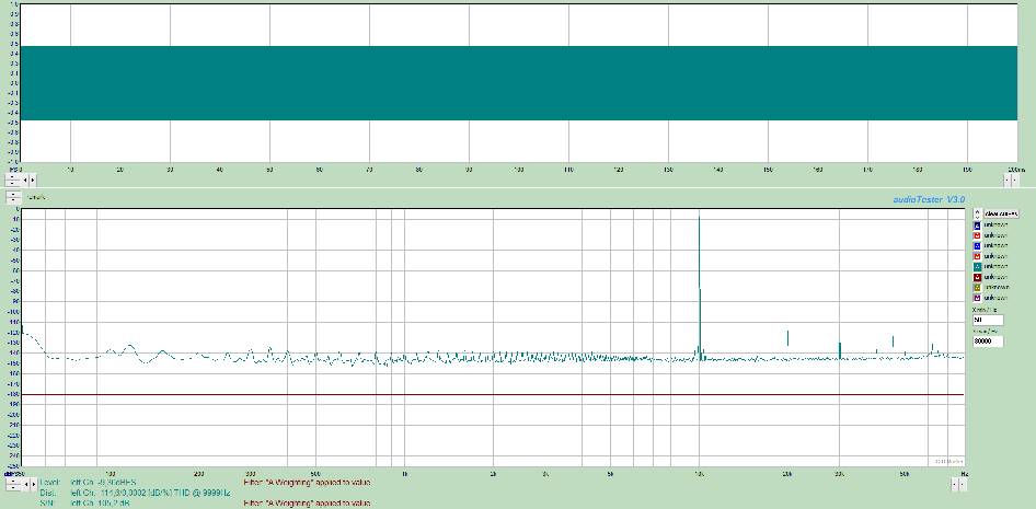

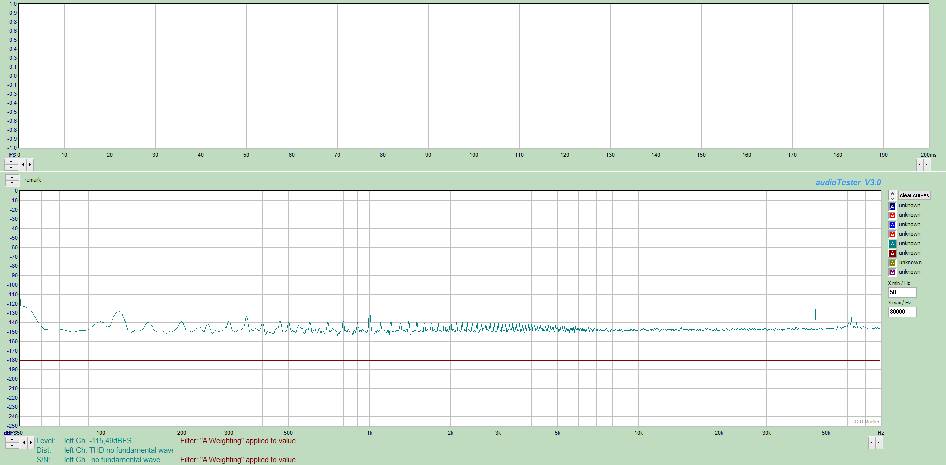

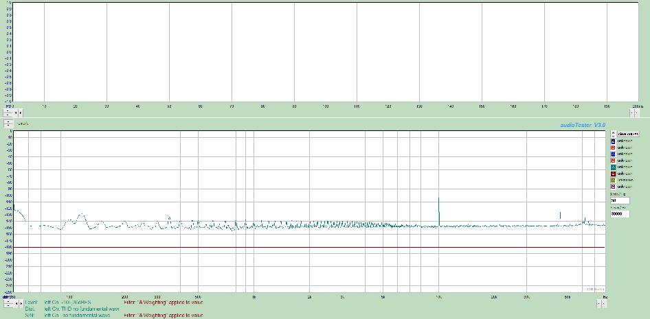

Distortion and cross talk is good...
I would recommend a wall between psu and preamp board... To get maximum out of the noise floor.
Dropbox link instead with high resolution images
Dropbox - preamp v1.1 6V 1k gain -7dB.bmp - Simplify your life
Dropbox - preamp v1.1 6V 5k gain -7dB.bmp - Simplify your life
Dropbox - preamp v1.1 6V 10k gain -7dB.bmp - Simplify your life
Dropbox - preamp v1.1 6V 1k gain -7dB cross talk.bmp - Simplify your life
Dropbox - preamp v1.1 6V 10k gain -7dB cross talk.bmp - Simplify your life
Crosstalk is -109dB at 1KHz.

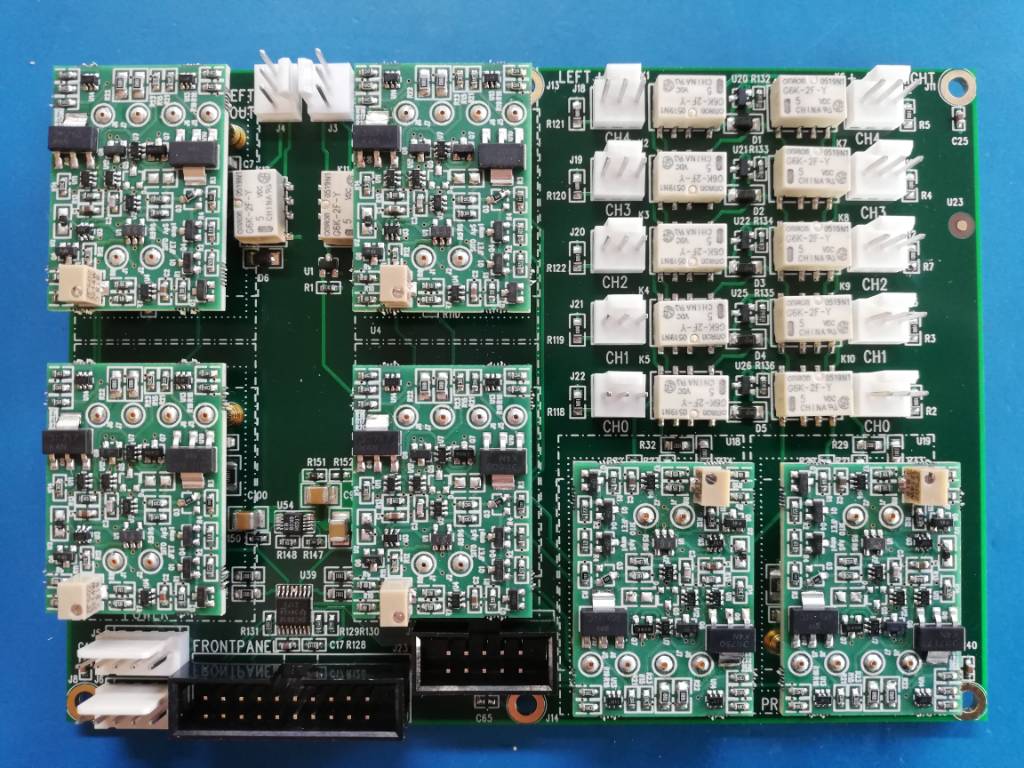

@sonnya accepting any more orders for the pre-amp at this stage?
Yes we do.
The motherboard could also be ordered without modules. And people can insert modules like Sparkolabs SS2590... Only limit is size... No more than 28mm width.
Only thing i do not know how other modules perform. But i would choose something with JFET or Mosfet input.... Speaking mosfet.... More to come if the behave like i want them to.

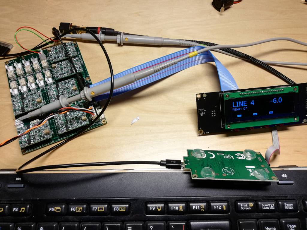

I am on my way to munich. I will find time answer them tomorrow....
In the mean time, dac and preamp is connected together using oled display.
There is two firmware package for the DAC. Which both runs.
1) simple 7 segment
2) oled display connected to the DAC using 10 way ribbon cable and i2c bus as interface. It is a polling function where the oled display updates 4 times per second.
We will do a third version which is a variant of the simple display. With a few led and a couple of button. Just to keep it simple...
