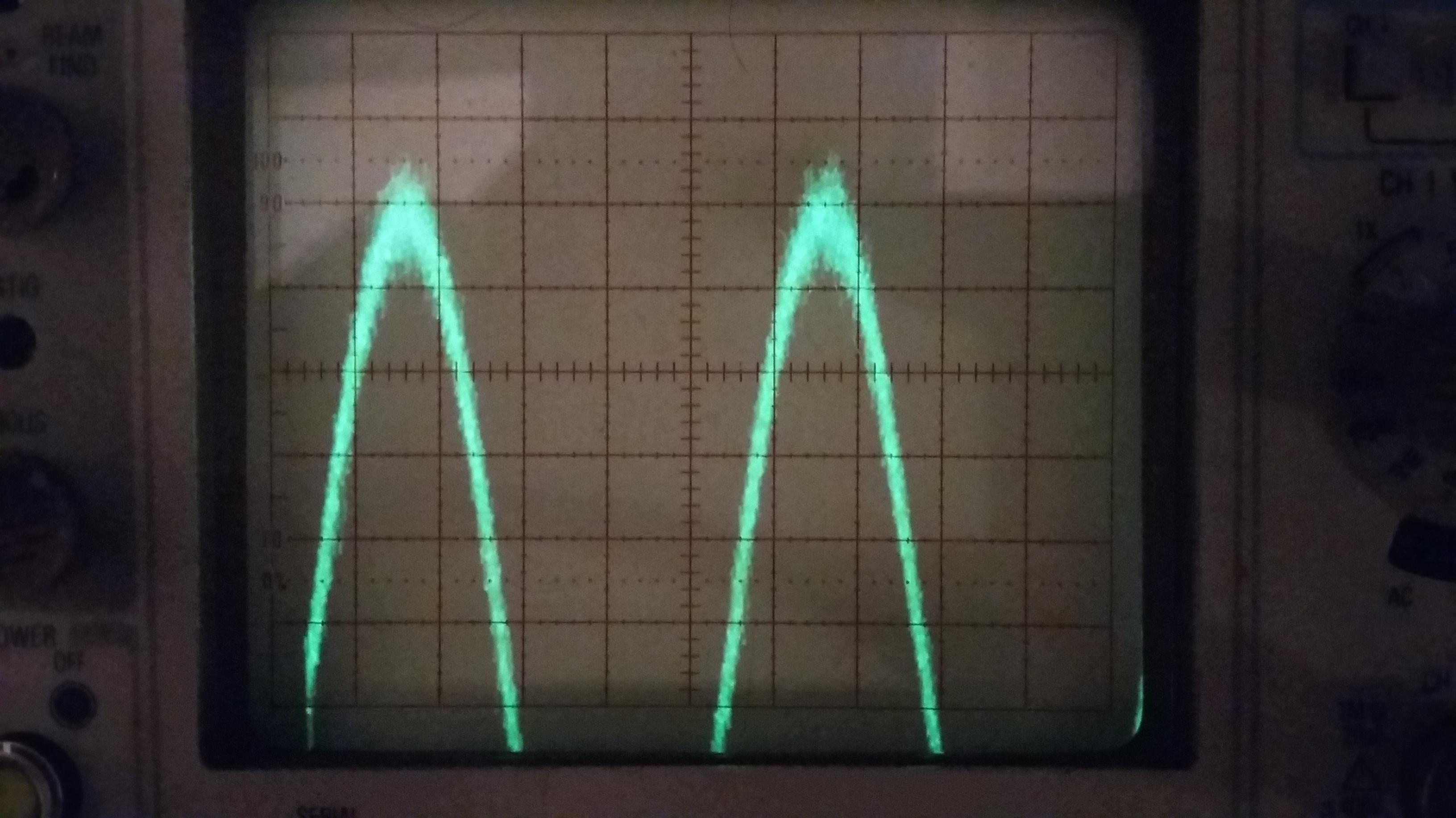

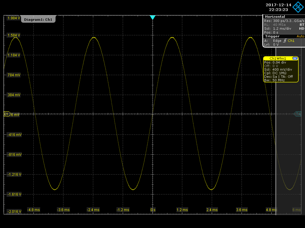

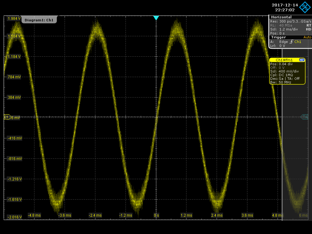

So I did a little trip around, tried to have a look by other means at my disposal.

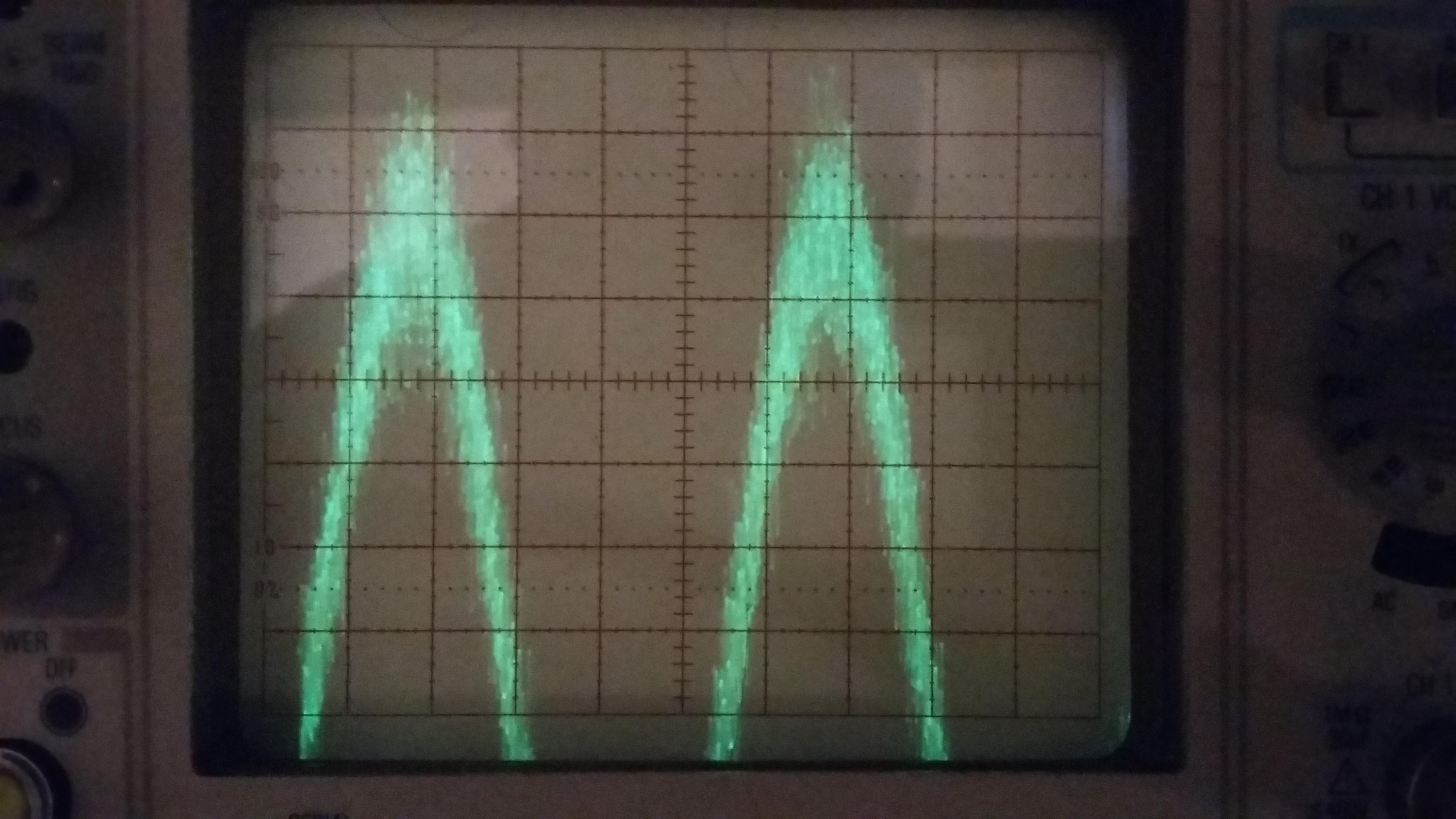

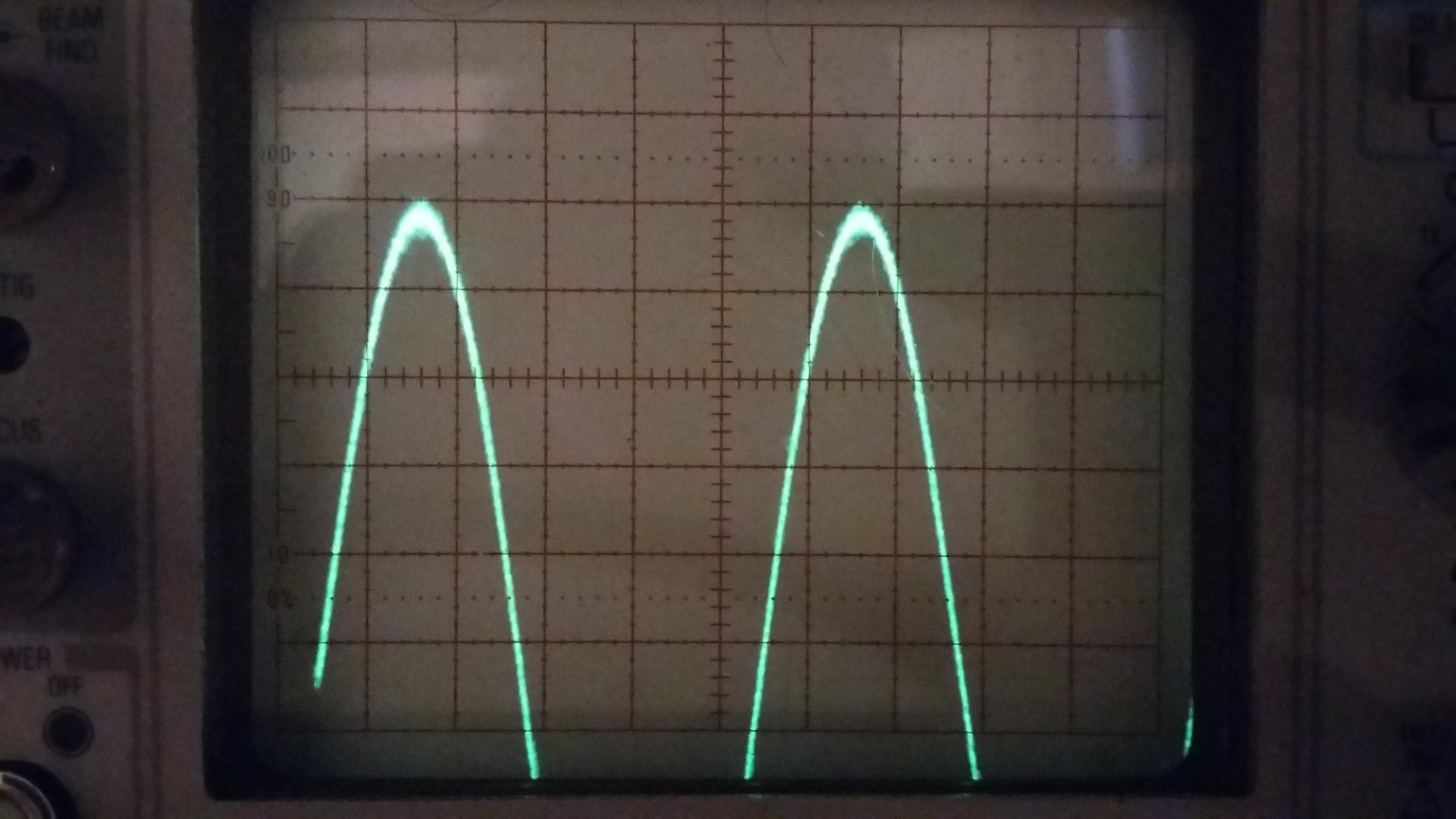

First I was curious if the observed noise floor behaviour can be confirmed..
So as a first approach, had taken some analog scope shots.
Old tek scopes cannot lie!
The first shot is DSD 64, the second is DSD 128, third is DSD 256.
The same test signal as from those in post1475; 76

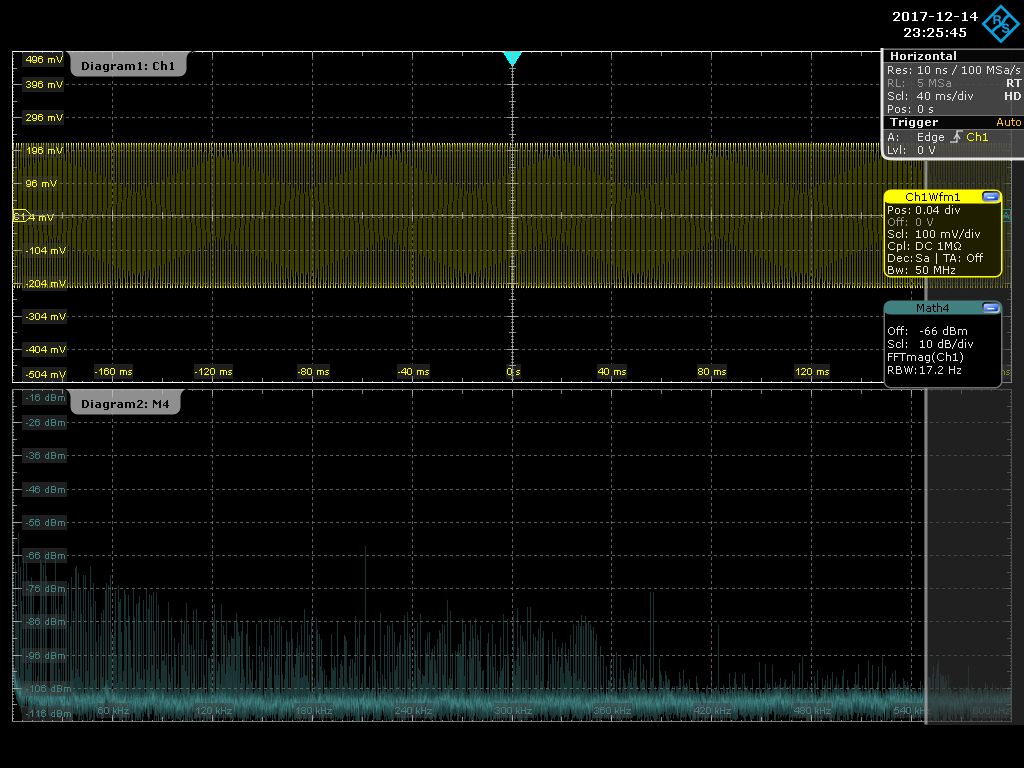

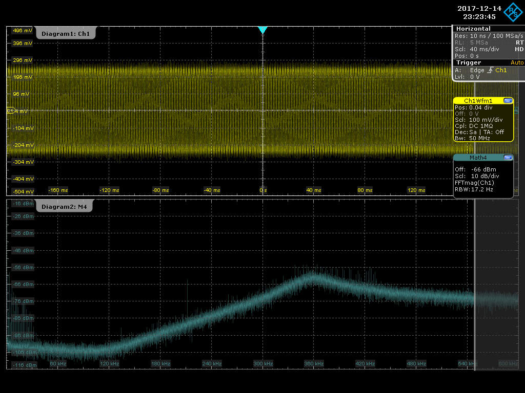

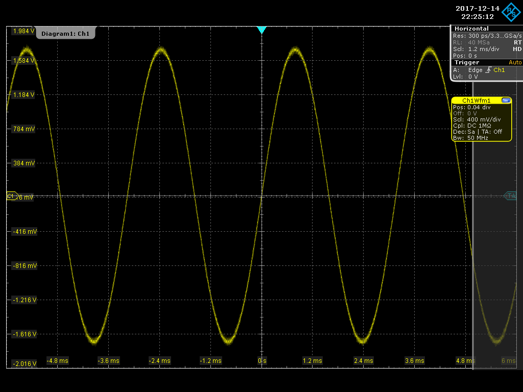

The same scope trace shots again but with a bit more sophisticated tool
First is pcm 384kHz, 24bit (as upsampled in HQplayer from the original 96kHz /24 bit signal)
Then the same signal but upsampled to DSD 128; finally DSD 256 (using DSD7 modulator)

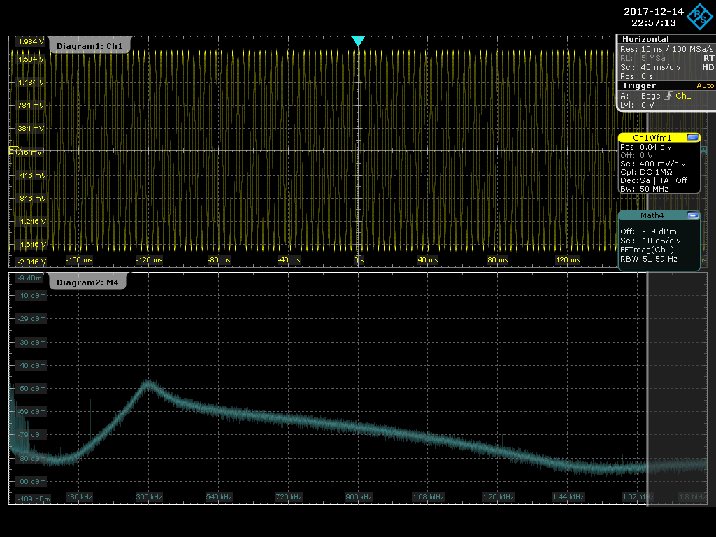

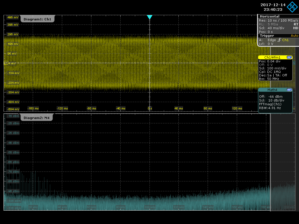

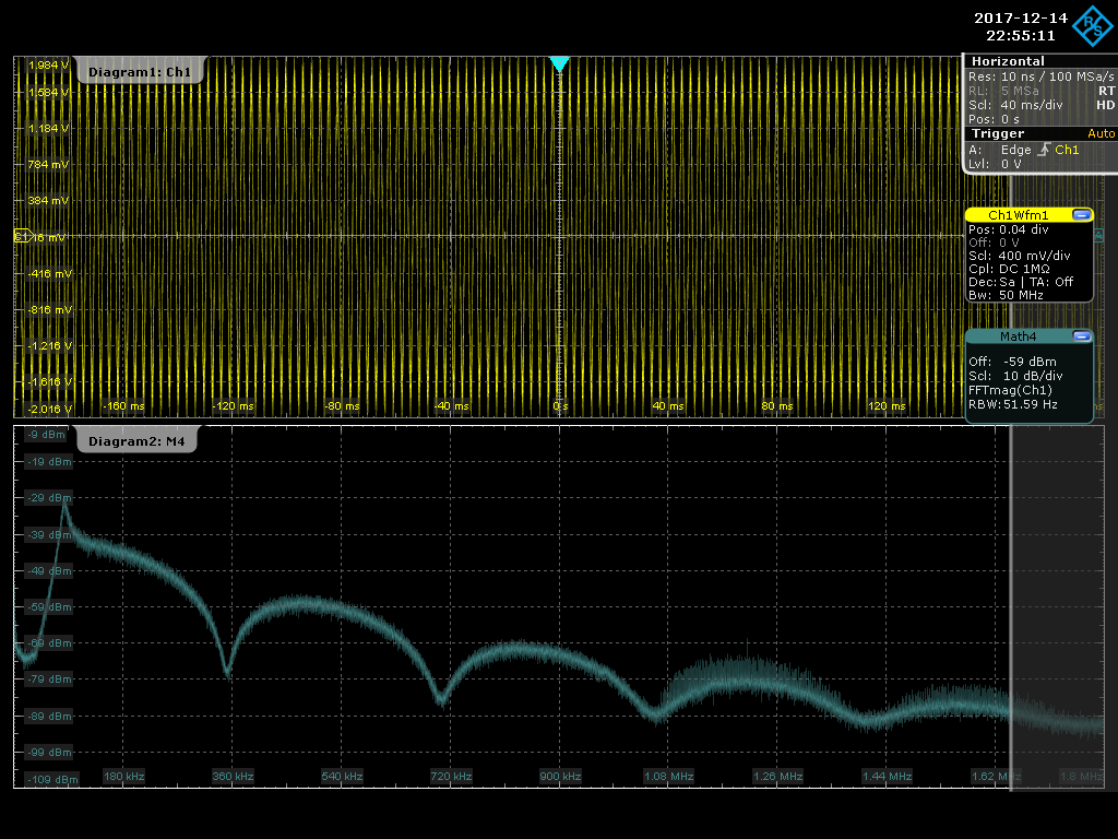

As visible, the signal is showing the artefacts of the different modulation schemes in the upsampling & noise shaping process. DSD256 upsampling is pushing the noise peak further out above the audio range, and the overall noise load in total is also less.
Finally, here it is a closed-in comparison of the same signal (-20dB 96kHz/24bit test signal) as reproduced by the Mirand dac (V 1.1, modded) as 1.)pcm 384kHz processing 2.) Upsampling to DSD256
The same again 1.) PCM 2.) DSD 256 at 600kHz range
Question of 100$ : which signal shows less signal-dependent high freq hash... ��

After all this detour..
My attempt at answering would be: I trust very much the results from the AK4396A as implemented in my soundcard. It is showing very close performance to the RTX analyzer.
One factor that can influence the ADC sampling is if high frequecy added noise is so agressive that it can get through the input low pass HW filters and provoces aliasing in the output data.
As visible something like that happens indeed at lower DSD sampling rates; at and above DSD 256 instead the rise in the modulator's noise gets pushed out so far above 96kHz that the ADC input filters are getting effective again. So I think the data becomes reliable as usual from this card.. (the EMU1616m)
Ciao, George
are your DSD measurements valid?

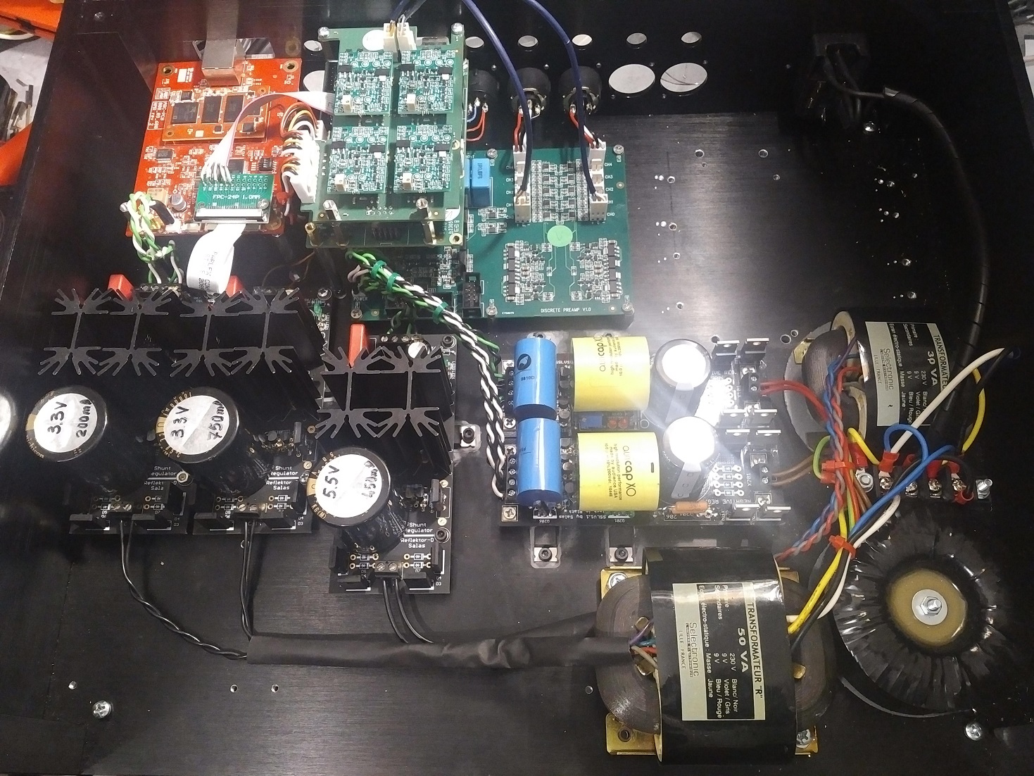

Hi Vitalica,
Very nice build!!!
Do
Thanks Domenic 🙂

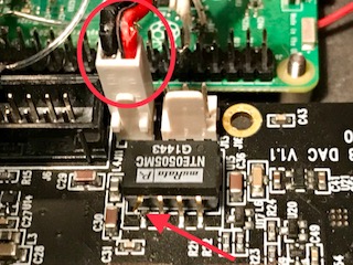

I'm surprised how well Renderer now sounds after I have separately powered the Clock and MR-MOD Ethernet Media Renderer Modules on the Renderer board.
I thought this would be OK to do it in DAC V1.1.
But I probably have not asked a correct question and Sonny will not answer me. I think Clock on DAC already has separate power.
Anyway, the sound is fantastic!
Thanks Domenic 🙂
It is not an easy question as the answer is difficult. 😉 and it was not intended to do so. We have an internal power called +3.3V_OSC. You will need to remove a part to be able to replace the power.
So, it is more complicated... In this case, it will remain as it is and I will add the separate power to USB, as suggested by Anders. Thanks, Sonny.
