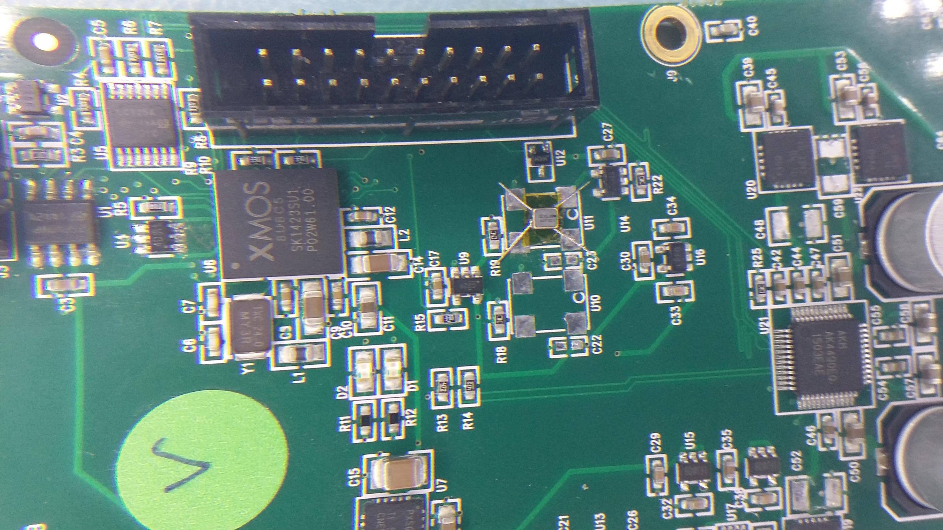

Post 1209. I had fallen into that little trap. Have ordered the parts first, started to think after.. the usual error. Anyway it had been cleared in a private message with Sonny that also he had looked over that particular feature.
So always control if the substitute oscillator is having a disable feature or not.
The Mirand design needs it.
Here it is how it's done

I had bought them from Lorien, he sells them here in a 3D.
Yes you need the 41kHZ and 48kHz sampl. families.

The one You see implemented in the photo is the 22.579MHz one. (44kHz family)
The one below will be the 24,576MHz one (48kHz family)
The original FOX crystals had been custom configured - as such, they do not have the value engraved on top. (Had to find out myself)
