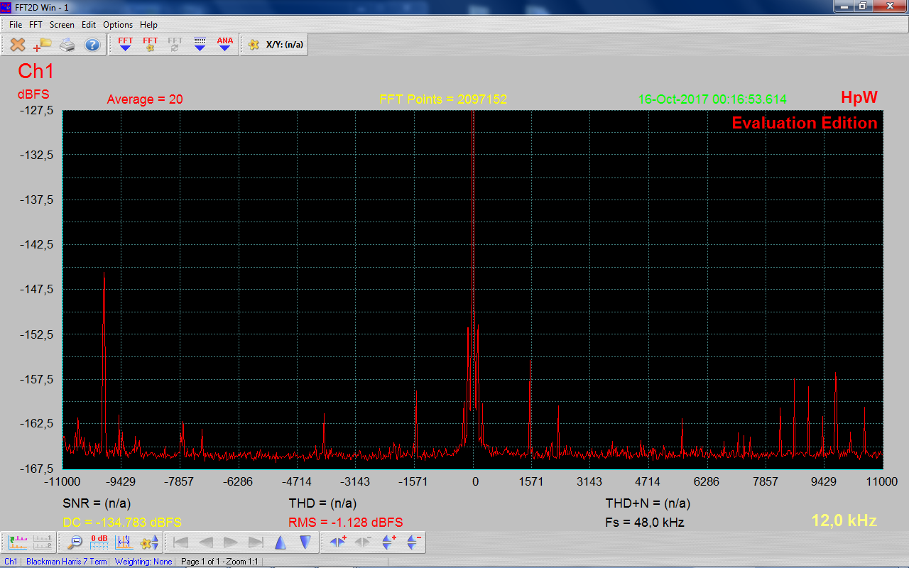

Given that the talk turned to the quality of clocks in these dacs..
Here I would like to show a little test that I wished to do.
With this new arrival, the SITO V. 1.2 dac equiped with very good quality clocks, dedicated power supply, & galvanic isolation - I had been wondering if one would be able to detect any measurable changes due to this. I mean any change from the previous model Mirand V 1.1 dac to the SITO dac.
The old model, as we know, is based on Fox Xpresso crystals, have a mixed power supply scheme and is not isolated galvanically.
It looked to be not that easy because the usual jitter tests already for the Mirand dac looked quite clear.
So I tried to push the setup to the limits.
I drive the DUT dac modules into my usual EMU1616m card with AK5394A.
The dac is piloted in upsampled PCM mode, set to 384kHz -so as to stress as much as possible the jitter response.
The sound card is used instead in it's cleanest mode, 48kHz/ 24bit recording.
The first shot is the Mirand V 1.1 original version.

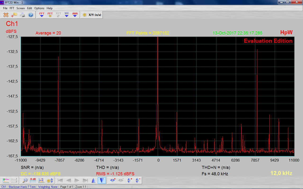

The second shot is the SITO V. 1.2 new version, tested on it's USB input, with USB power external.
  • SITOV12_12k_384ksmpl_emu48ksmpl_fullgraph_jitter_okt15_No_display_2ndtake.png
The samplng rate is 48kHz multiples, so the test signal is FS/4 frequency, 12kHz tone.
Almost full scale.
In the first graph , the un-isolated Mirand dac shows an obvious modulation at the standard 8kHz high speed USB frames frequency; plus a series of spurs at 1kHz distance, 1msec USB packet signaling.
The 4,5-4,6kHz side lobes most probably are due to the Fox oscillators.
There is a non- zero contribution also from the soundcard itself -- those spurs at 1.5kHz and at the top freq.range. one can observe all these still present also in the SITO spectra.
On the other hand, the SITO V. 1. 2 spectra shows a much cleaner picture, almost all USB correlated signatures are gone, mainly the soundcard related residuals are left only. (And a spur tone at 2kHz, plus a little 50Hz contamination )
So, I would say that the choices made by Sonny - - are working..
Ciao, G
