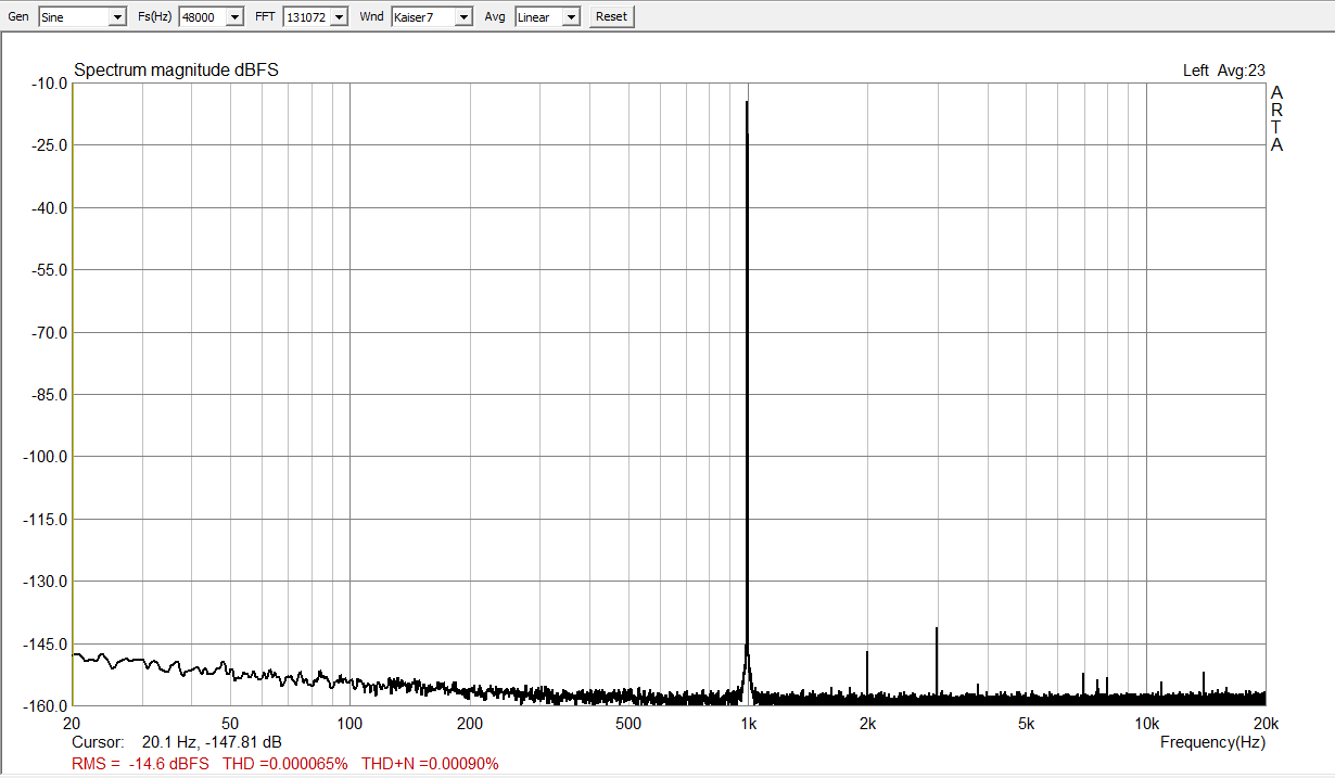

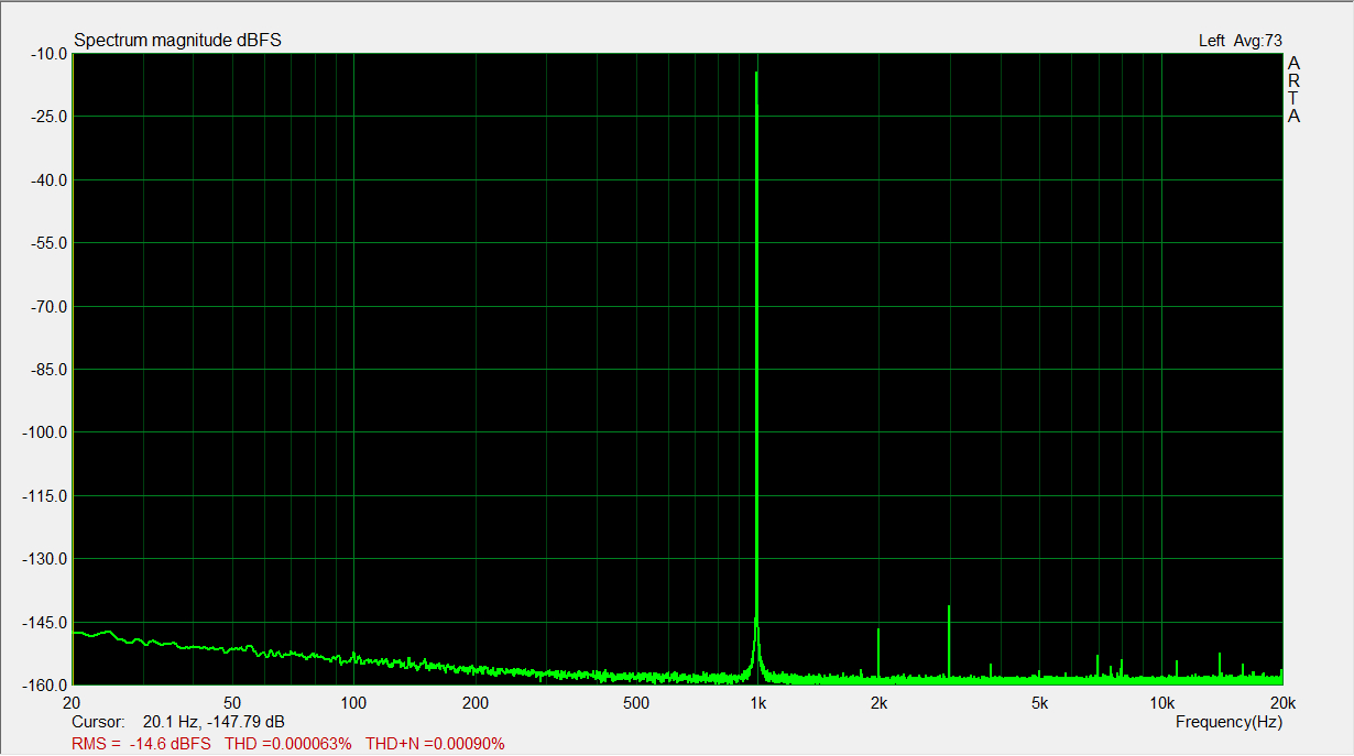

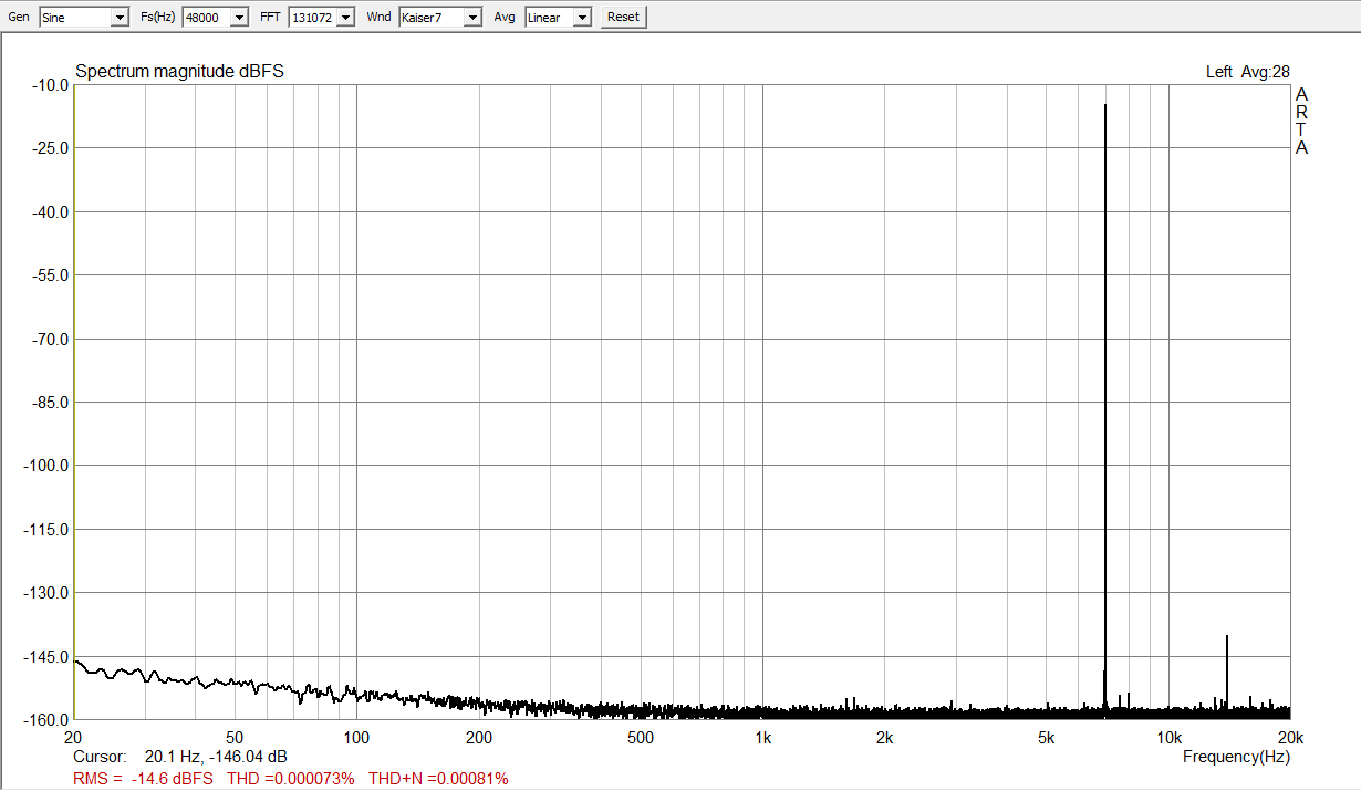

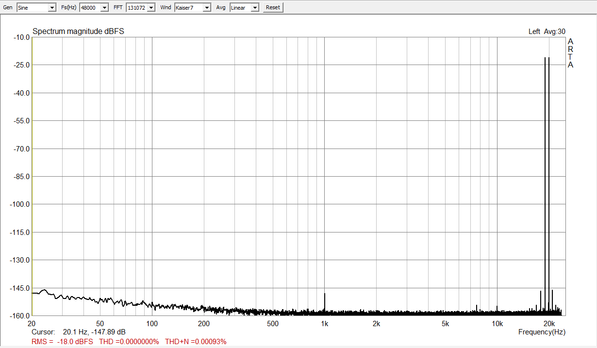

Those are exceptional results. Almost hard to believe considering this is a discrete design. Very low noise and distortion, the latter stays low at high frequencies, remarkable.
A couple of questions:
What have you modified on the DAC? Galvanic isolation for USB? (I see you have fixed the ground loop issue).
Have you tried single-ended measurements?
Hats off to Sonny, I don't see this kind of performance everyday.
