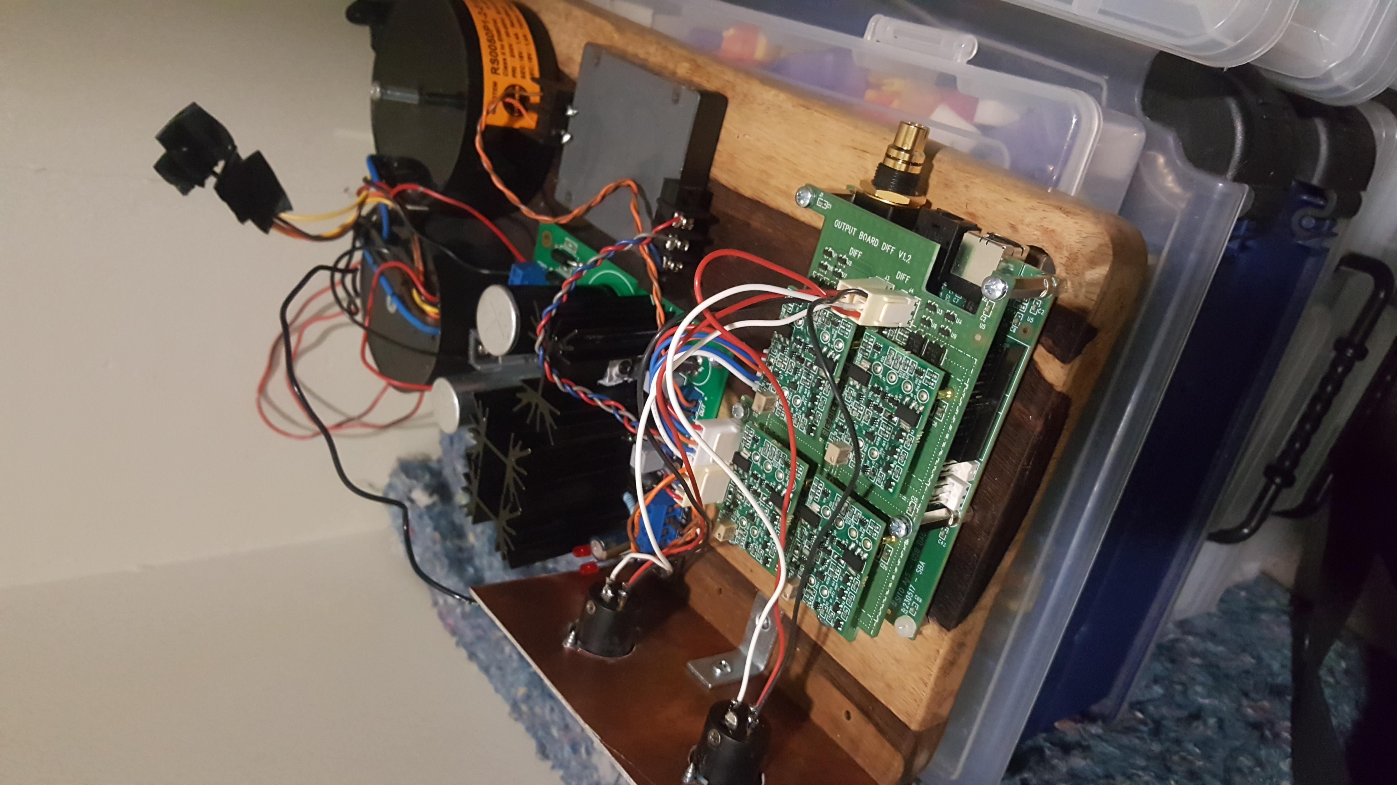

Hi, received the package. Xlr discrete output
I have problem turning it on
1. Voltage 5. 5v using salas reflector 600ma
2. 14.92v 1.5a a plus minus using just regulator
3. Display not installed.
4. Tried my handphone. Usb out, song still comming out of mobile phone speaker
5. Tried using dap with optical out nothing
What am I missing? Thanks

OK got it..

Anthony,
The only digital supply is 5,5V.
This is what you have to feed to the board, together with +/- 15V.
Or did you mean J11?

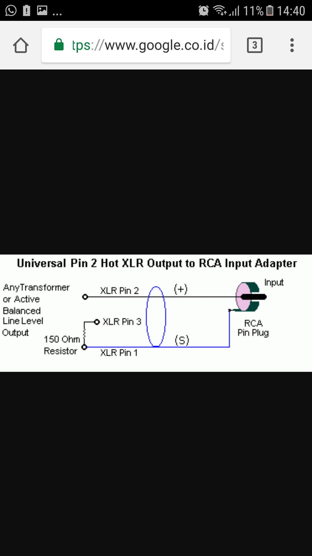

Pinocchio, do you mean the onboard balanced output connectors?
They are like this: (top view)
Se- | Se+
Gnd | Gnd
Se+ | Se-
The (+) amplifiers are summing the balanced dac outputs into Se + signal (upper row, below connectors)
The(-) amplifiers are inversely summing the balanced dac outputs into the Se - signal (bottom row)
