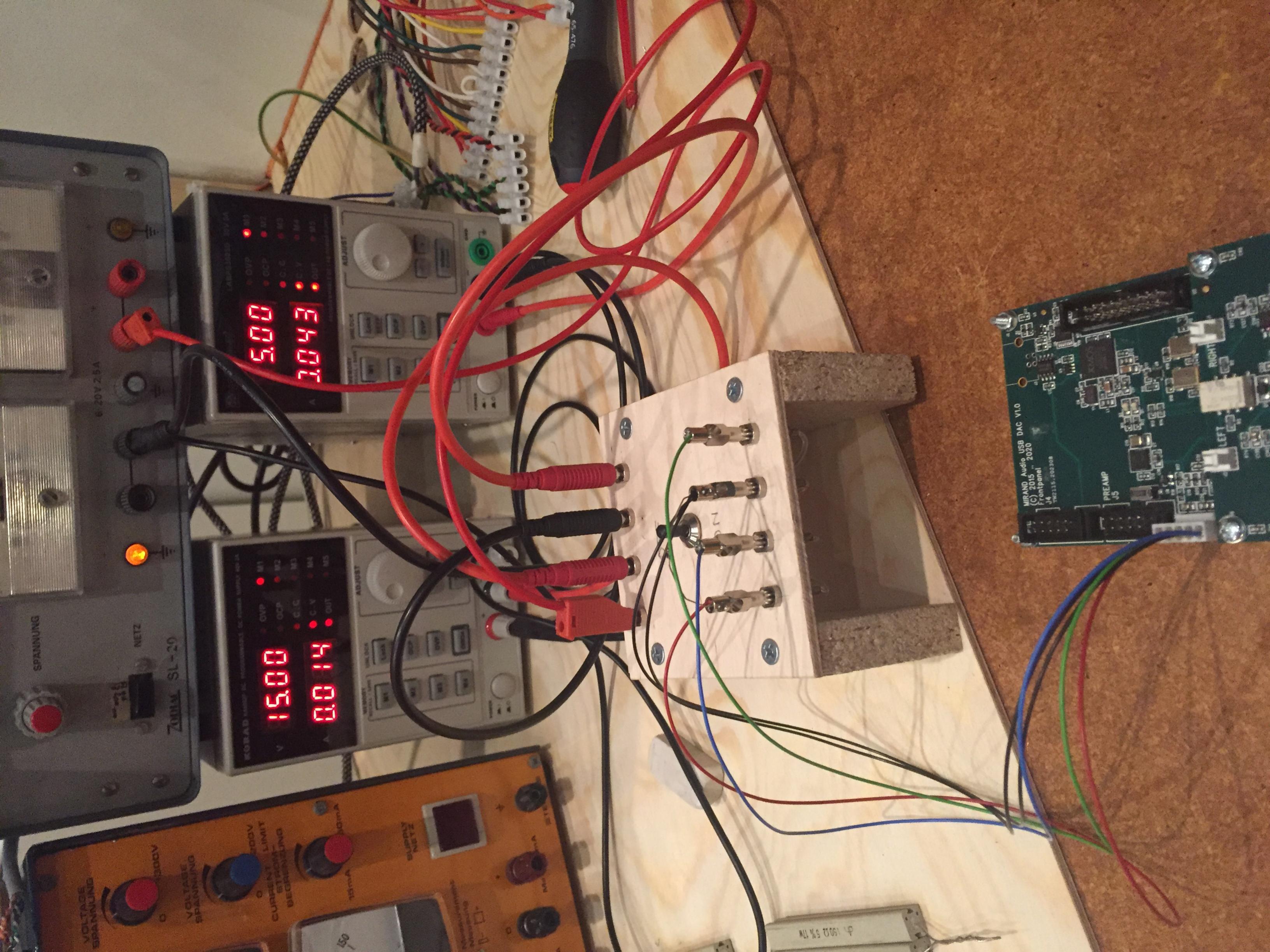

I rigged the DAC up on the bench to watch the currents. Positive 15 seems to take a lot more then -15 in idle. Is this normal values? (It is 15 on the right PSU also, the 1 is hidden on the pic)
