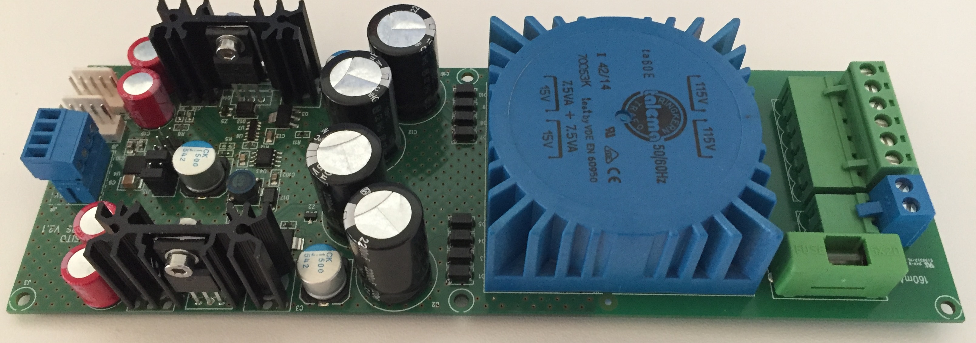

LPS V2.1 is 129€

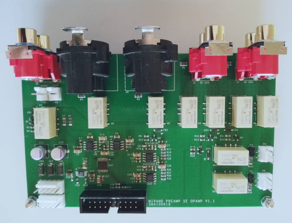

I got asked for the data on the Sales offer preamp board, so here it is.
It is a JFET opamp based preamp. All inputs are handled as differential also RCA input.
Input impedance is: 20KOhm.
Output impedance is: 100Ohm (Set by series resistors) Output is shorted to GND until frontpanel timeout has elapsed to prevent clicks and pops.
Volumecontrol is handled by a very good R2R dac form TI called DAC8802. Logarithmic setting is handled by display.
Supply voltage for the R2R DAC is delivered by the ultra low noise LT3042. To make the volume control as clean as possible.
To summarize:
To summarize:
- Input: 20KOhm
- Input: 4 channels -> 2xRCA + 1xXLR + 1xAUX RCA/XLR
- Relay based input select.
- Output: 100Ohm
- Output: Single ended.
- Gain: +6dB
- Size: 130x80x40mm
- Power: +/-15V 40mA, +5V 200mA (Due to relays and OLED display)
- Vaolume control: DAC8802 (14 bit)
- Supply for DAC8802: LT3042
- Opamp: OPA828 (OPA627 replacement - High-speed (45 MHz GBW and 150V/μs SR), low-noise (4nV/√Hz) RRO JFET operational amplifier)
