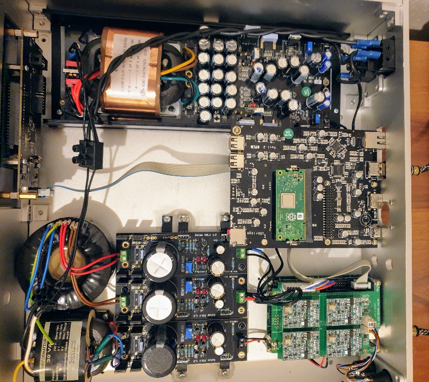

DAC V1.2a

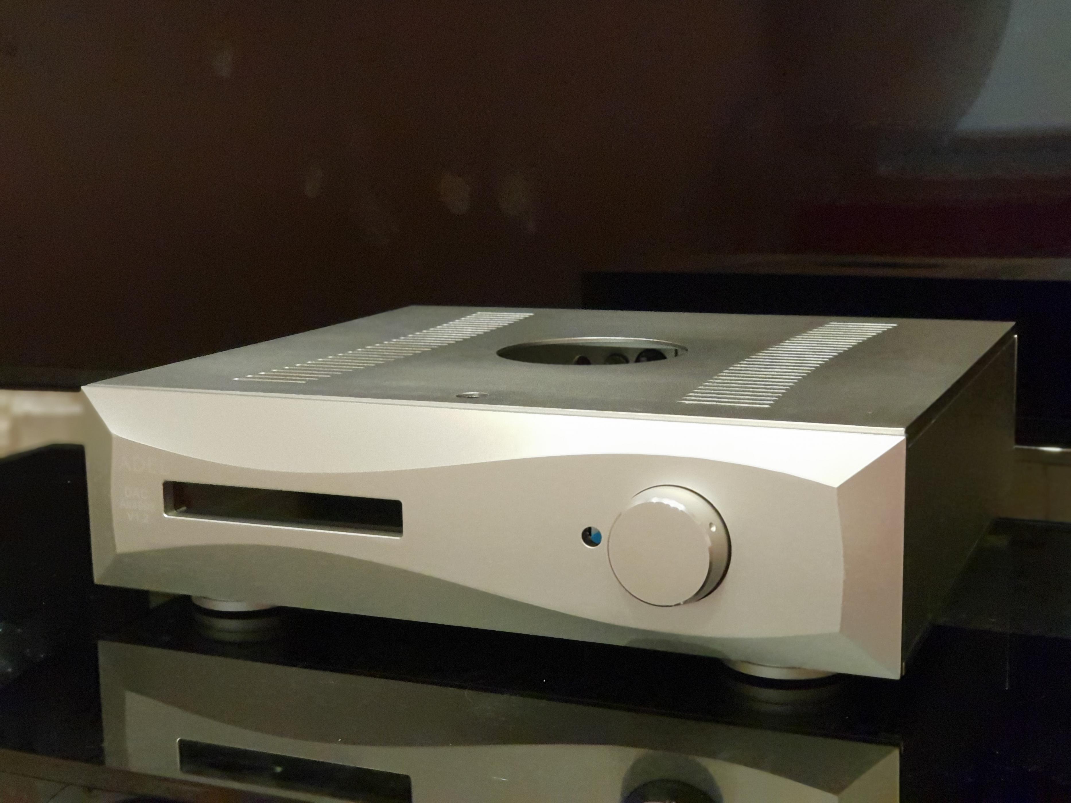

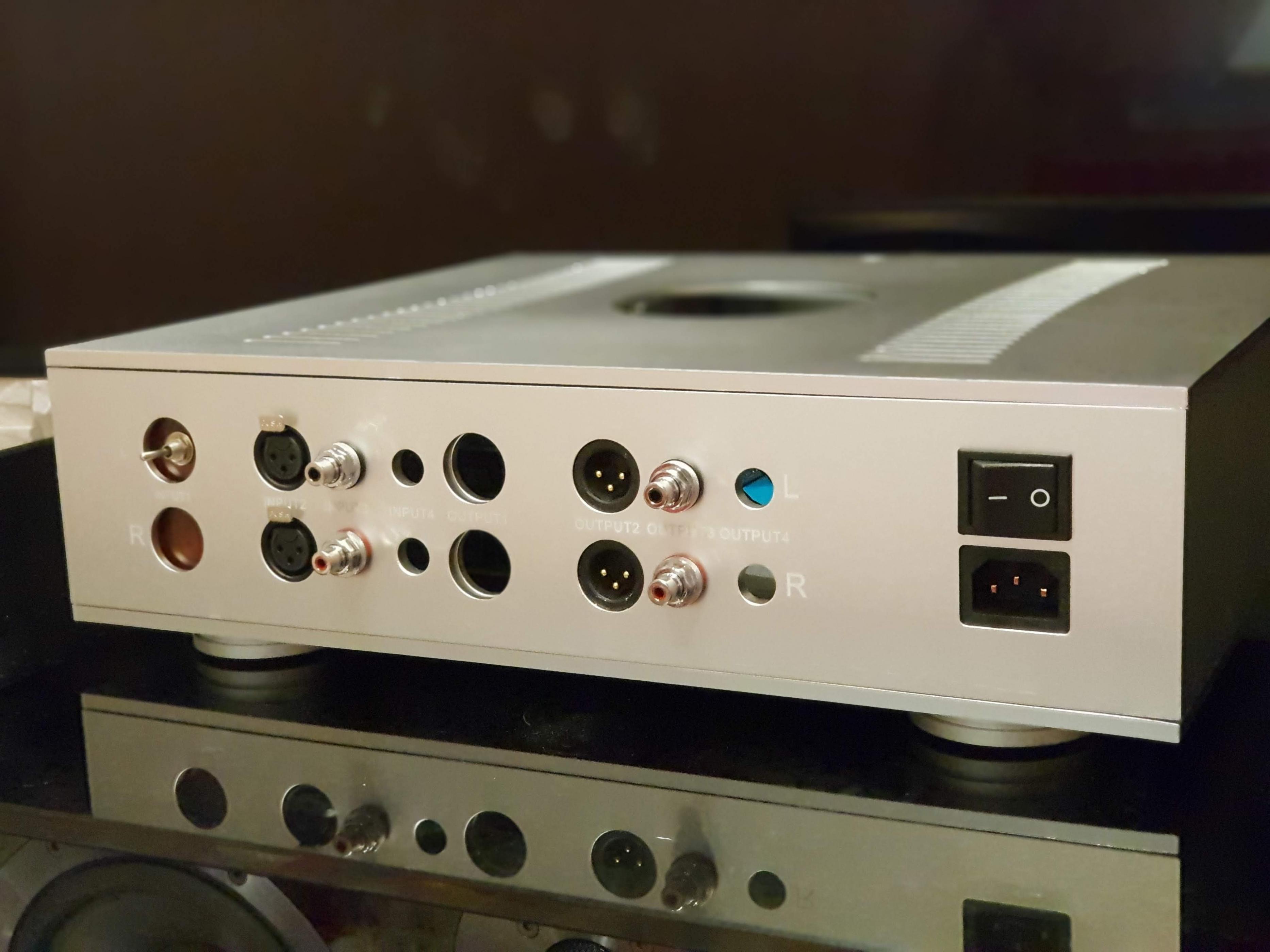

In the picture my new DAC Mirand V1.2a with USBridge Sig, PSU Shanti, PSU Salas for I / V and USB input. For me it is the most musical DAC right now. well. Thanks a lot to Sonny for this DAC jewelry! He is in the highest league!

Very nice setup, congratulations!
And on a more general note: feeding the Mirand dac from a "renderer" or streamer device, like You are doing here with the USBridge Sig, is really pushing the sound quality an another step forward.
I'm wondering how many of you out there is doing it?
Ciao, George

I too think a decent streamer/source makes a significant impact on the Dac. I use the old USBridge (powered by shanti - made a big difference), but tempted by the new signature variant

Congratulations! An awesome build that I imagine sounds very good. Excellent source and PSU's.
Quick Q, why did you not keep the top lid on the Shanti for RFI/EMI? Also, that cabinet looks very nice, decent thick walls etc. It looks like a DCS chassis, where did you source it from? Last Question! Did you try the DAC on the standard SMPS prior to using Salas' PSU?

Everything looks awesome. The case is very pretty! I like the way you use inside screws.. from outside you don't see them, correct?In the picture my new DAC Mirand V1.2a with USBridge Sig, PSU Shanti, PSU Salas for I / V and USB input. For me it is the most musical DAC right now. well. Thanks a lot to Sonny for this DAC jewelry! He is in the highest league!

I removed the cover for technical reasons, initially I used an Odroid C2 for the NNA, which did not fit the hole due to Shanti height 🙂 The case made a friend, who makes them to order. I have never tried the SMPS source.
