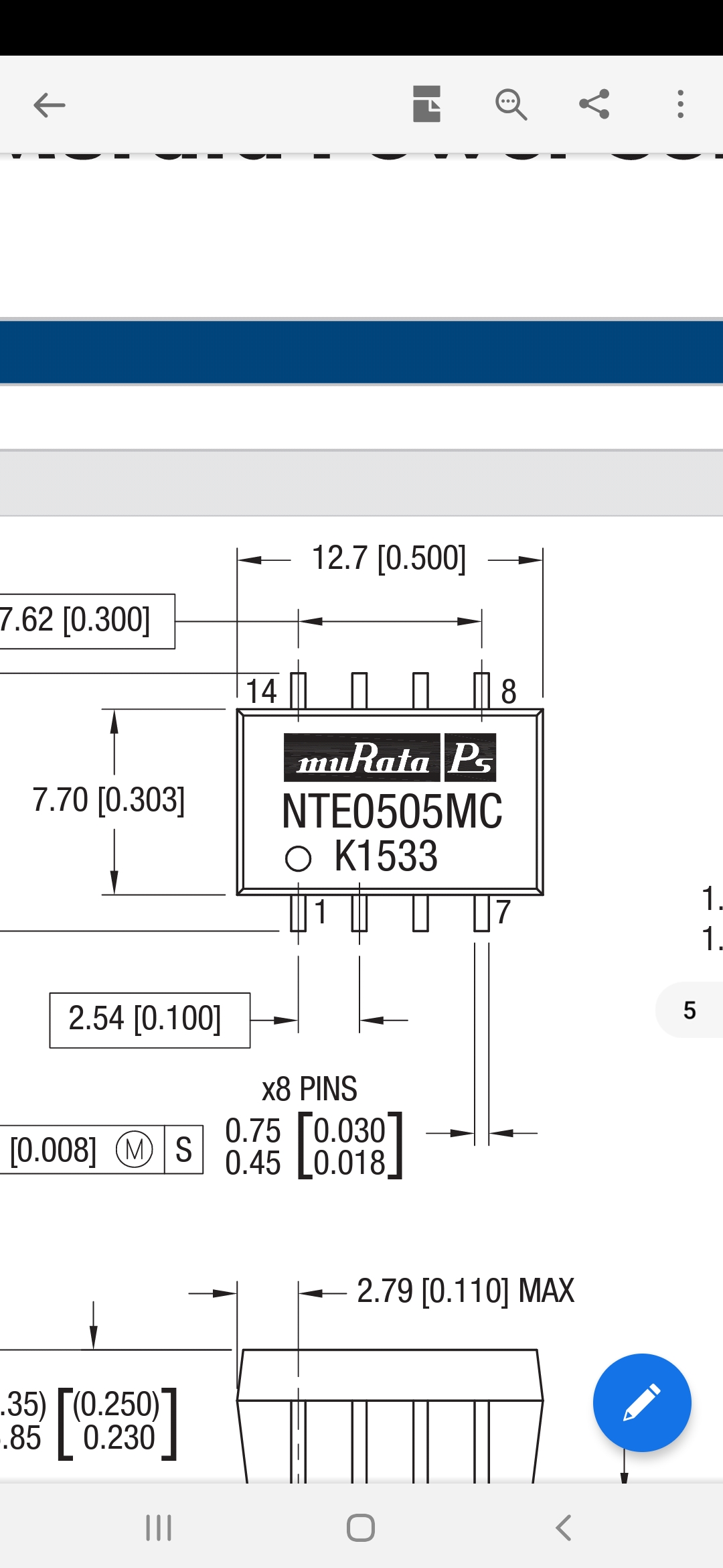

Could you show the modification you are talking about (nte)?
For Vitalica output transistors, it looks like copper shims but it is just thermal pads. The best pads I have found so far, are the alumina ceramic pads, the thin ones (0.63").

Cut pin 1 and 3 Vin
Cut 7 and 8 v out
Previously I was lazy didn't cut 7 and 8.. The upgrade failed. Still same problem.
post #1496 by aboe shows location of nte 0505mc and the jumper j13 I think for external input make sure right direction
Feed your favorite isolated supply since nte0505 mc is actually an isolated DC to DC. I am using Lt1963 on a separate transformer unused winding . Different caps etc change the sound in a huge way as well.
With Same winding.. Effect of sound improvement is small.
A small receiver cap soldered on pin under the jumper also helps.. To help transient. I tried there is a diff.. 47 ish uf for me.

Also, I was lazy to cut 3-7-8
Last night I did it and it is an improvement in sound!
